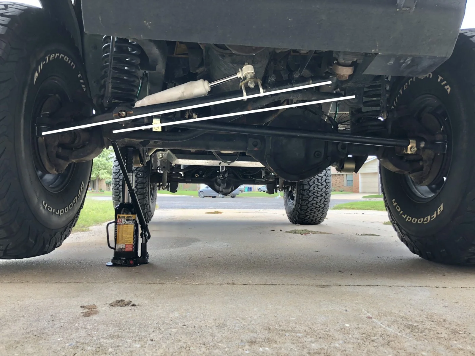

After searching online for a definitive answer on dropped pitman arms with the Currie Currectlync I’m more confused than when I started. I know that the track bar and drag link should be parallel to get rid of bumpsteer but with my current set up I don’t get any bumpsteer at all. Unfortunately the PO of my jeep welded a dropped track bar mount on the frame side so I’m not really sure what to do to get the drag link and track bar parallel. Any help or insight would be great.

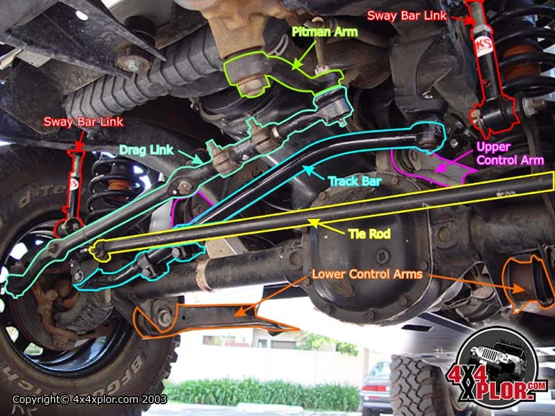

Okay, that’s what I thought. I’m not sure if my track bar is dropped or just relocated forward and changed to a different type of end. I think the stock mount is still on the frame with a relocation brack mounted to it and then welded to the frame. Is it possible to send a picture of the stock track bar mount?
Your track bar has a drop bracket on it. It should look like this:
Get rid of that drop bracket on the track bar, keep the stock Pitman arm, and you'll be good to go.
The track bars that come with a drop bracket are made for use with a drop pitman arm. However, that's not the right way to do it. The right way to do it would be to simply have a track bar that mounts to the stock location (without a drop bracket) and a stock pitman arm.

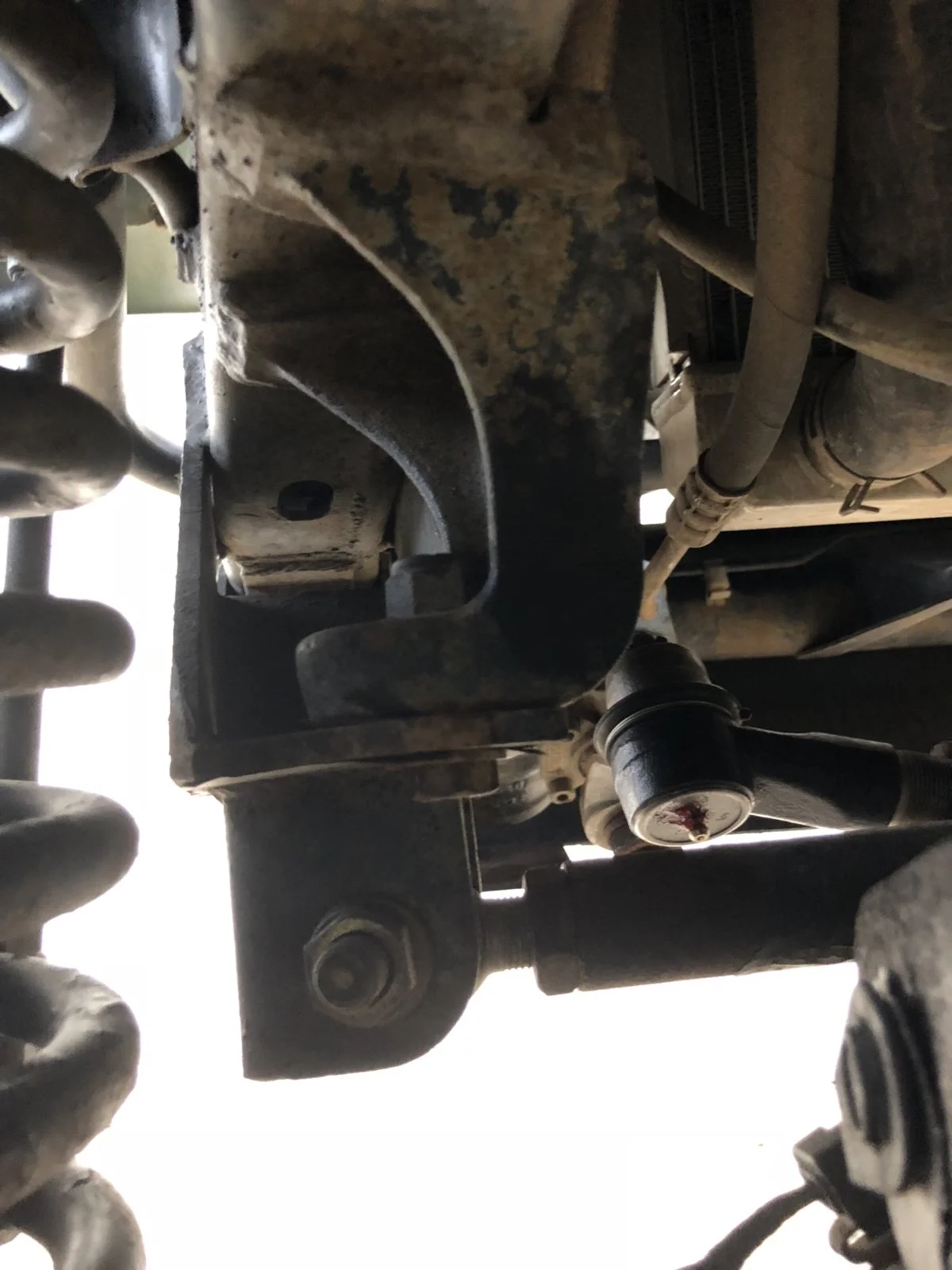

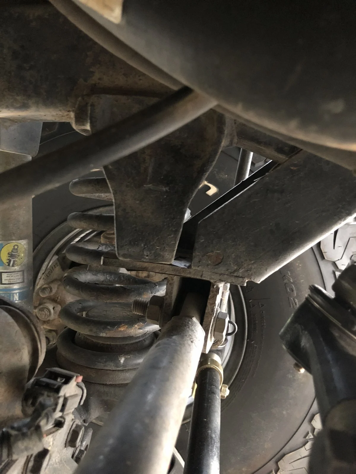

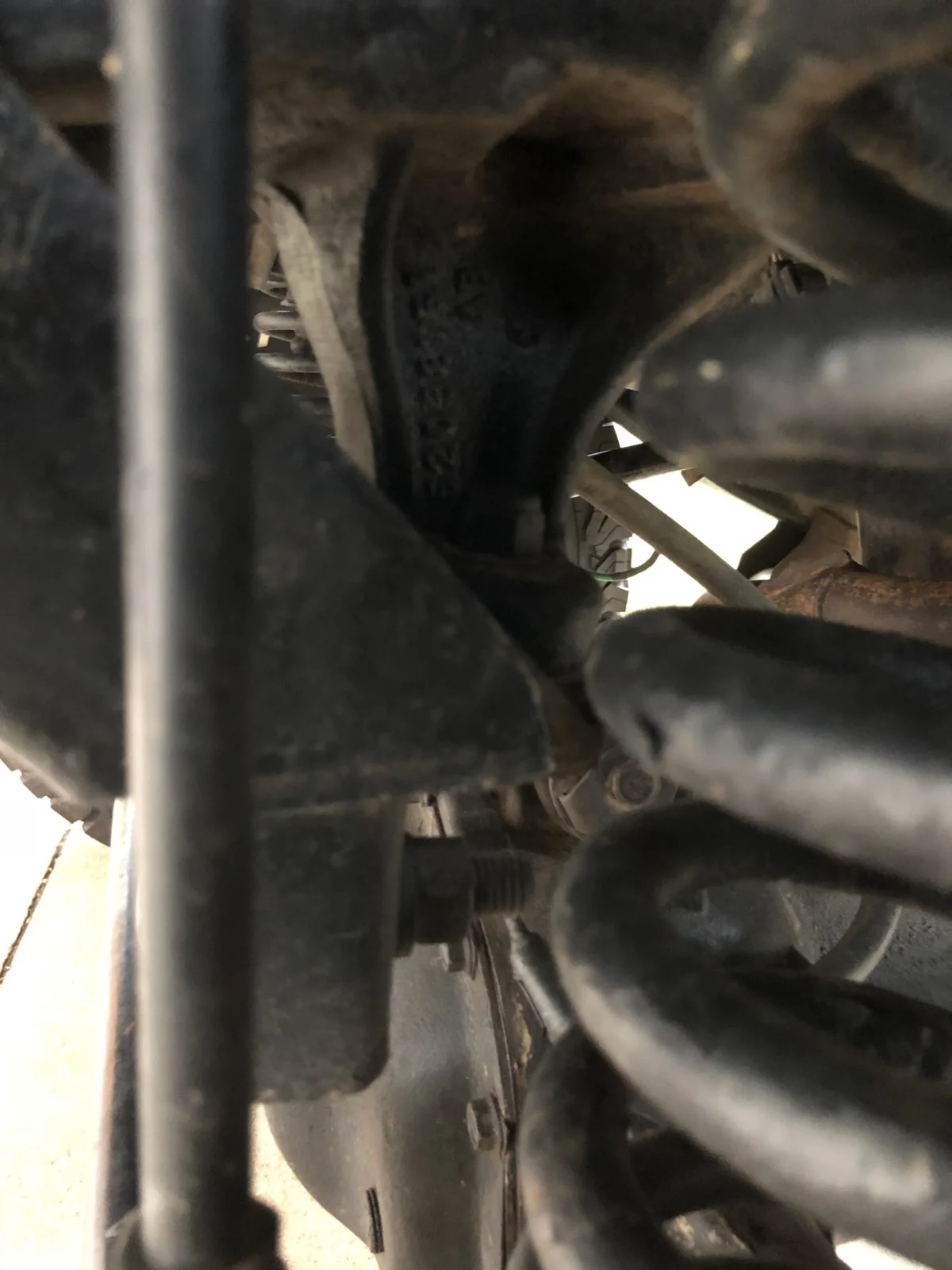

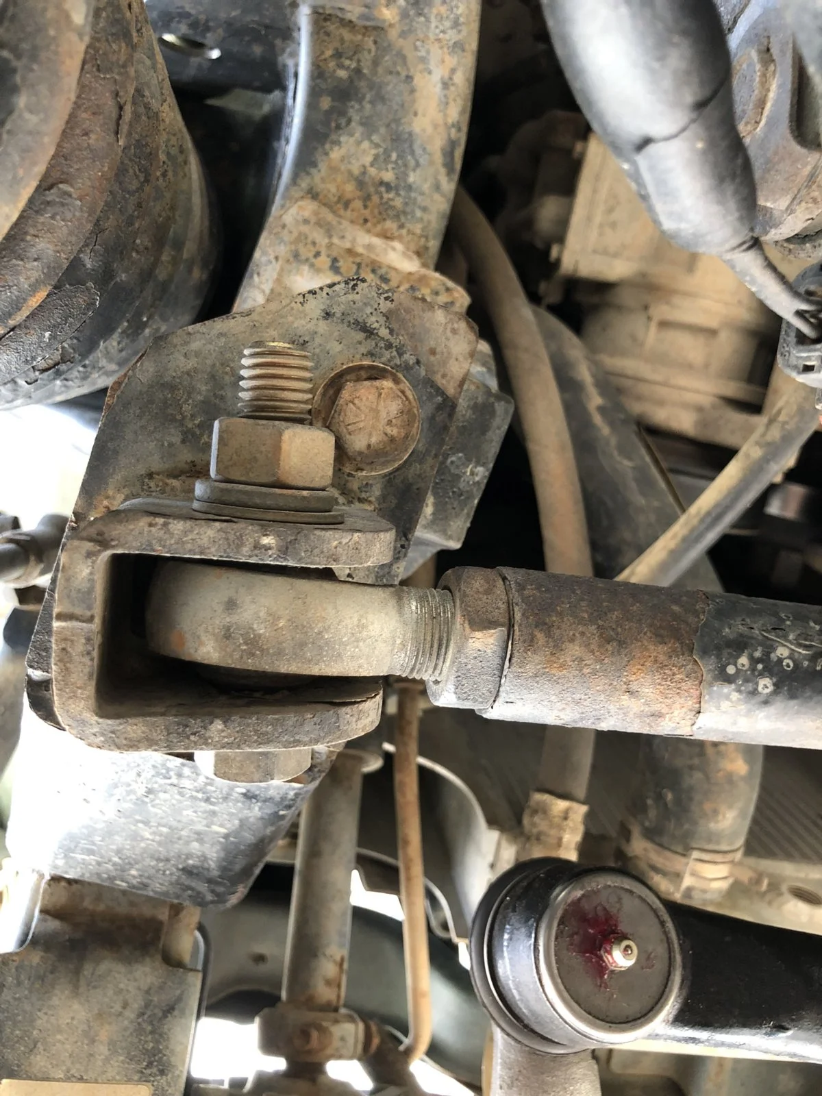

Take a side view of your frame side track bar mount. It looks like it is still near the "factory" position, but is now a double shear with the bolt running horizontally instead of vertically. If anything, your mount may be a bit higher than stock.
To me it looks to be a few inches forward but pretty close to the same height due to the 90 degree change in mounting style.
X2, show us a photo taken from the driver's side of the trackbar's frame mount. It's hard to tell for sure but it doesn't appear to position the driver's side of the track bar any lower than the OE mount did.
I posted these two above, I can post a better picture tomorrow morning after I take a wheel off.
That height looks normal to me, as in it doesn't look dropped. Based on what I can see I'd definitely be running strictly the factory Pitman arm, not a dropped Pitman arm.
Yep, that track bar height is normal. Looks like it’s just double shear.
You can run that track bar with the stock pitman arm and you’ll be fine.
