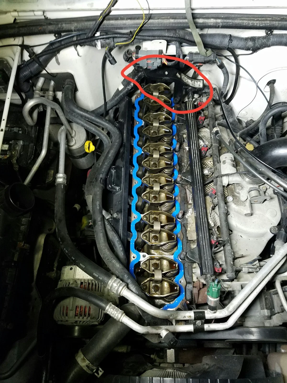

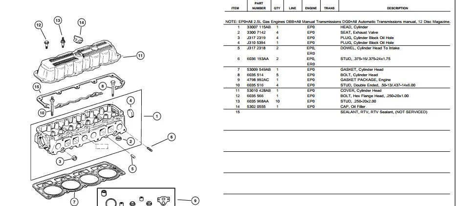

Attached is a pdf of 2 pages out of the TJ shop manual for a 2002 SE. It appears there is a cured gasket in the valve cover that they don't want you to remove and another gasket on the engine that you can replace. Do any of you smart folks out there know what they mean? Thank you
A cured gasket is nothing more than a sealant usually laid down by a robot that is cured in place by a heat source. Although I have changed several of those gaskets I have never seen that and I would not concern yourself about it. Just get both surfaces clean and use a high quality gasket like Fel Pro.
Thank you. I have the Fel Pro.
In this case, the factory is referring to RTV sealant.
If you're going to touch up your old factory goop, use an oil-resistant RTV. I might be tempted to strip it off and install a Felpro if it shows any sign of age. The problem you run into is cleaning the aluminum cover without using steel scrapers or anything abrasive. There is a silicone solvent available at some hardware stores that might be an option. Here's a video that may help

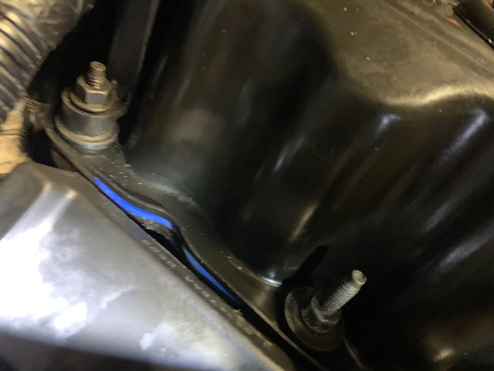

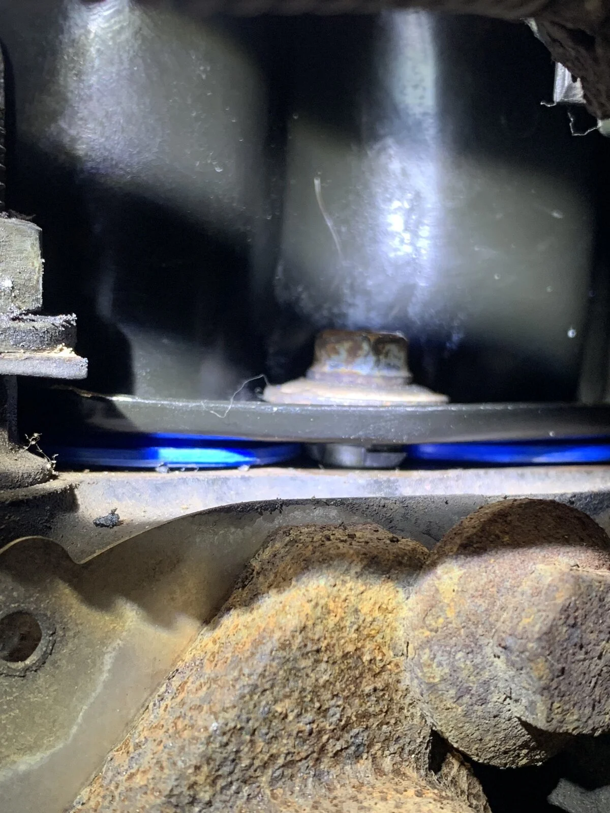

Just did the valve cover gasket today with a Felpro gasket. Finished putting everything back together and I noticed a slight gap. Pretty confident I seated it down properly and torqued to 85 in ft lbs. Does the cover normally sit this high with the Felpro? I did notice the ridge on the gasket was pretty thick.

It looks as though the rocker cover is sitting down on the spacers that are built into the gasket so you should be fine there. The spacers are there to keep the gasket from being squeezed out when torqued down.
