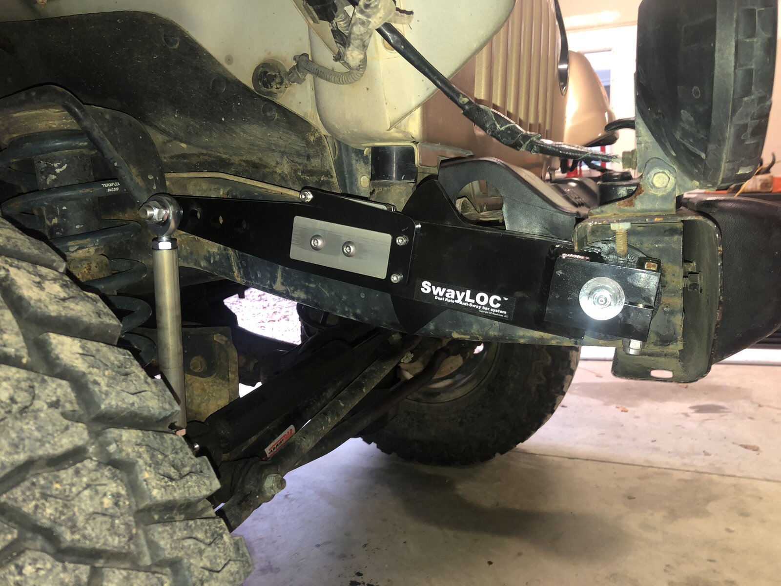

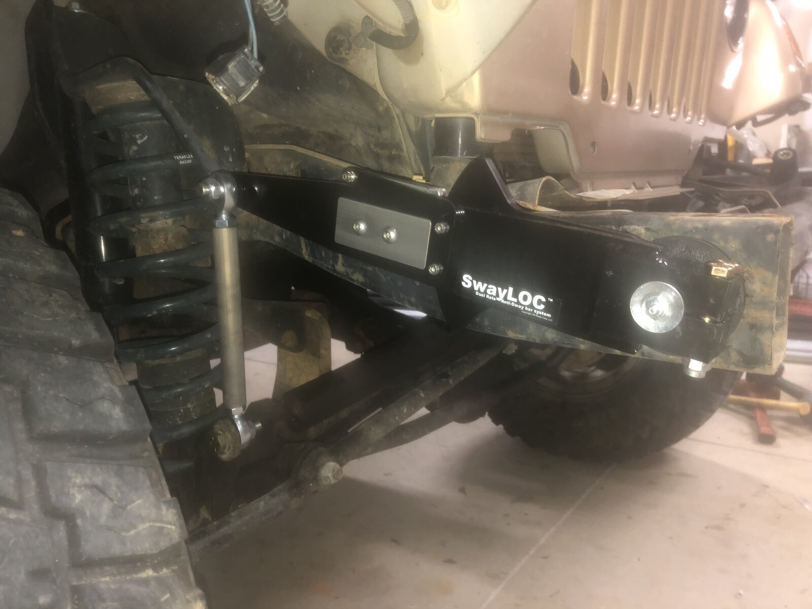

Alright well anyway.... it's a sway lok, and I need to know how long I need to make the links??????
they send 3 different sections each to combine as needed, and I need to know what combination to combine them?

Long enough so they don't invert at full droop, short enough that they don't go into the wheel well at full stuff. Getting them close to level at ride height is the goal, but only if they don't invert at full droop - that's much more important. Time to do a little flex testing.
