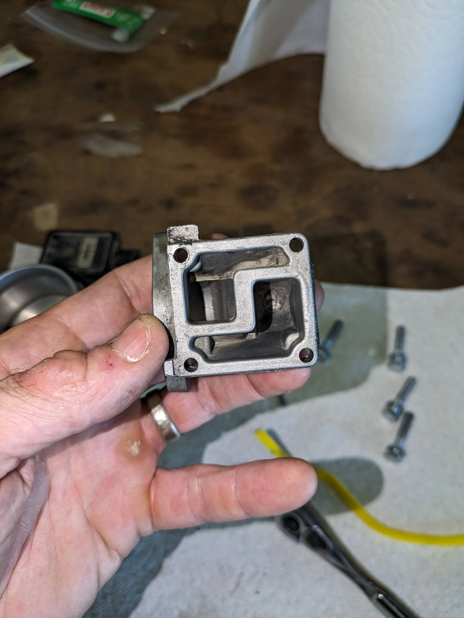

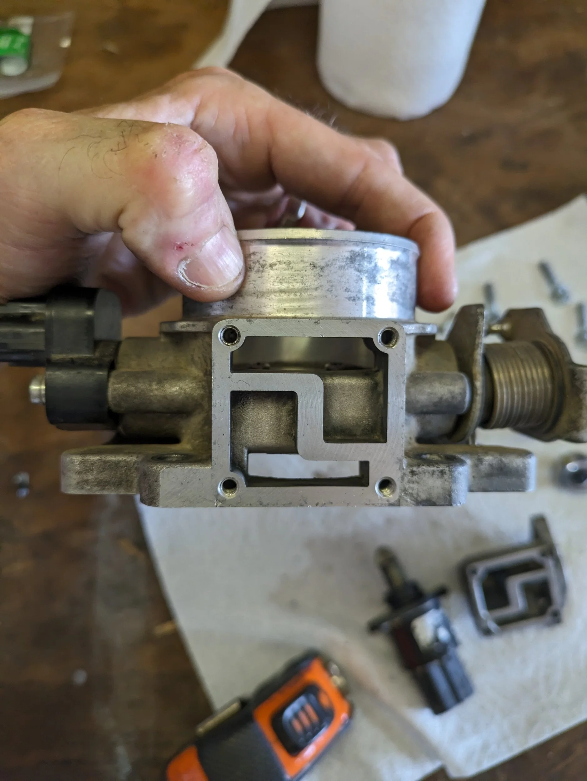

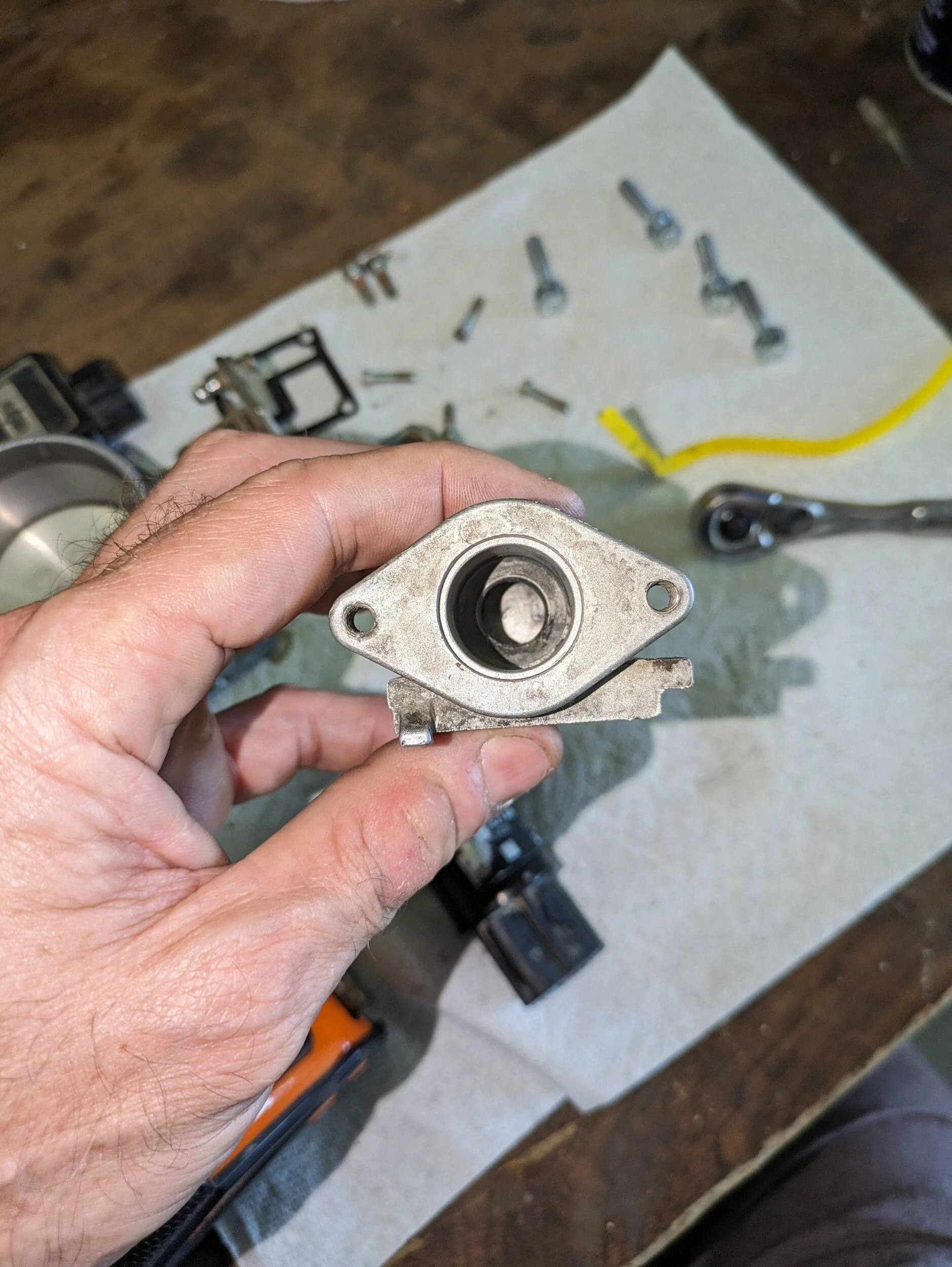

That brings me to today. I'm suspicious of my IAC so I pulled the throttle body off the Jeep and removed the IAC. I recleaned the IAC port and the IAC housing.

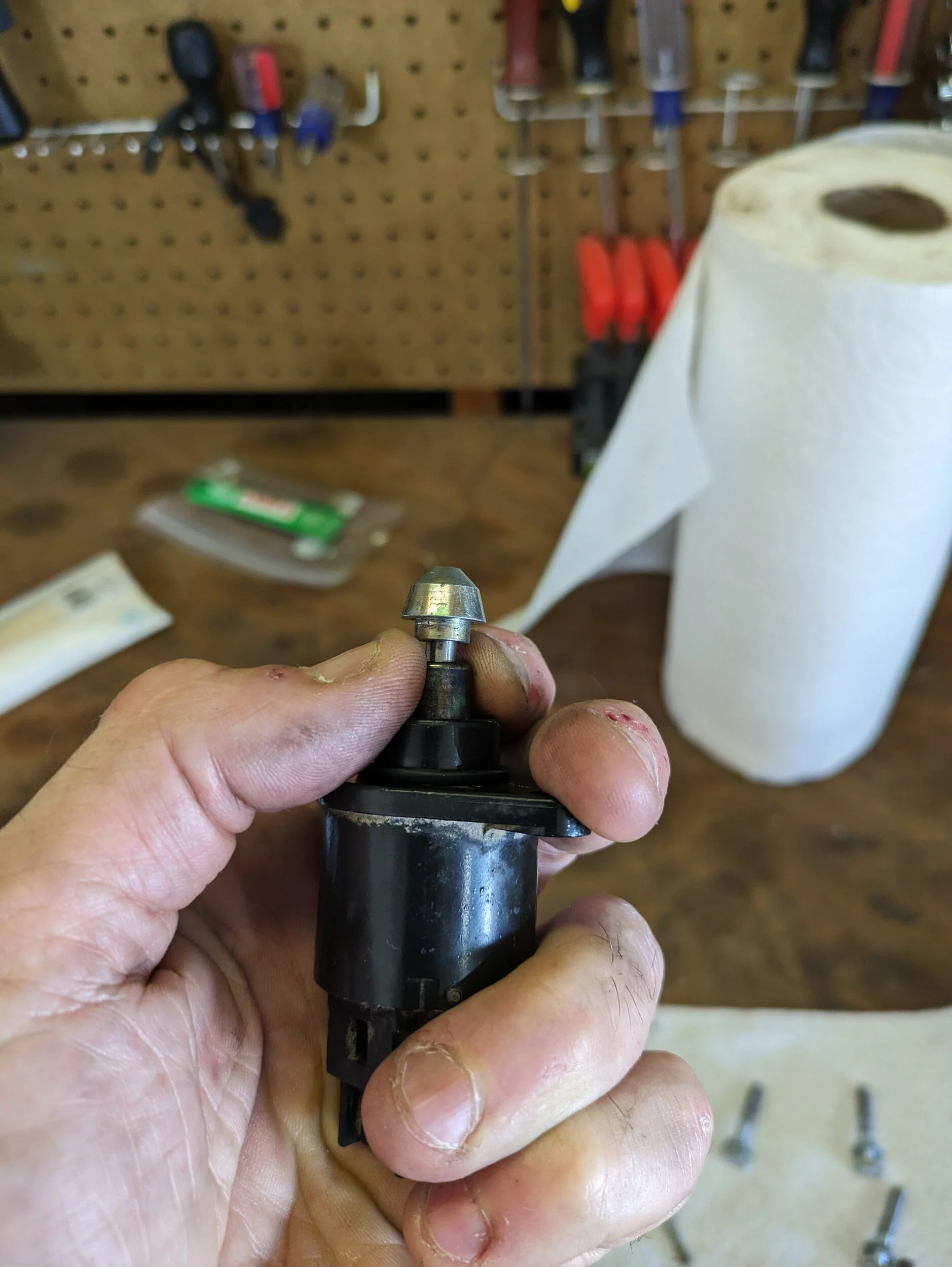

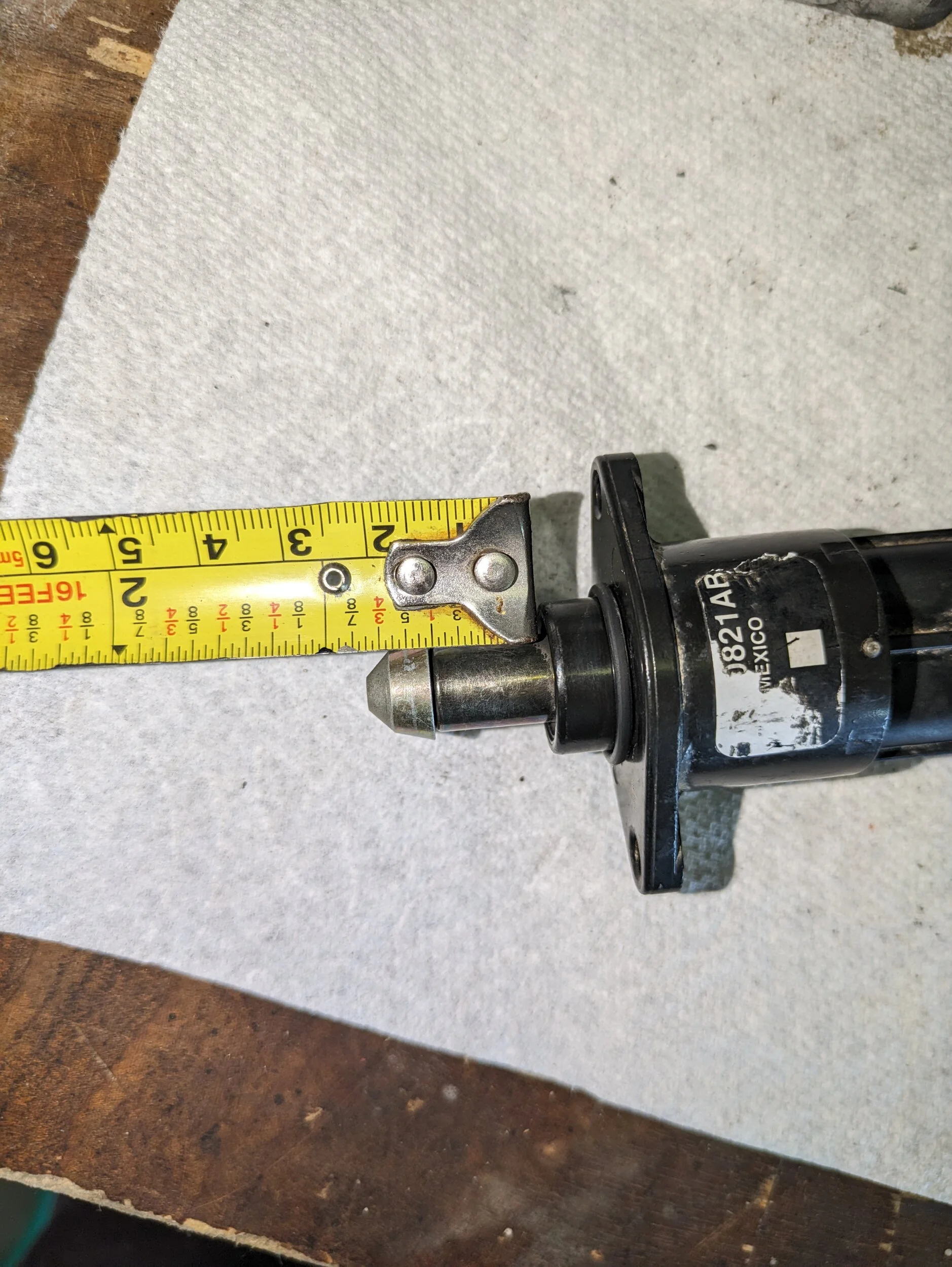

One question I have though is whether I should be able to adjust the length of the IAC tip in and out because I can't seem to adjust mine at all. I've seen videos where you could pull back the collar and rotate the tip in and out to shorten or lengthen it. When I try this on mine I can't get it to spin at all? I read that the tip should be out about 1⅛" and mine is about ¾" so I tried to adjust it and ran into this problem.
Does this seem faulty that I can't get it to adjust at all?
If you can't move it at all i think that's an issue. But try this: put it all back together but leave the IAC itself out of the housing but still plugged in. Have a buddy start the car. You should see the plunger extend as the computer will think it's getting too much air. That will tell you if it's seized or whatever.

My suspicion is that the small gasket for the IAC was positioned the wrong way,I noticed when I was cleaning everything that there was an area on the gasket that was a little dirty where it is supposed to be covering the housing surface I circled below. It is not easy to tell when the gasket is positioned backwards unless you really look closely because all of the screw holes still line up. The dust I found on that one area of the gasket makes me think it wasn't on correctly.
