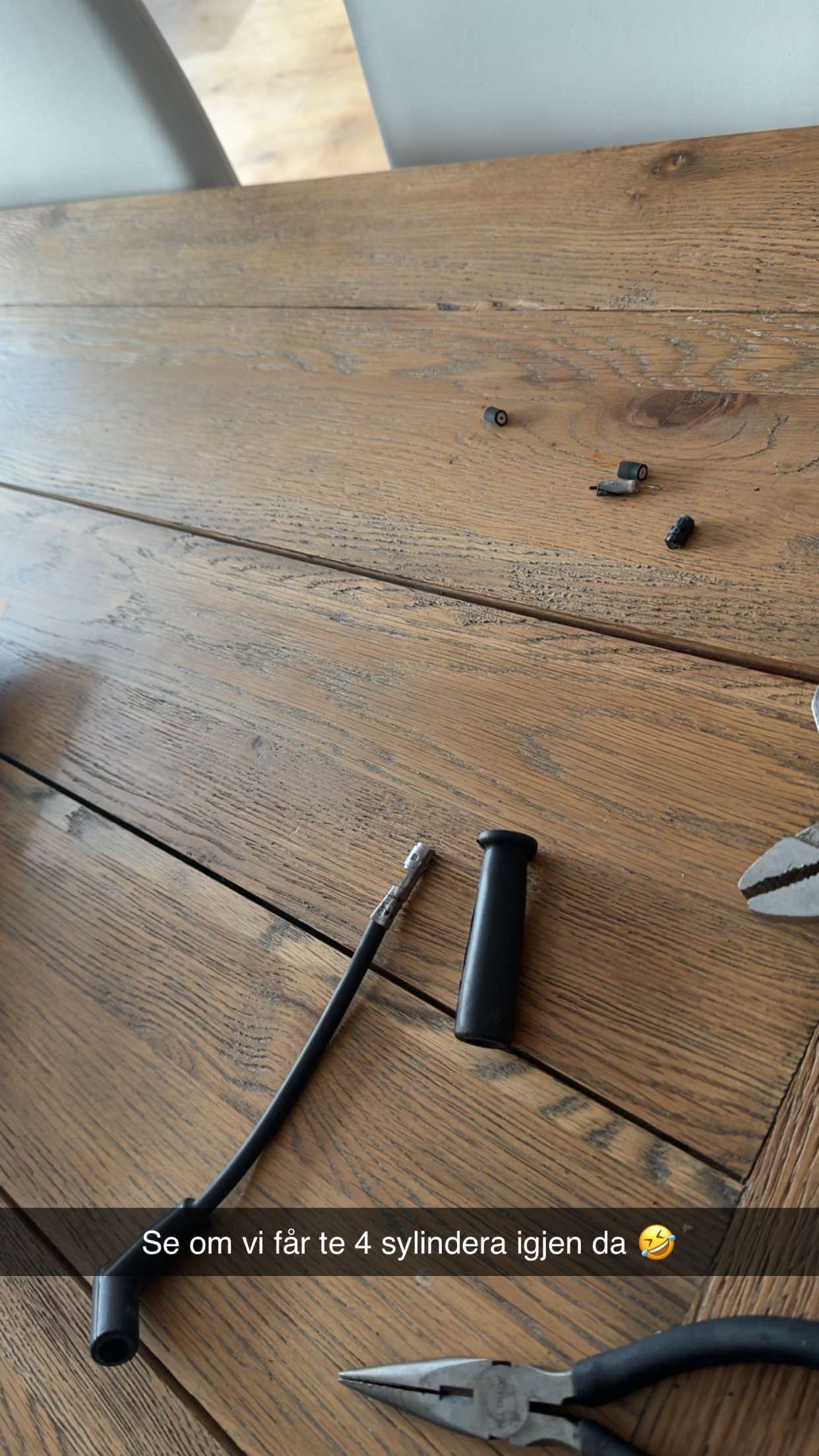

well, while looking around i heard clickclickclick from the plugs. So started checking them and re torquing thinking i had loose plugs. Turned out one of the plug wires had broke off. Ofc the one closest to the firewall…
So one job became another.
Got the stethoscope out, original sound is not coming from pulleys/belt area. Checked top intake bolts yesterday, going for the lower today
