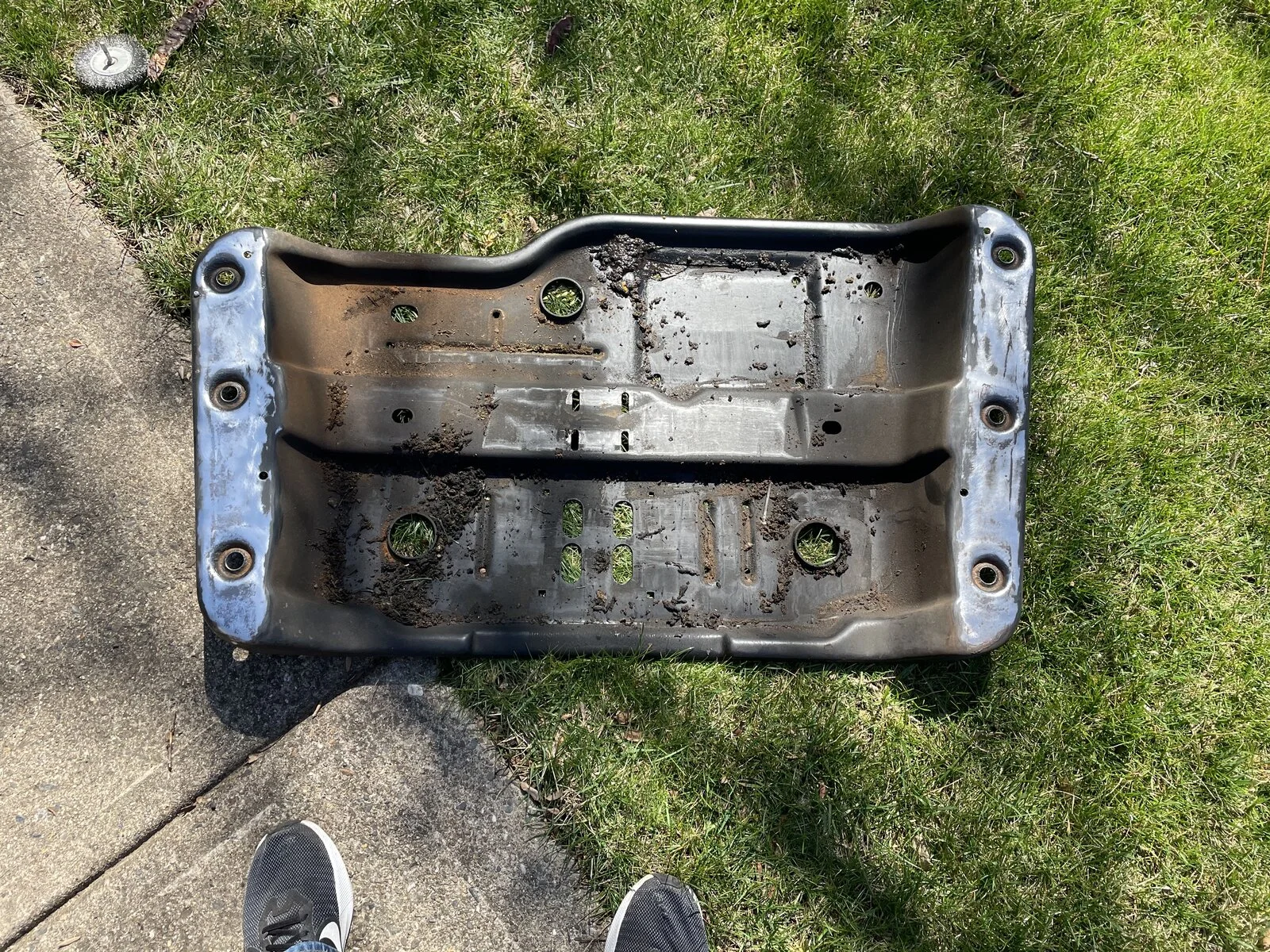

I am posting this as a warning and heads up about skid plate rust. I have a 2001 TJ that lived it’s life in South Carolina. I did a heavy inspection and the frame is rust free on the outside and inside, checked with a borescope. When I bought it I asked what things I should do and the forum gave me a great maintenance list and one member recommended pulling the skid plate, cleaning it and painting it before reinstalling with anti seize on the bolts. That was this weekend’s project.

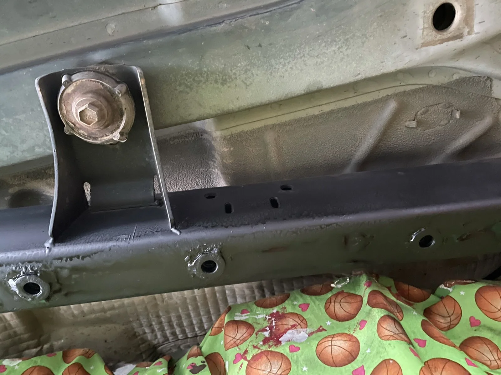

The warning comes as I found a bunch of hidden rust that if I left it would have probably led to rusted and locked bolts and needing to replace the nutserts. Plus the rust would have spread on the frame.
Below is what I found and the process I went through to address the rust and reinstall the skid plate. Thanks to forum members for help with the process.

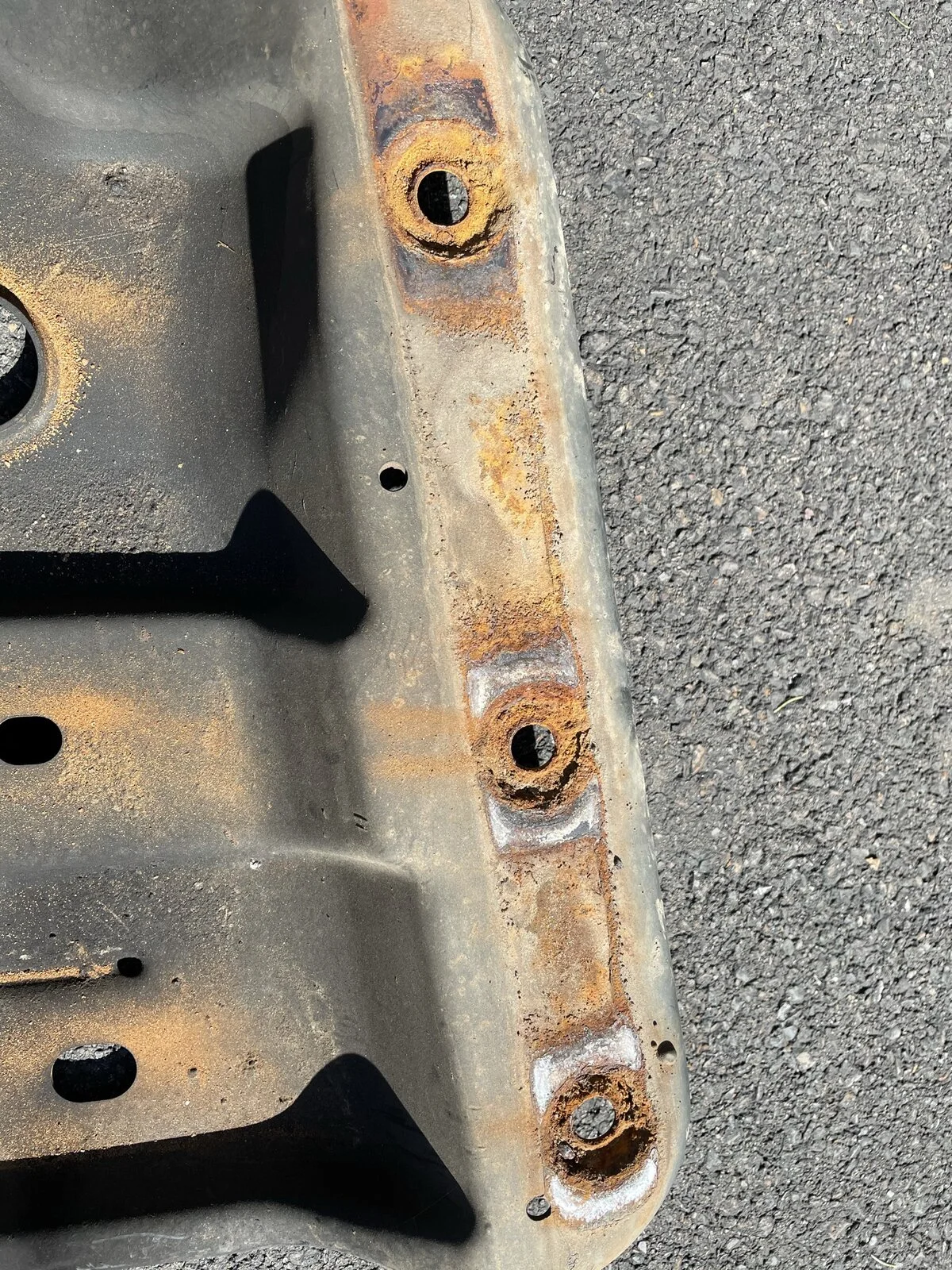

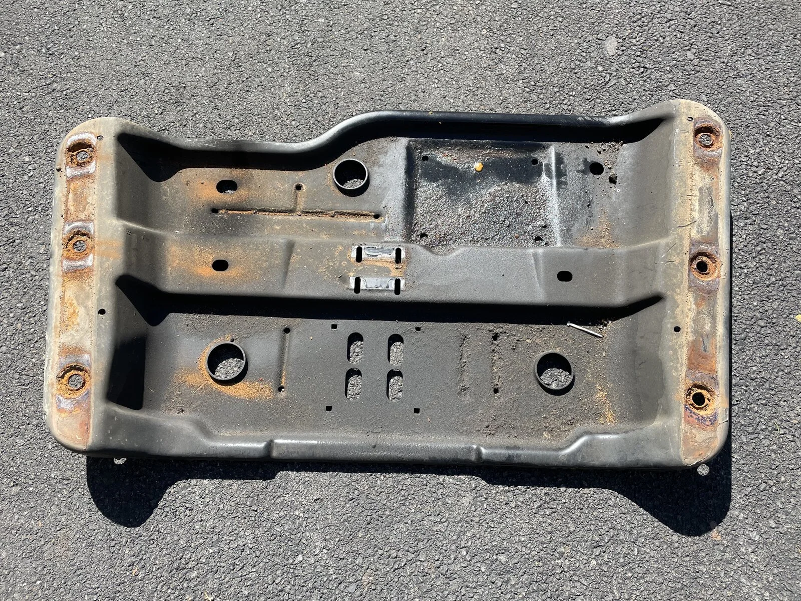

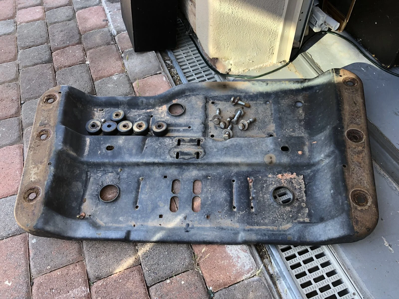

Rust on skid plate:

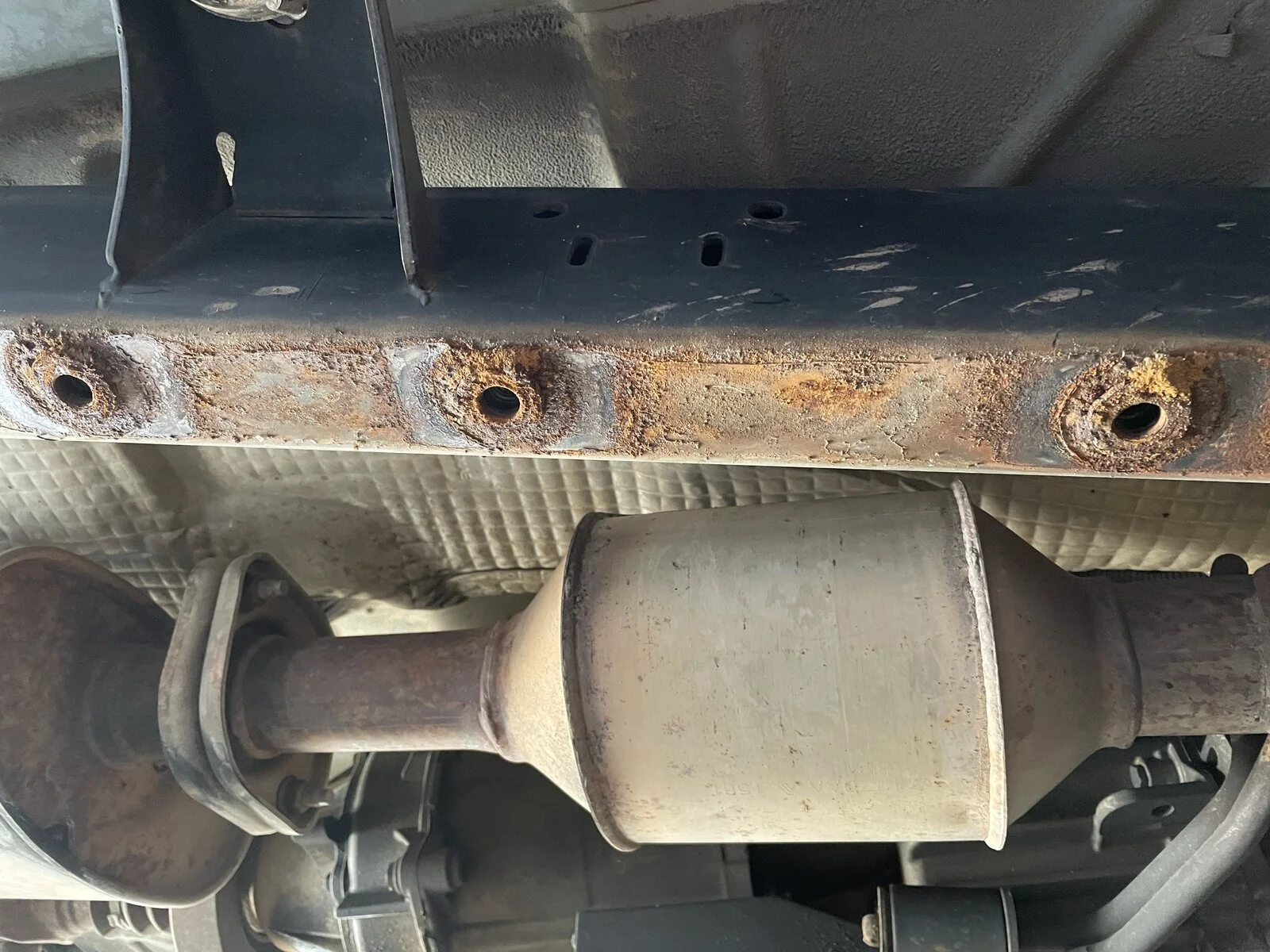

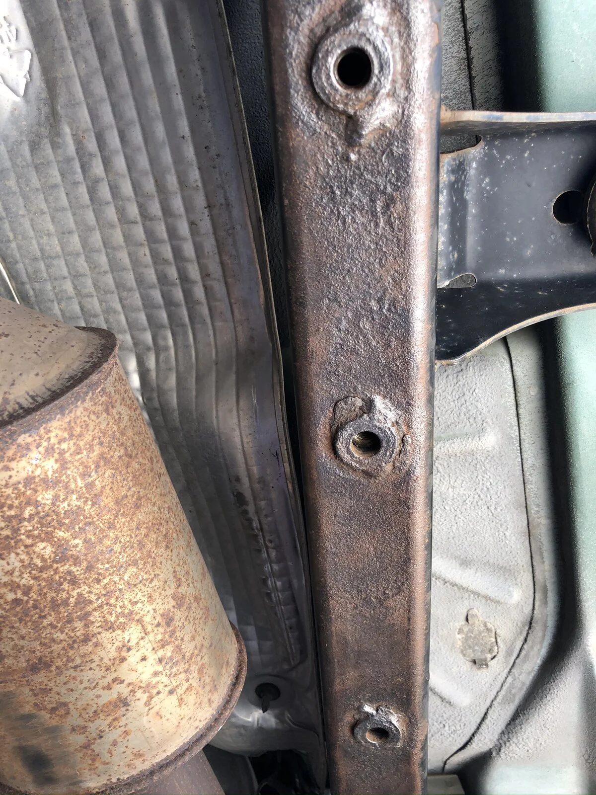

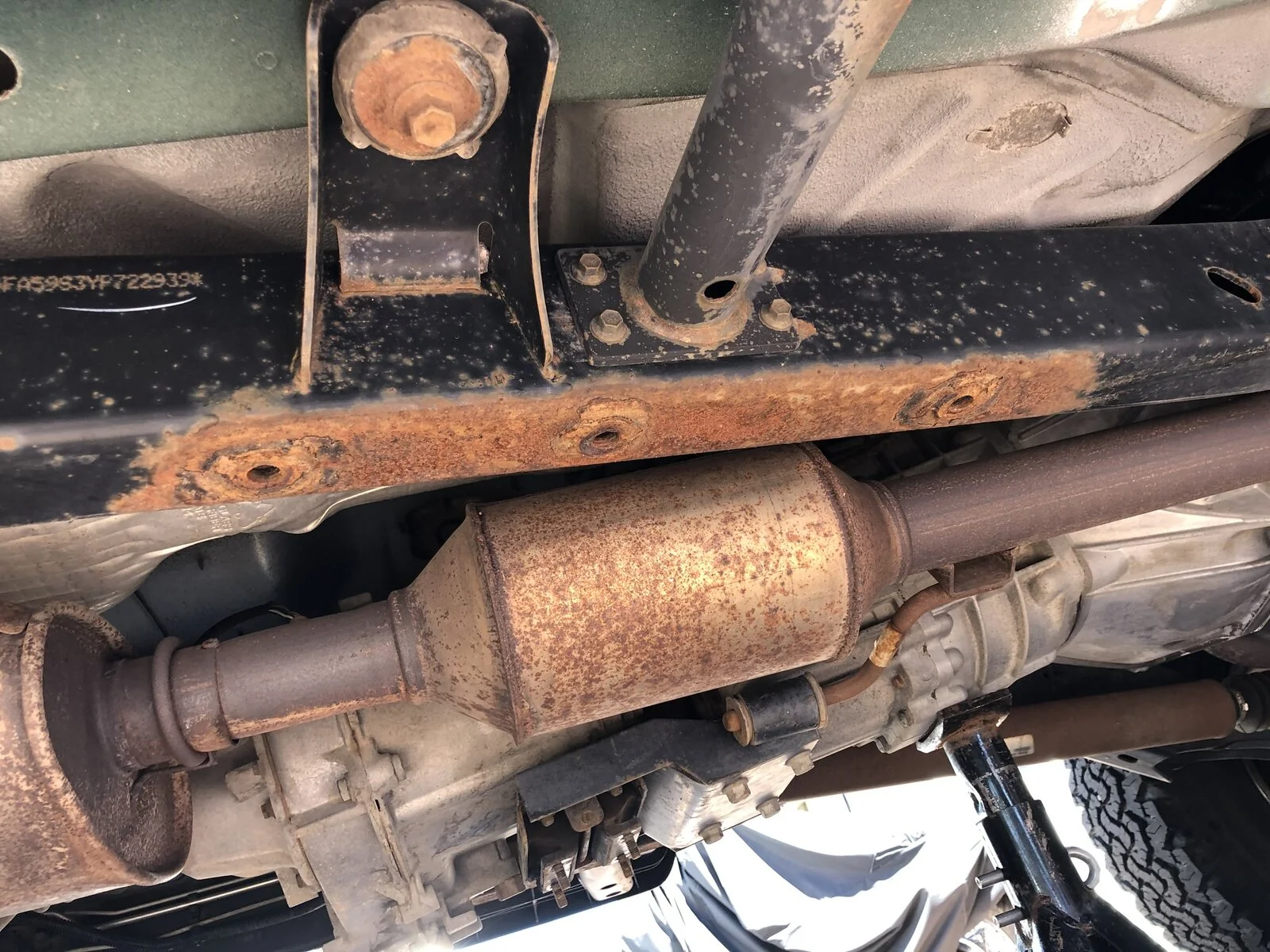

Rust on my “rust free” frame:

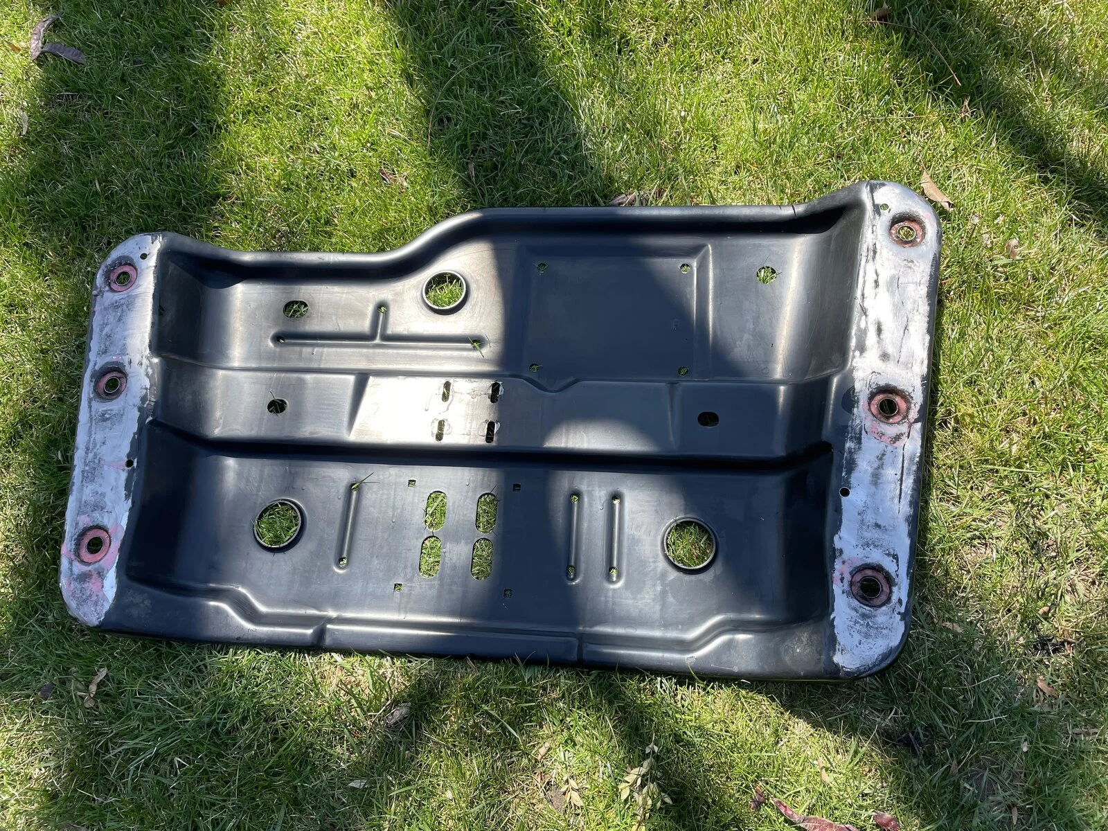

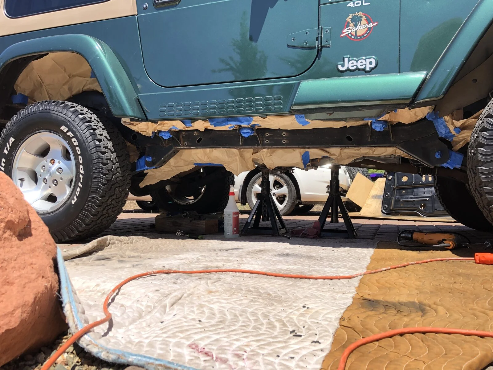

wire wheel and tons of elbow grease cleaning rust area:

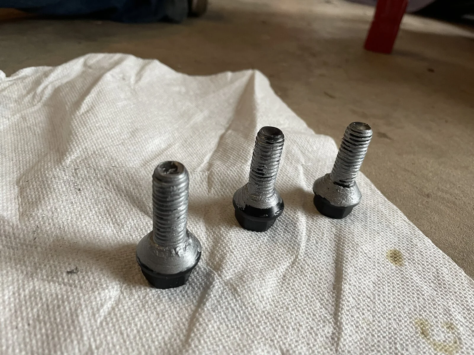

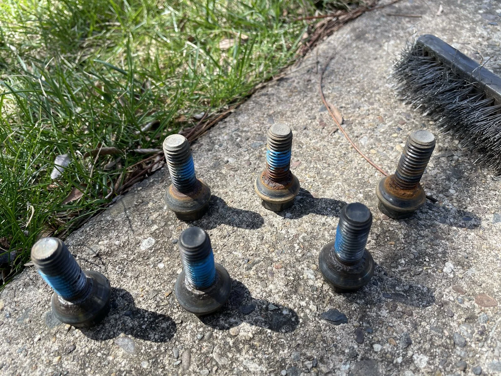

Rusty bolts:
Added chemical rust remover as the areas around the bolt holes would not come rust free

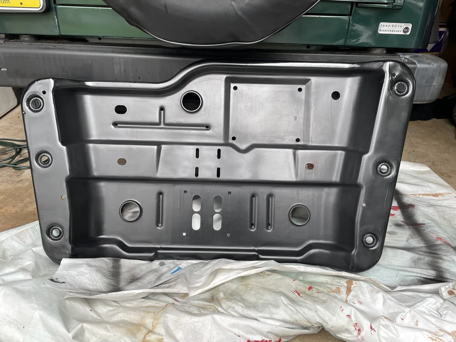

Power washed and dried plate then painted it with Rust Oleum Rust Reformer to prep for paint. I could not get all of the rust off so I used this product
I was concerned about bolt rust so I taped off the threads and painted with rust reformer and then a layer of frame paint
Painted frame with Rust reformer after cleaning, and grinding with wire wheel

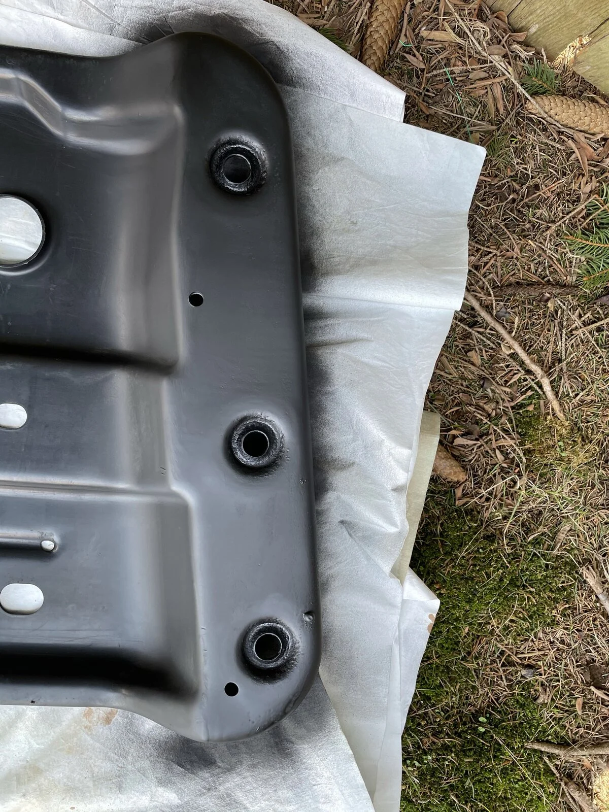

waited 24 hours and then painted everything with frame paint
Added anti seize to nut threads as well as cone area that contacts the plate:

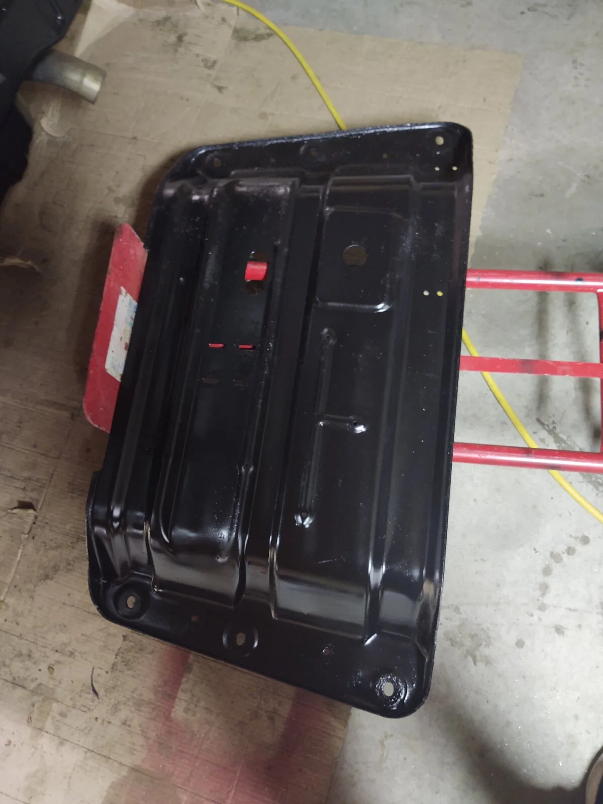

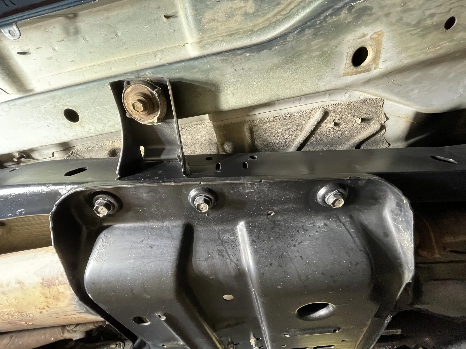

Finished product

I'm glad to see that your rust wasn't too bad and what you've done to correct it looks pretty good. I don't know if you have any winter TJ driving planned or not but even if you don't I still suggest putting some Fluid Film or some other oil based stuff in between the skid plate and frame.
The early TJ skid plates look like the same design as the YJ where my son had some skid plate bolt holes rusted away completely. It also looks like you had far less frame/skid plate rust between the bolts than my 2006 "rust free" TJ had.

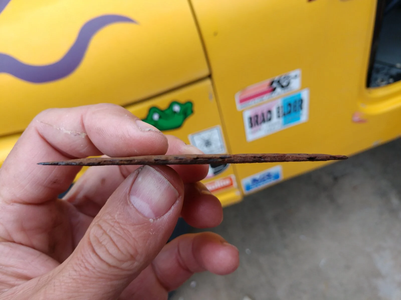

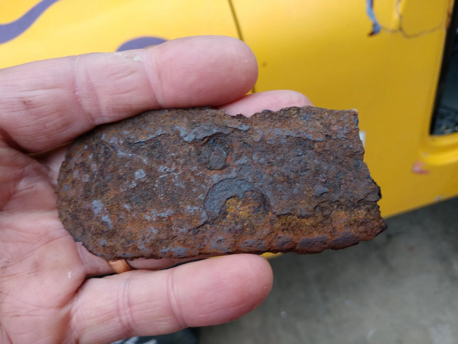

Here's the thickest of the 4 pieces I removed. It's just about 1/16" and I almost had a heart attack.
I felt somewhat better when I noticed that it came from both the frame and skid plate and that both were still strong enough when I beat them with a hammer.
Rust on skid plate:

When I lowered the transfercase skid plate to install the tcase drop; I found a similar situation with mild rust. I wire brushed the affected area on the frame and used Eastwood Rust treatment. I also wire brushed the skidplate and found there was no rust, but treated the surface anyway.
I was surprised how little rust was on the skidplate, cleaned it up then painted it.

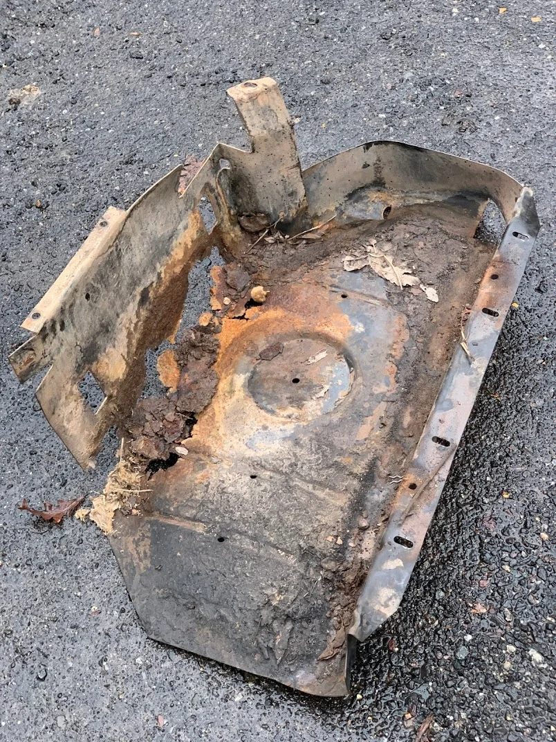

Nice job, unfortunately my TJ hit the point of no return in that area and I had it SafeT capped last year. I basically only had one bolt per side holding the skid up 😳
