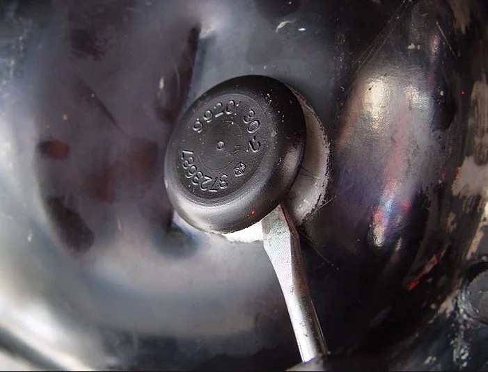

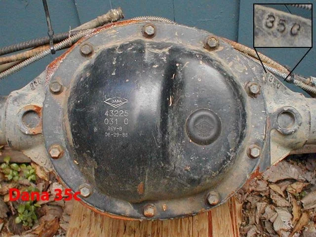

A Dana 35 has a plastic fill hole plug which is removed with a screwdriver...

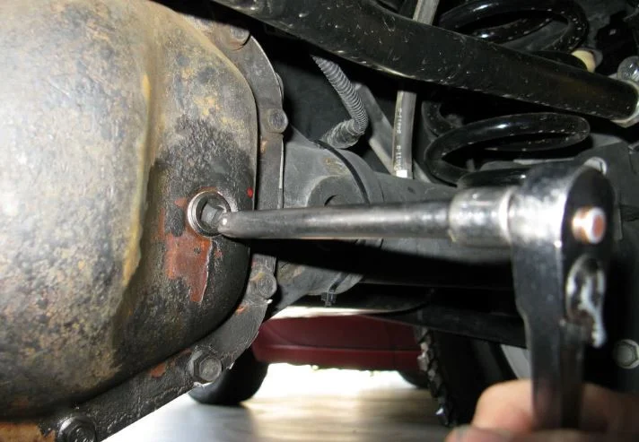

The other style cover typically uses a 3/8" socket extension to remove, like this...

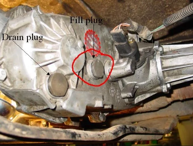

The transfer case fill plug is on the rear of the transfer case... this photo shows a hex head fill plug, others use an allen-wrench type of plug.
