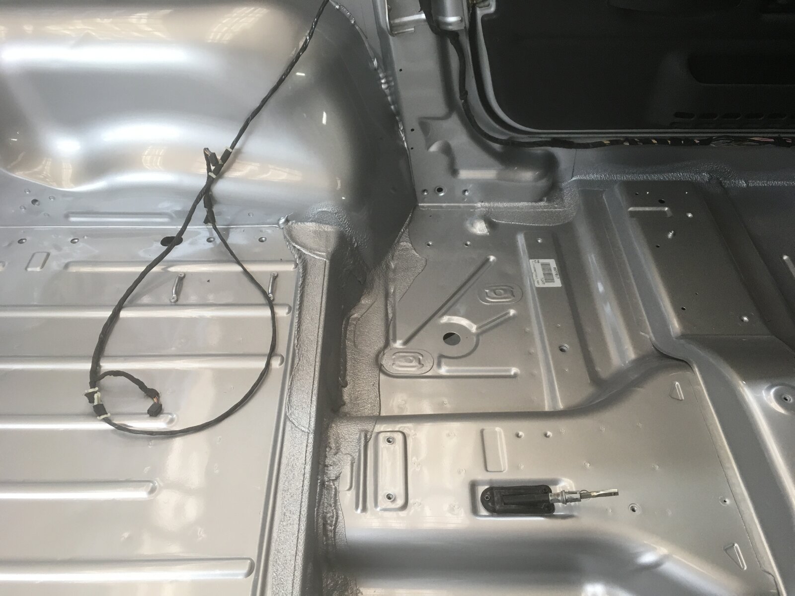

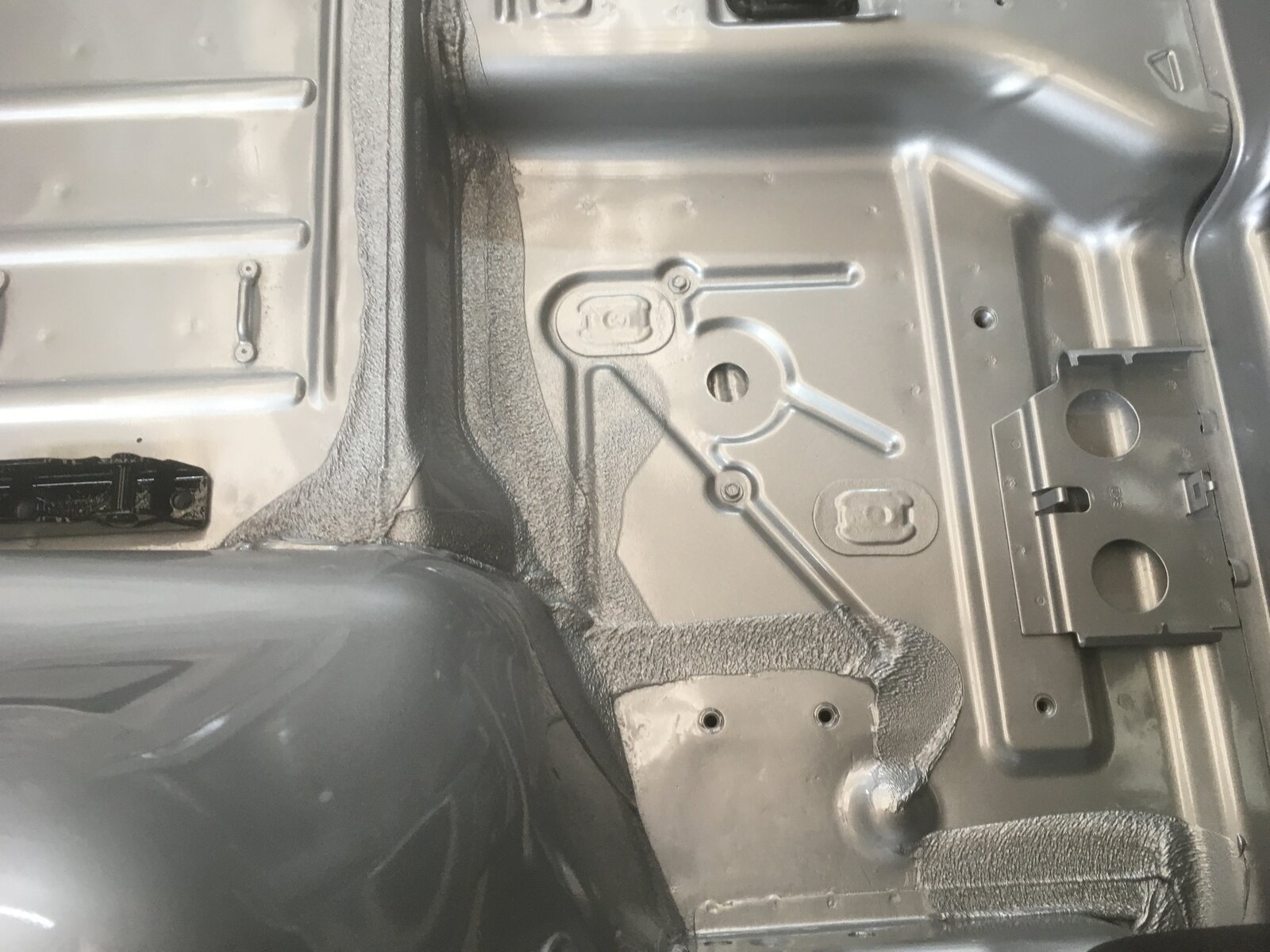

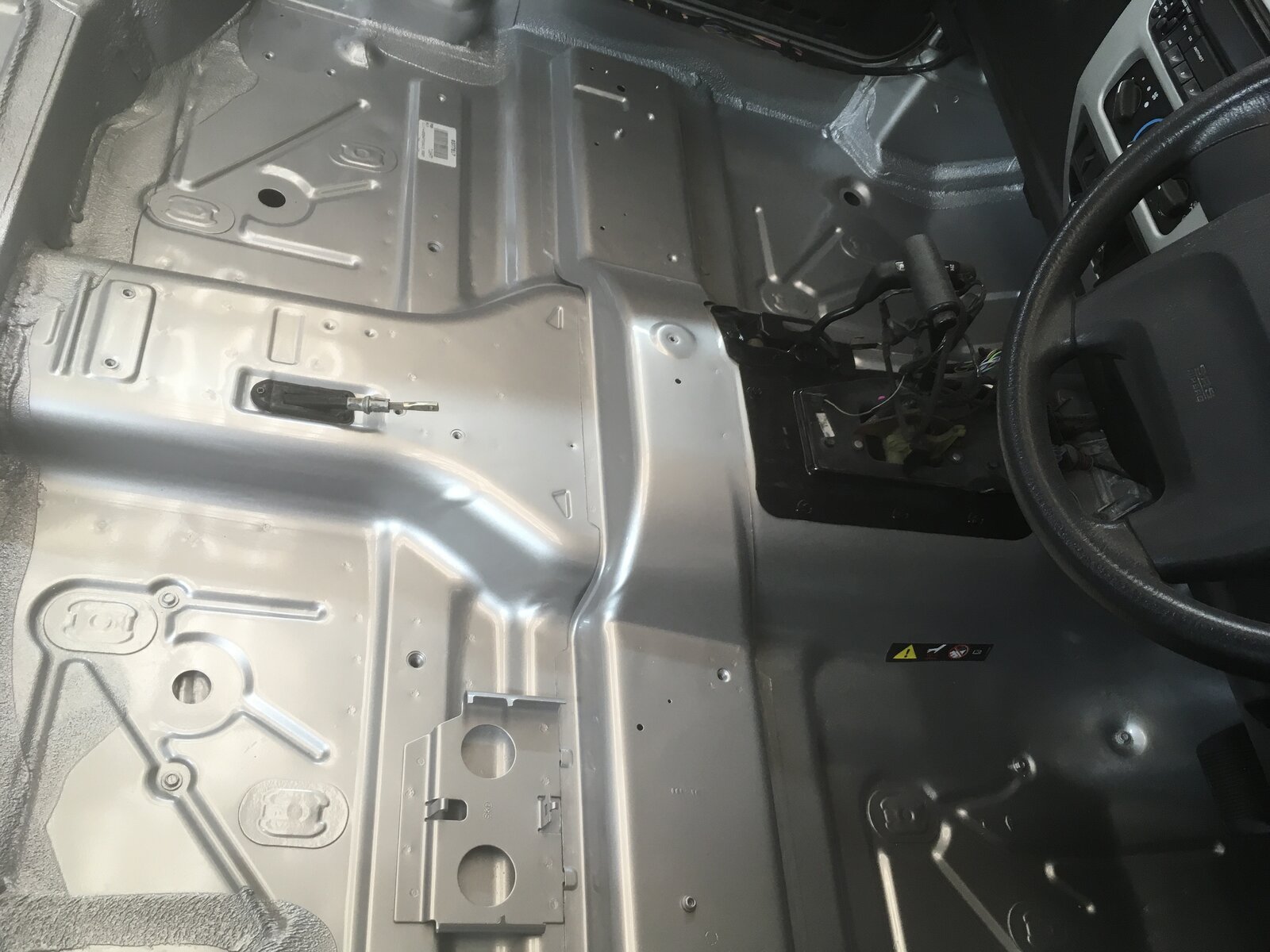

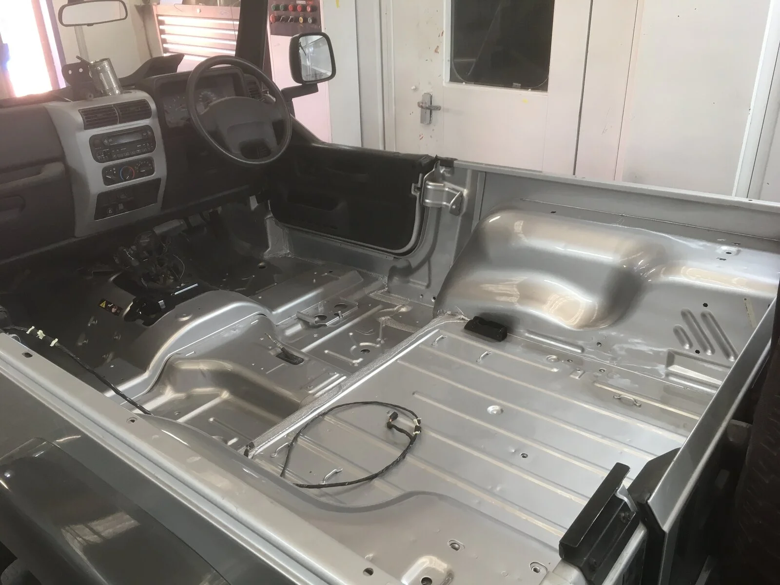

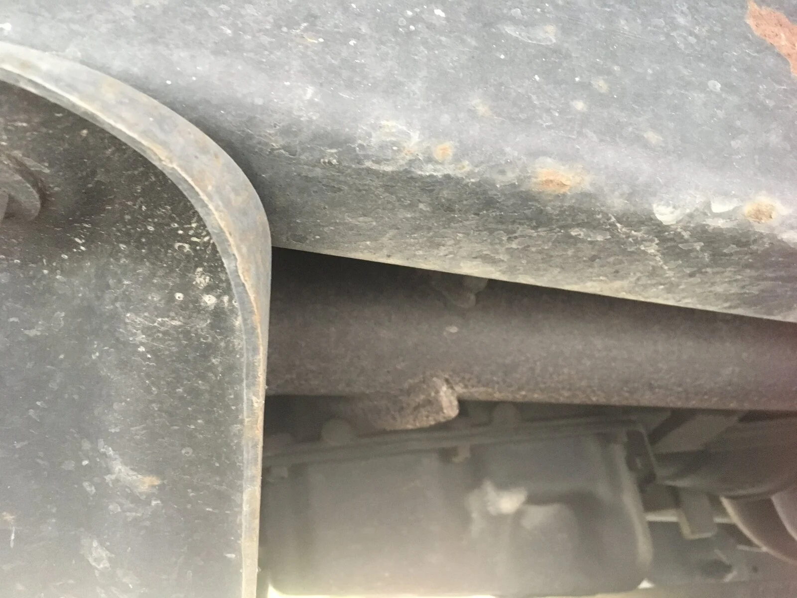

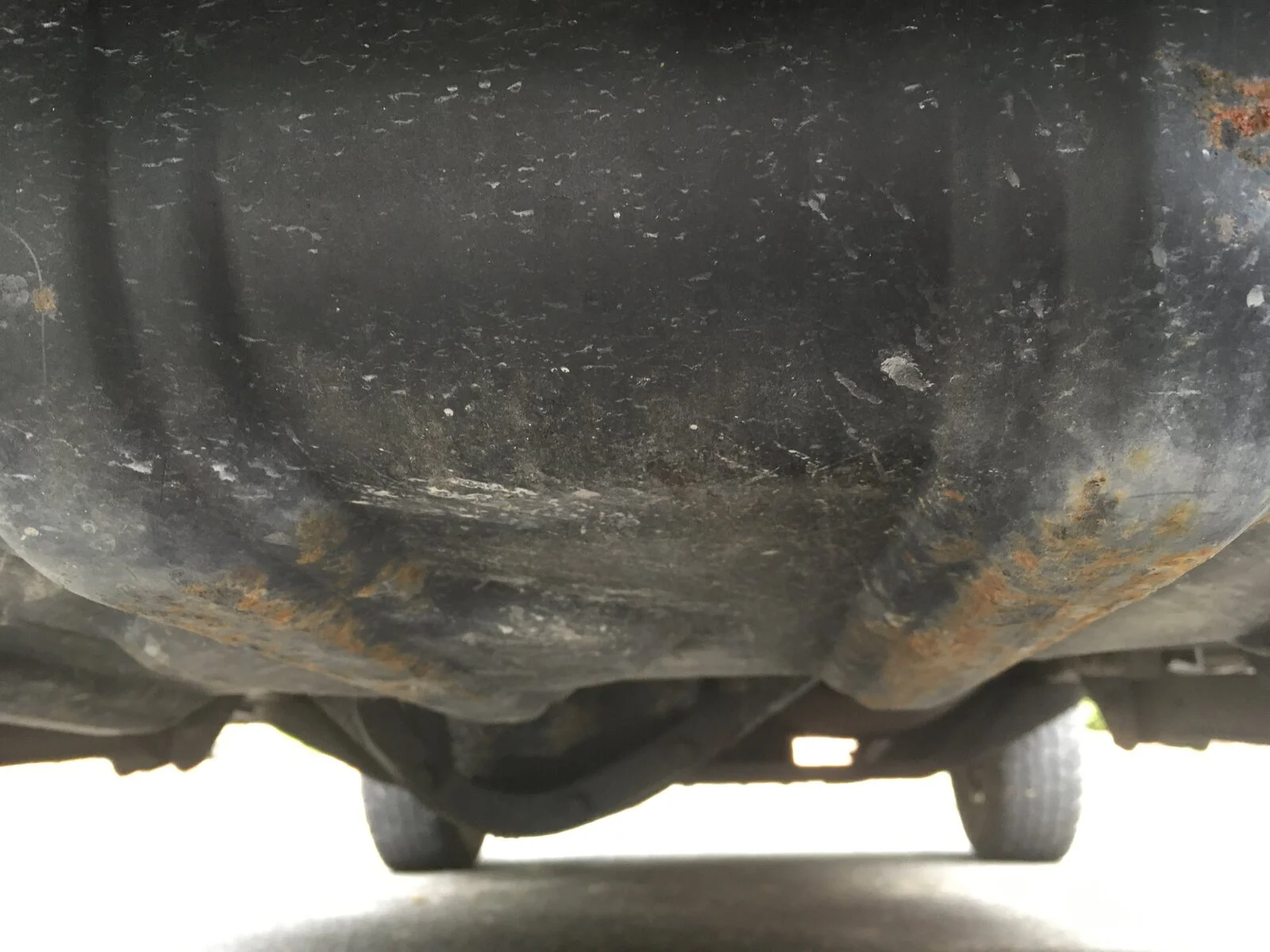

From the factory both roll bar and floor were just primed at the time of bolting together then sealer was applied to the edges prior to the paint, that just nicely helps the cause for rusted bottoms on our TJ over the years. Jeep surely played cheap here šŸ§.
Here is the shiny ā€œRoll Barā€ - Well it was all shiny before as well except floor mounts had some hairline surface rust around edges where sealer was applied at the factory.
Luckily I got here way before the rust could and hopefully it sorted now for good.

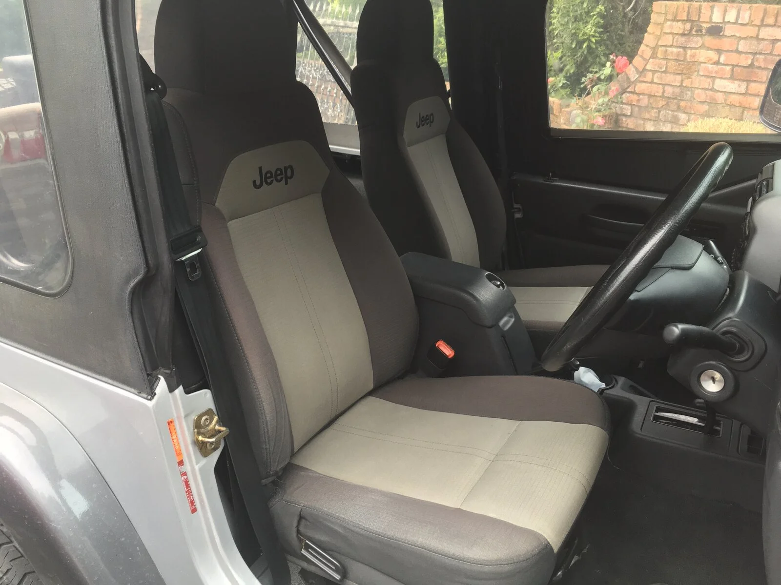

While the seat were out tackled an important safety mod / upgrade. To me this was do it once and do it right, so swapped rear headrests, plastic sleeves / guides and internal metal bracket form a rear seat of a 2013 Jk (2 Door) and grafted on to TJ rear seat frame and result is all OEM fit and finish and most importantly peace of mind šŸ˜Ž. Even stole the pull string bracket from the JK seat for easy pulling seat back šŸ˜€.

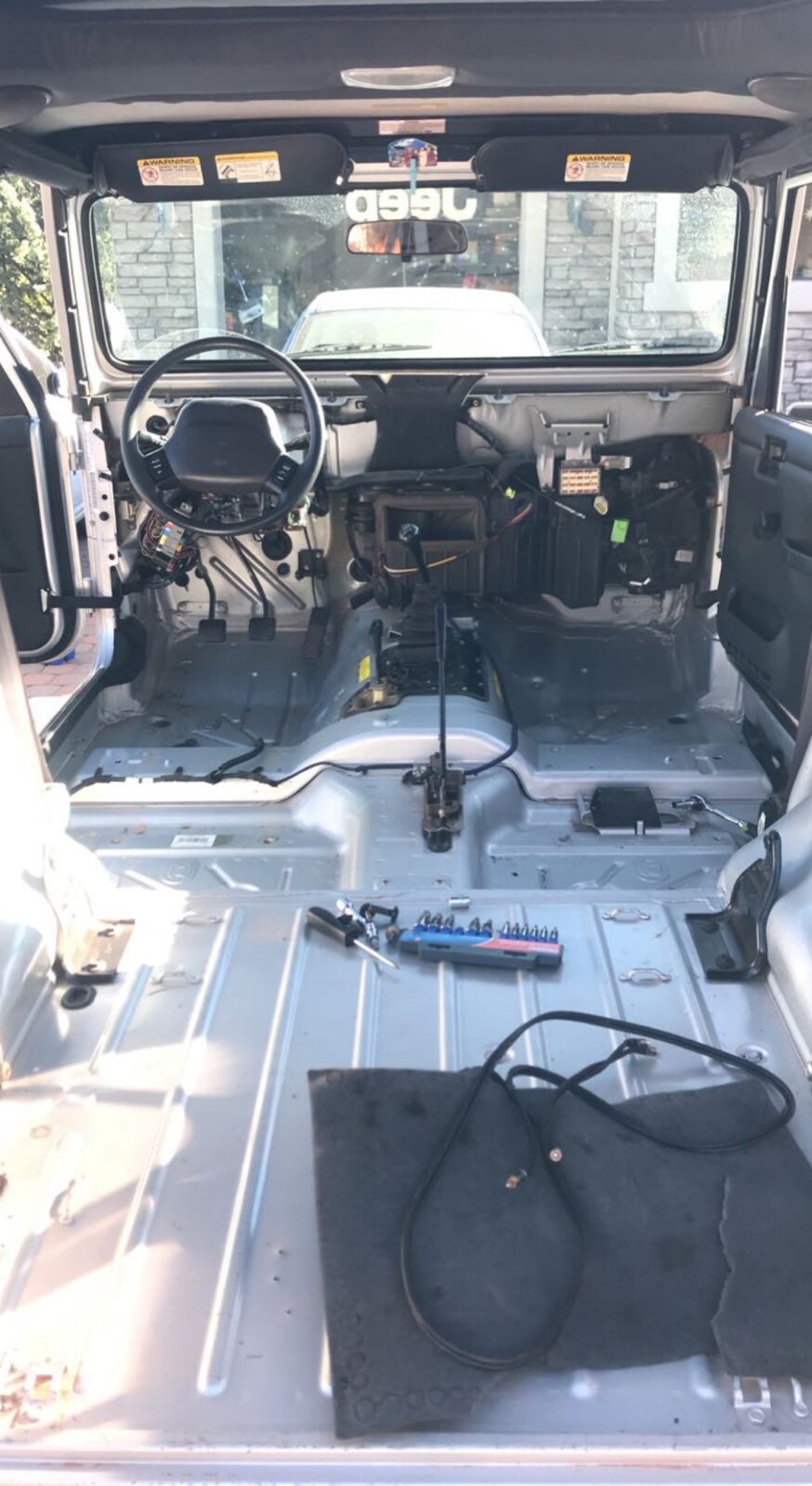

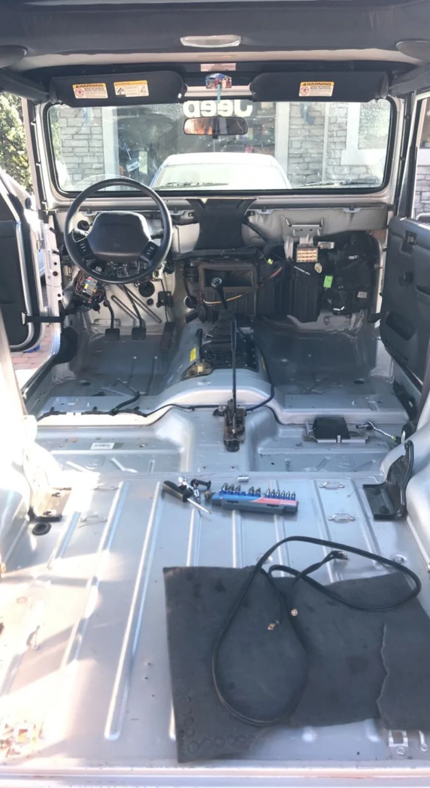

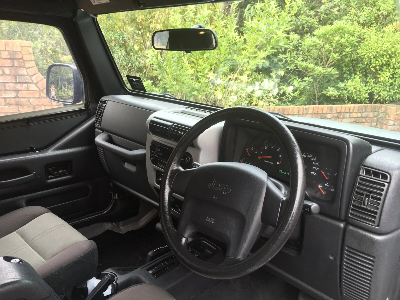

How difficult was taking that dash apart?
Wow I didnā€™t notice your question until now! It wasnā€™t hard at all. It was removal of the three nuts on each side by the speakers, I think three or four bolts across the top of the dash under the defrost trim and the thing pretty much lifts up and out. You just have to take the connectors apart where they connect from the firewall to the dash. Hereā€™s a good picture of the backside from my 02. The steering column has to go too but itā€™s only 4 bolts holding it in.

Wow, backside of dash looks pretty daunting. Important bit would be to remember what connects where?
This morning only I had hard time remembering stuff that I pulled off couple of months ago.
