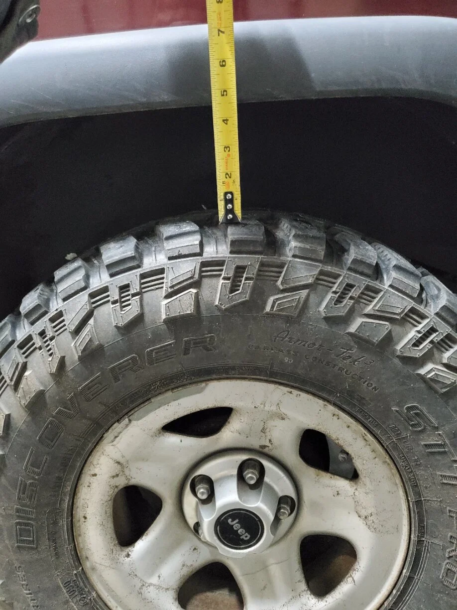

Well, this weekend was all about changing fluids, fixing little stuff and getting to know the TJ better. Changed out both diffs, transmission and transfer case. All of them were pretty old and the diffs had water in them but all fresh now. Thought I had a bad u-joint up front so I changed both out only to discover they were "ok" but I did find the 31" tires were rubbing the lower control arm on the drivers side. Easy fix, just added a nut to the steering stop like a PO had done for the passenger side and now no more rubbing. At list I know I have fresh u-joints up front and they shouldn't be a problem for a long time. Adjusted the rear brakes so the e-brake works now.

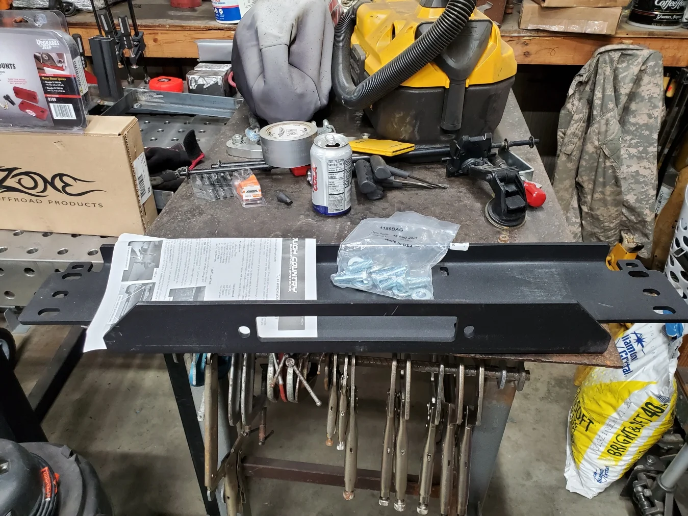

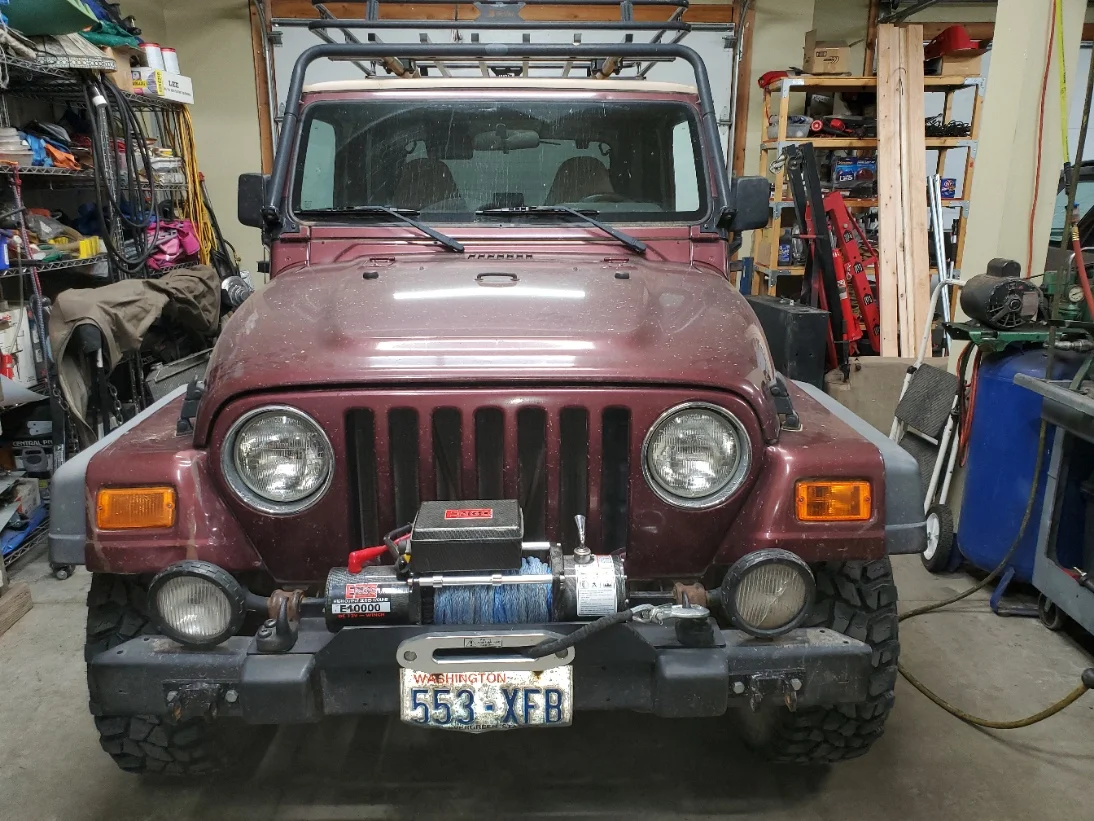

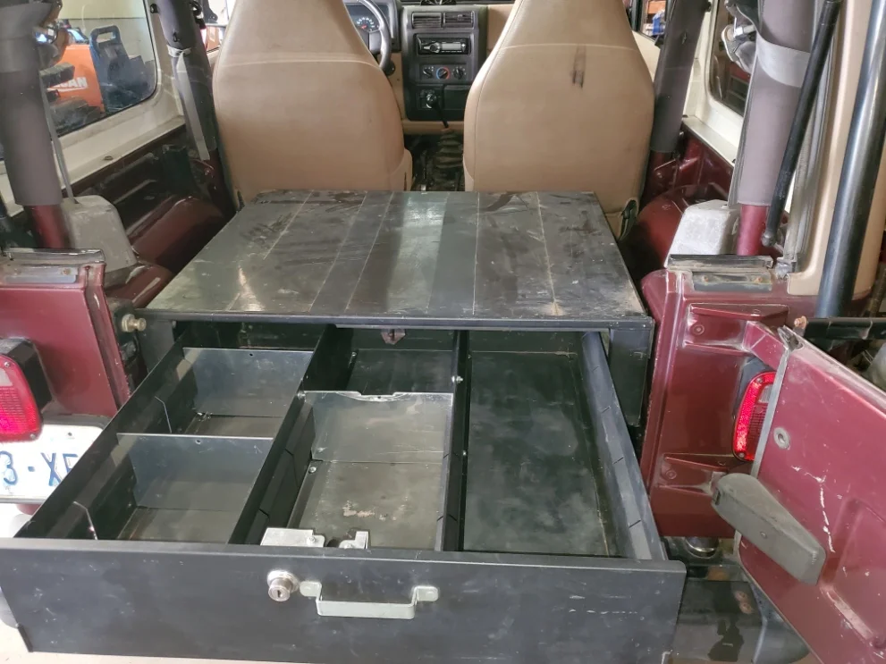

Weekend update. No word from Savvy yet on the Tcase shifter, so hopefully this week. Dang Facebook Marketplace got the better of me but they were deals not to be passed up. Found a winch plate for $55, and a Tuffy security drawer for $200, and now they are mine. Ordered up a riser and divider kit for the drawer to hold all the recovery gear securely. Got an idea brewing to build a small aluminum rack for the top of it. Later, much later down the road.

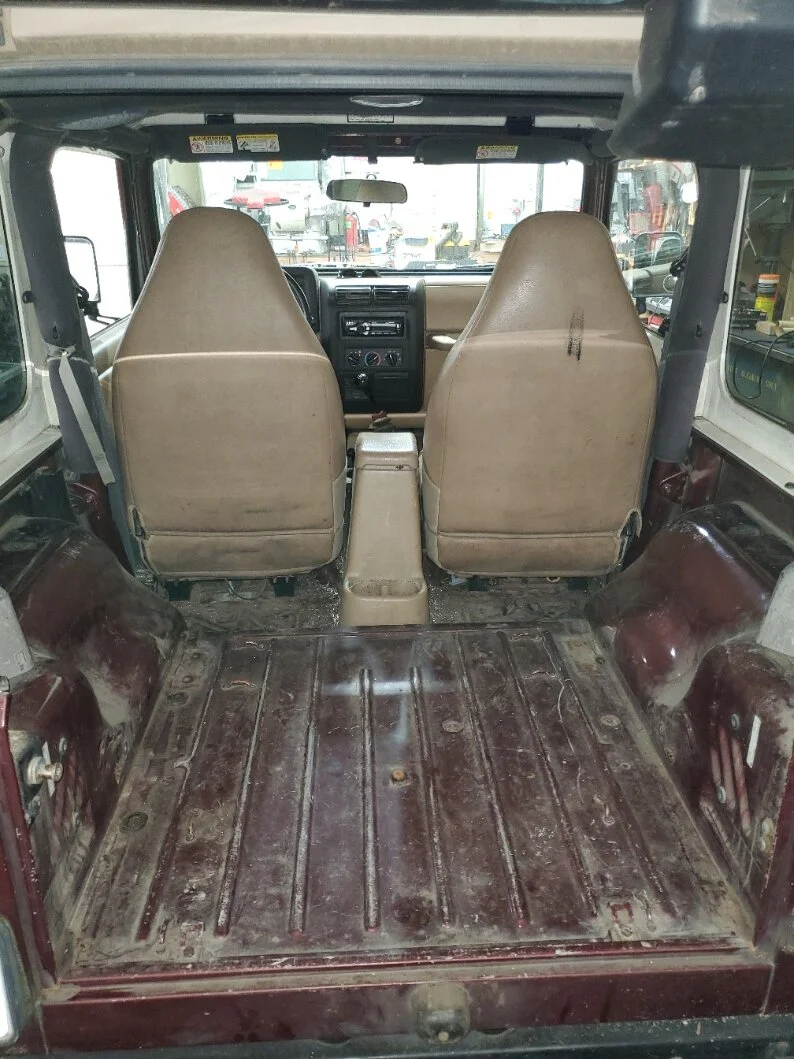

Pulled the rear seat and carpet kit in hopes this weekend would be nice and I could give the Jeep a bath inside and out, but alas, cold and rainy in N Idaho this weekend. PO had a 160 acre farm / ranch so the underside is coated in farm mud and the carpet was nasty and had these little bugs in it and under it. Time to go to the dump. Inside is probably going to be bed lined at some point in the distant future. In the mean time, I got the winch mounted up and working

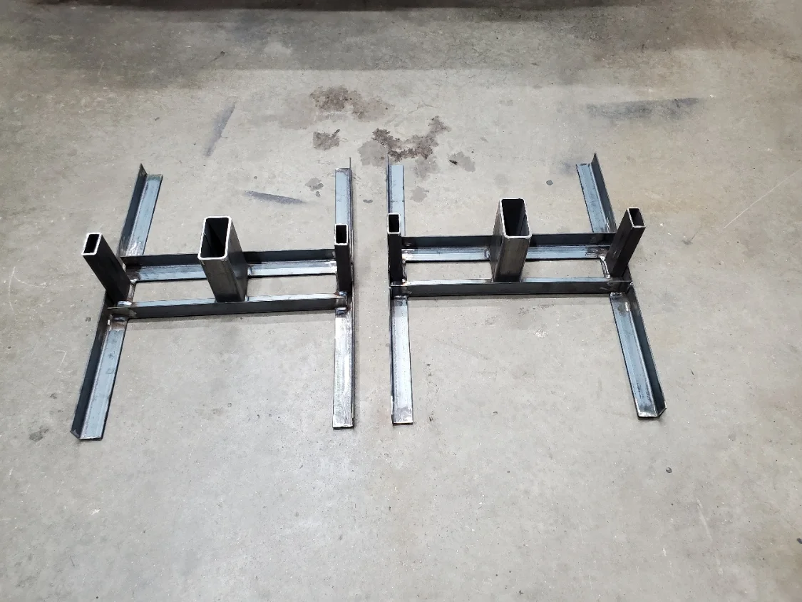

Also built a couple target stands that I have been meaning to get to. Sometimes my A.D.D. gets the better of me.

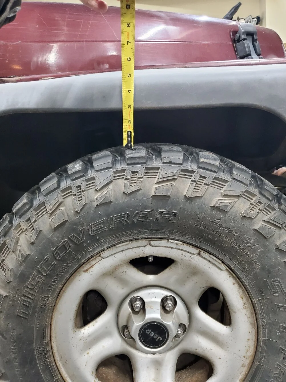

Wrapping up another weekend in the garage with my TJ. The Savvy cable shifter came in this week so I got the first stage of lift installed this weekend. I figured since the body mounts were 20 years old and traveled 325K miles, it might be time for a new set since I was doing the body lift anyway.
Savy Cable Shifter — Check
Zone 1.25 Body Lift — Check
Crown rubber body mounts — Check
JKS MML -Check

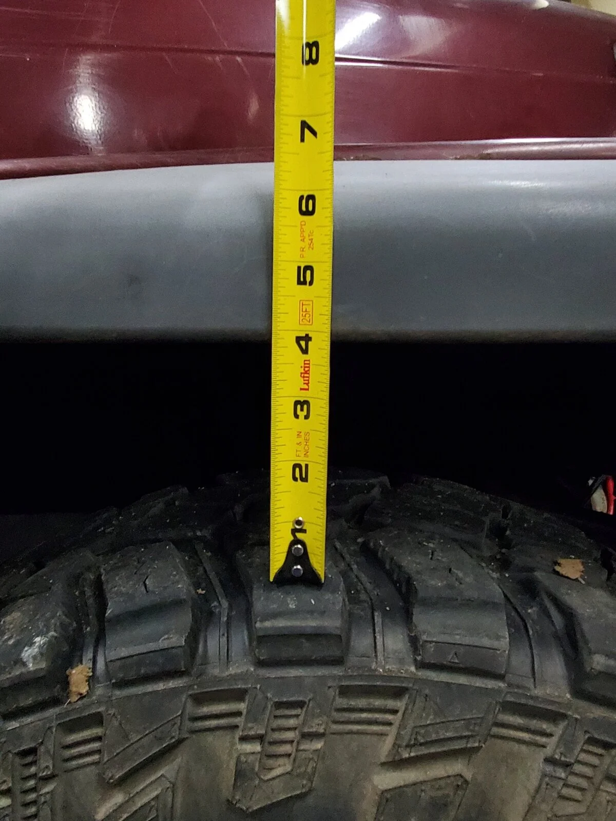

Between the new mounts and the BL it looks like I gained ~1.5"
Front Before and after
Rear before and after
This took all weekend by myself. Arguably, I was cleaning up thing I found that needed to be fixed while I was there. The transfer case shifter was rust welded so getting to 4 low involved full body weight to get past the notch. Skid plate got cleaned up, de-rusted and a fresh coat of paint along with the frame rails where the skid plate mounts up.

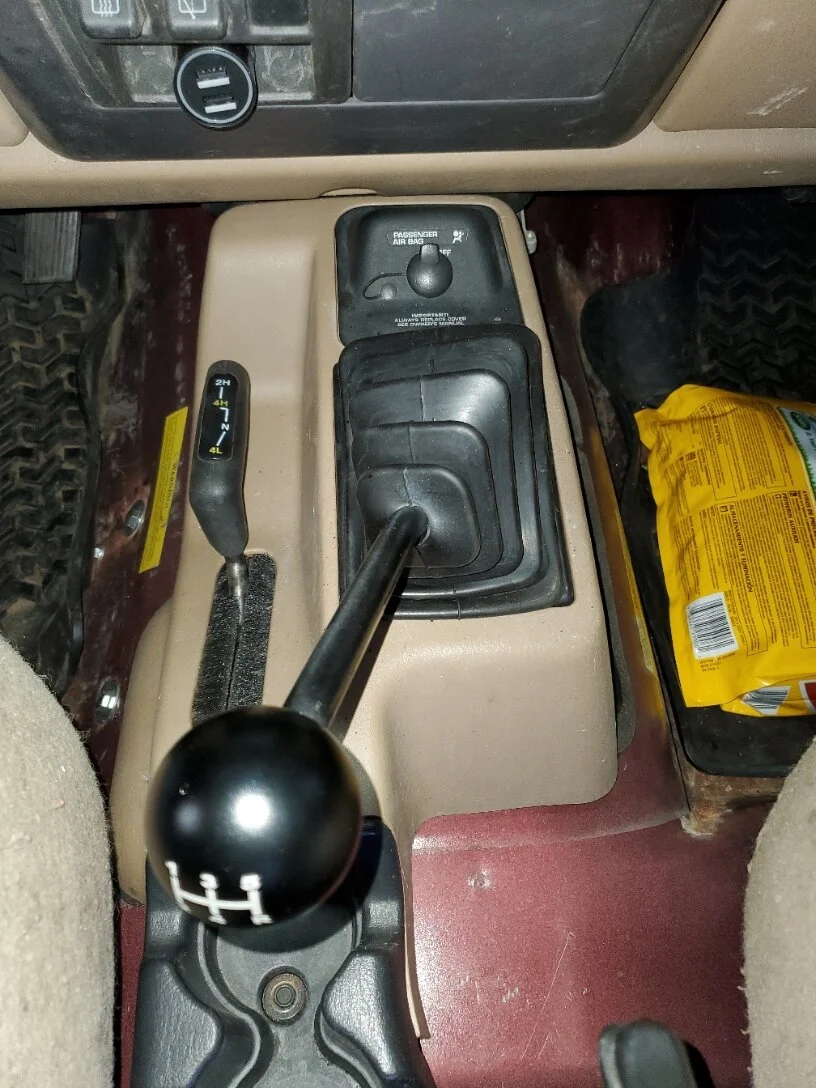

Tuffy drawer and air bag switch light will have to wait for a short bit. I need to hunt down a solder wick, ACE didn't have any. Took out the center console whilst cleaning things up, the rear portion was destroyed, the front is in good shape so I guess I am on the hunt for a tan (camel) rear console.
Reactions: ragdoll
Updated pic after the body lift, funny how just 1.5 inches makes a difference in the stance. I like it.

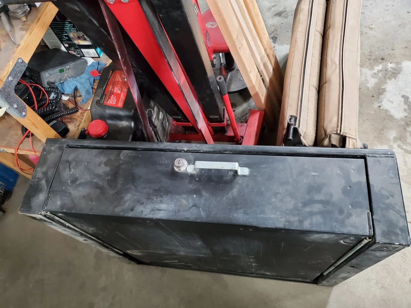

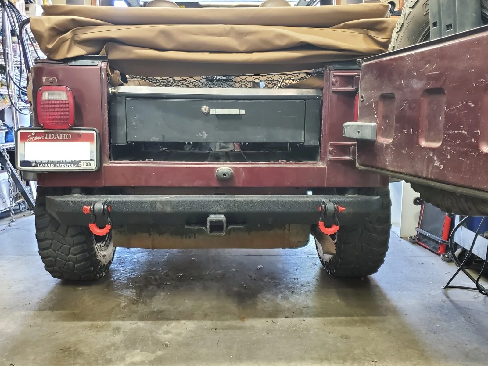

got the Tuffy storage drawer installed last night.

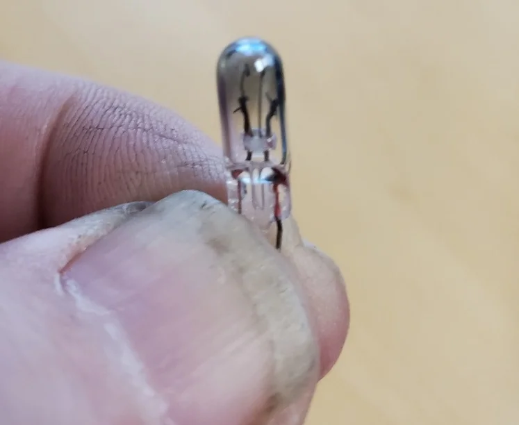

Soldered in a new lightbulb to the airbag switch. Yup this is definitely the issue with the dashboard airbag light, or at least one of them.

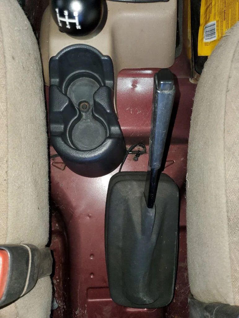

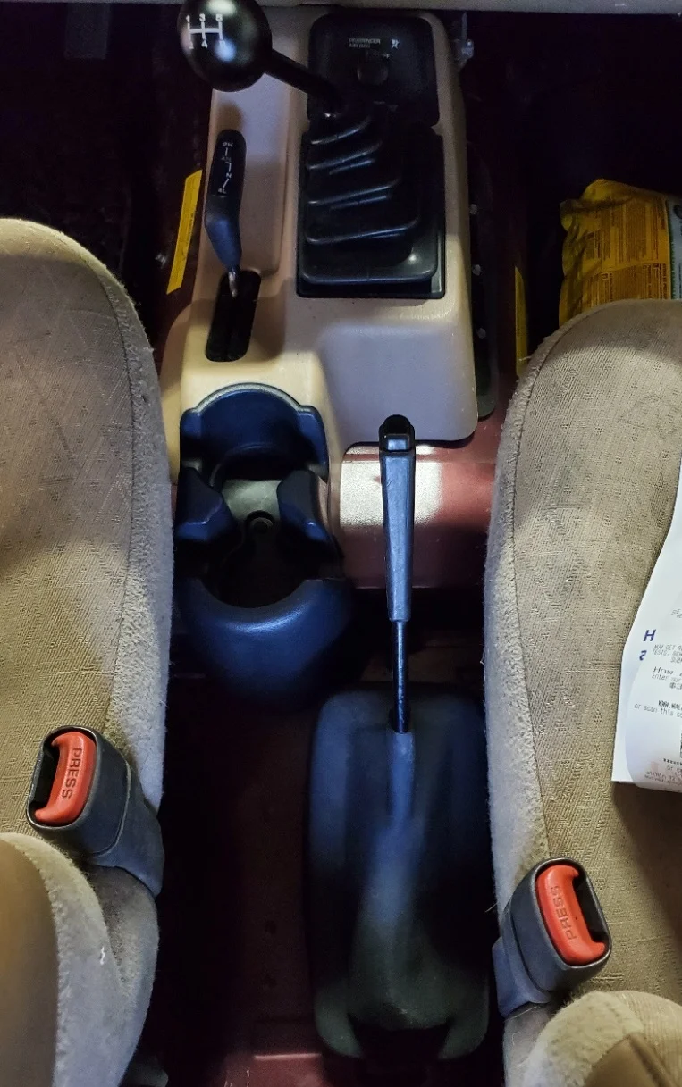

After replacing both shifter boots and the broken gear shift knob I got the front console reinstalled and thanks to @voodooridr, who had the cup holders to complete the short console and a boot for the e-brake handle.

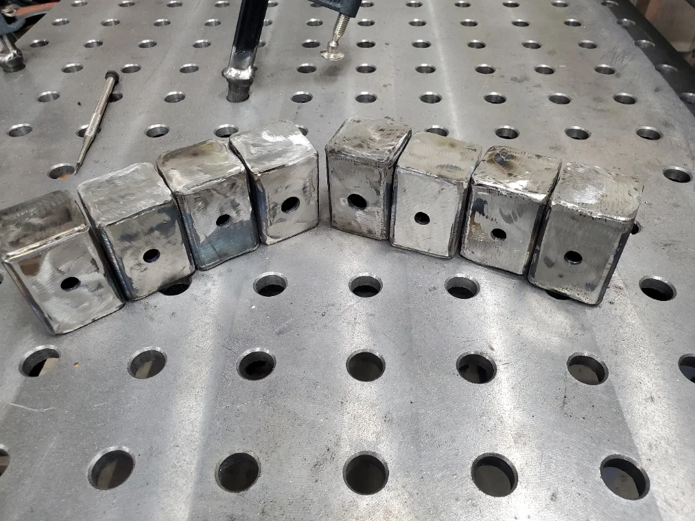

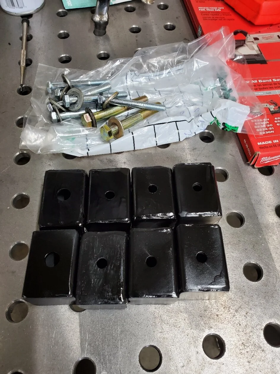

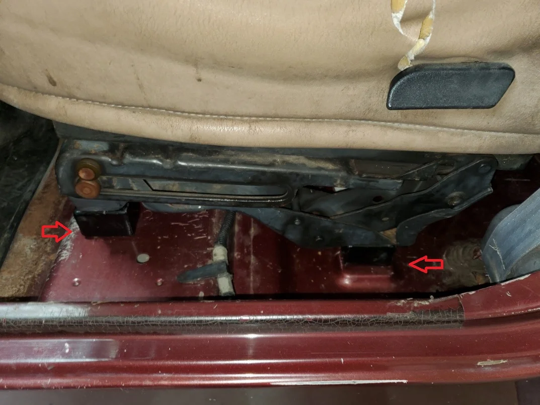

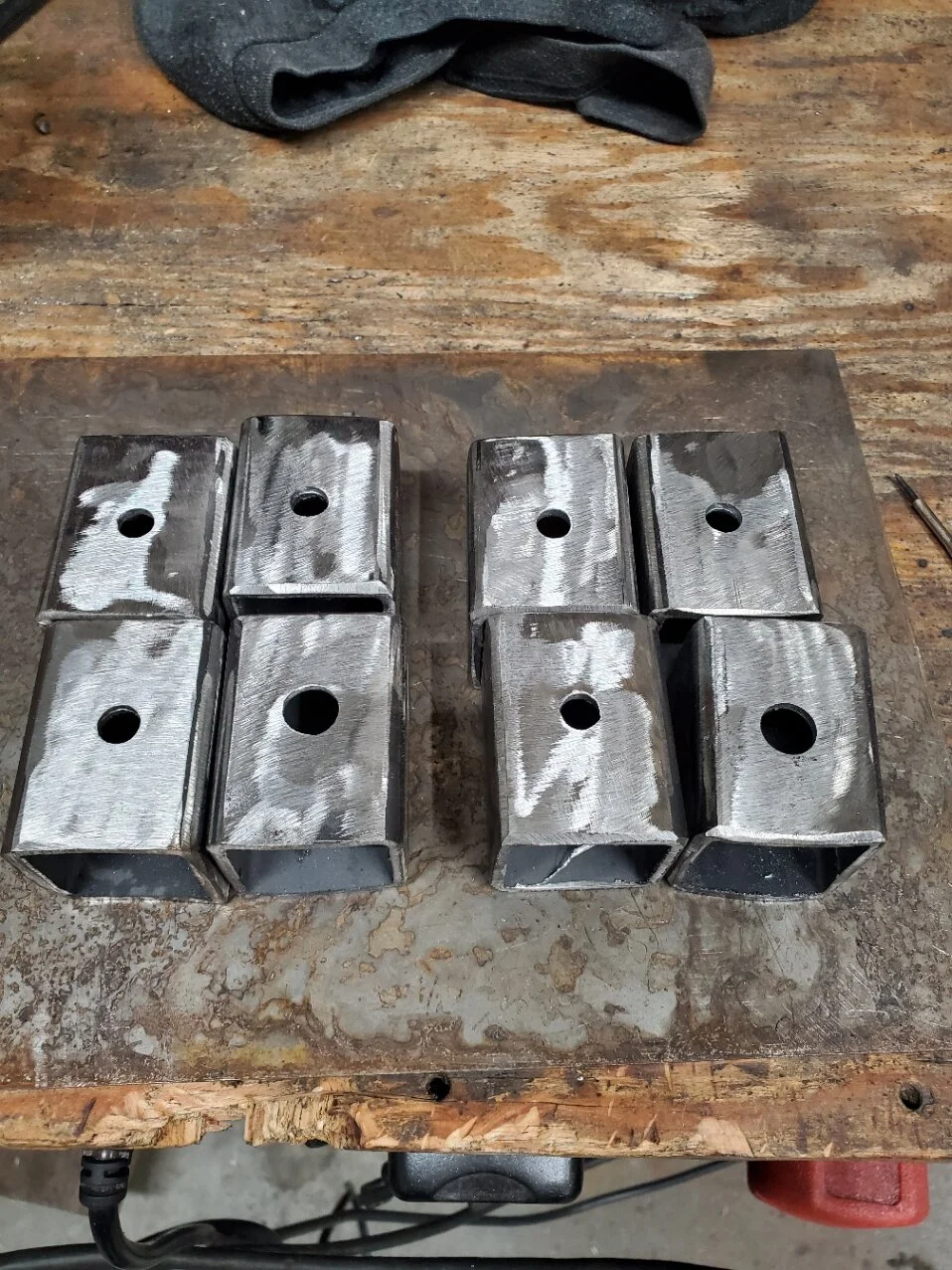

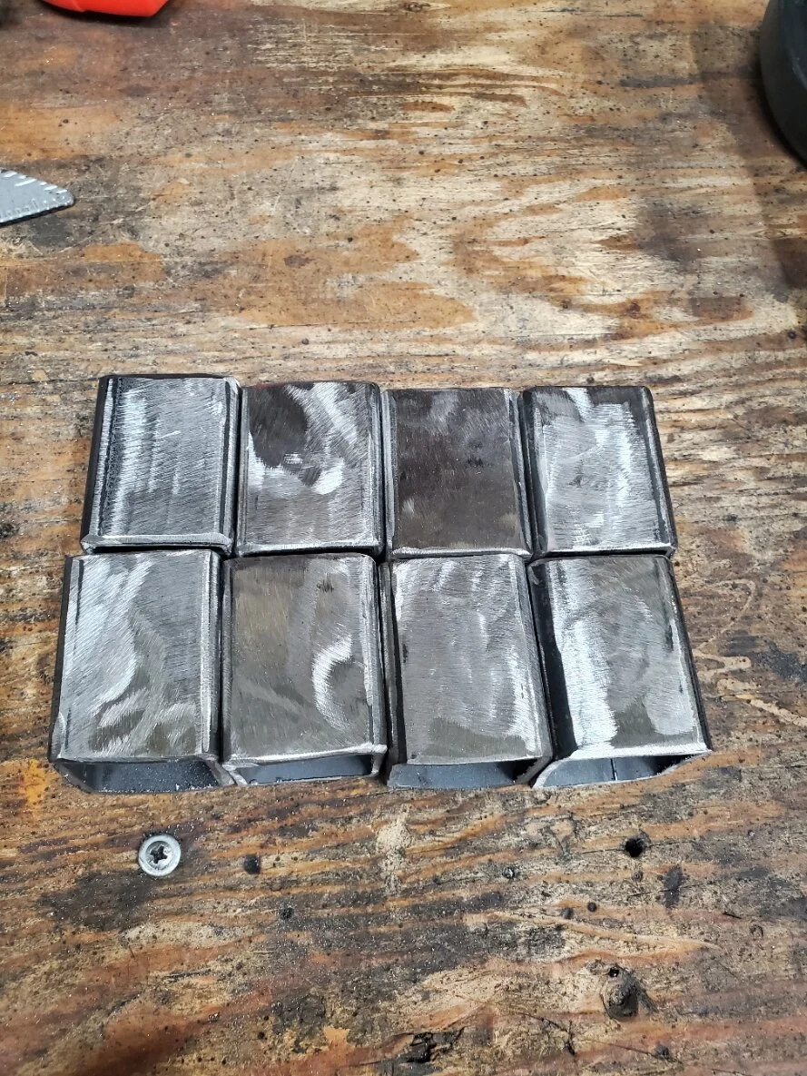

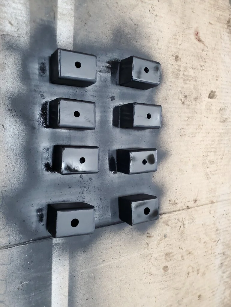

After doing some forum surfing, I discovered I was not the only one who felt like I needed a booster seat to drive a TJ and thus found seat risers. Yeah, I could buy a kit, but that costs money and then I have to wait till it arrives. I have some scrap metal in the garage and a new opportunity to tinker. So, 1.5" seat risers made from 1/8" wall square tubing, caped with 1/16" sheet. Each block is 2" long.
Cut, drilled, caped
Painted, kit ready, kit installed
While my highly tuned butt dyno can't decide if I got 10 or 15 extra HP by installing these risers, I can tell you I really like the higher view angle and being able to comfortably rest my arm out the rolled down window. Leg position is much more comfortable as well.

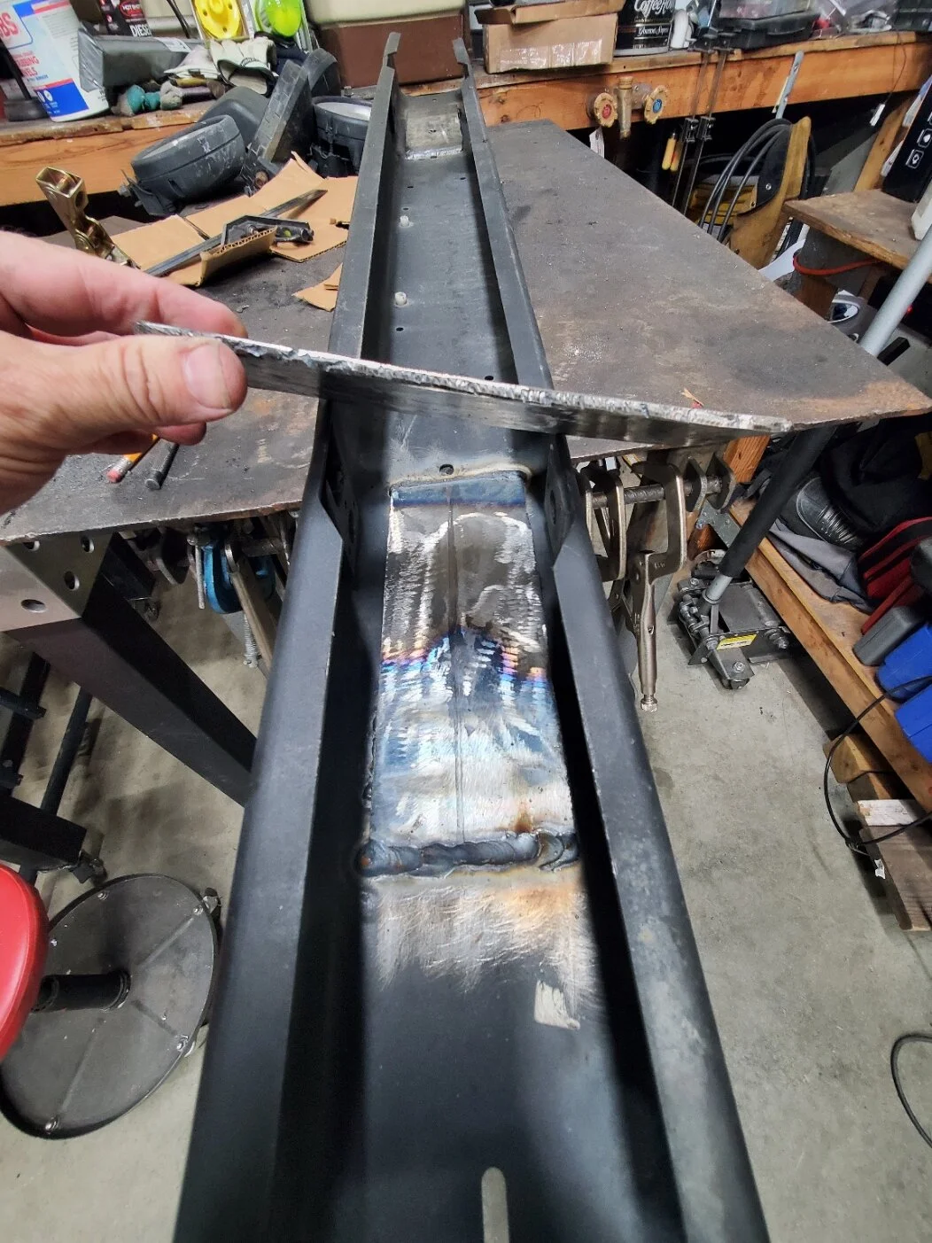

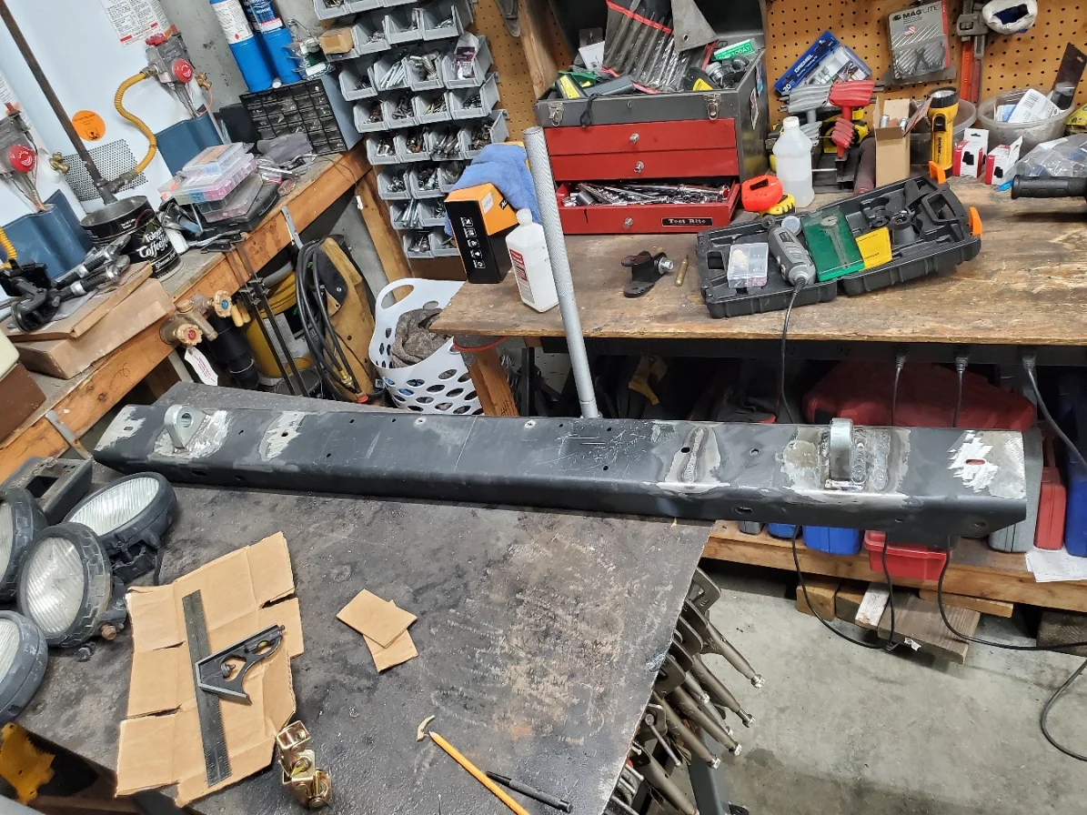

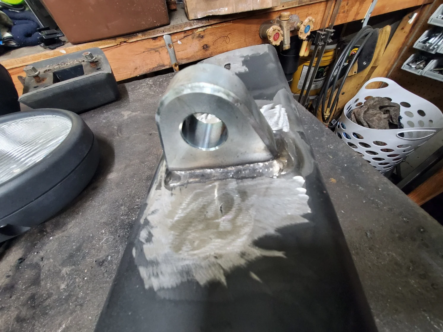

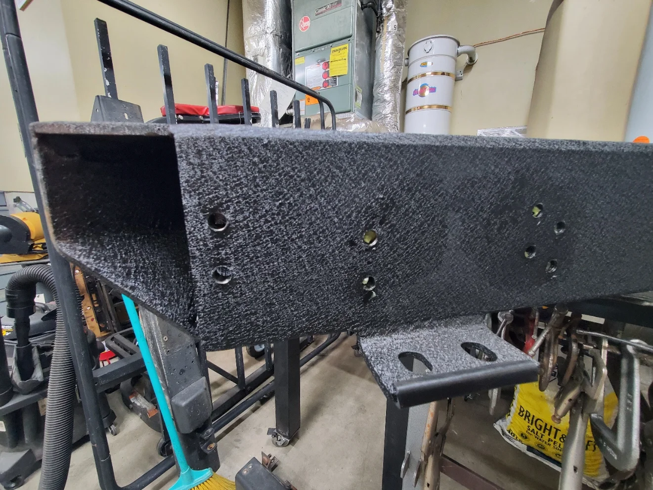

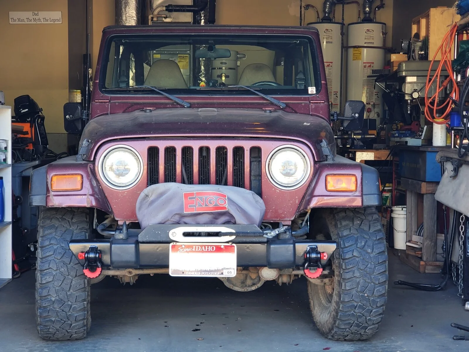

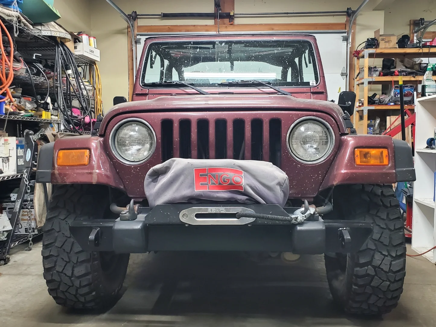

Catching up on the build thread. Latest mod was to the front OEM bumper. I'm cheap, I like Craigslist and sometimes I just wana see what I can do with my welder.
I ordered a couple of shackle mounts and welded them to some 3/16" plate steel recovered from my scrap pile. Then I cut a couple holes in the oem bumper, fited the shackle mounts through and then welded the bumper, plate and shackle mounts together. Then welded the plate to the back side of the bumper to help stiffen the whole thing. The plate extends to the front of the of the frame to help transfer any pulling stresses to the bumper frame bolts. Then I cut back the ends a little and boxed them in and plug welded all the excess holes. Installed with a couple shackles and now I am recoverable from the front. Back is next.

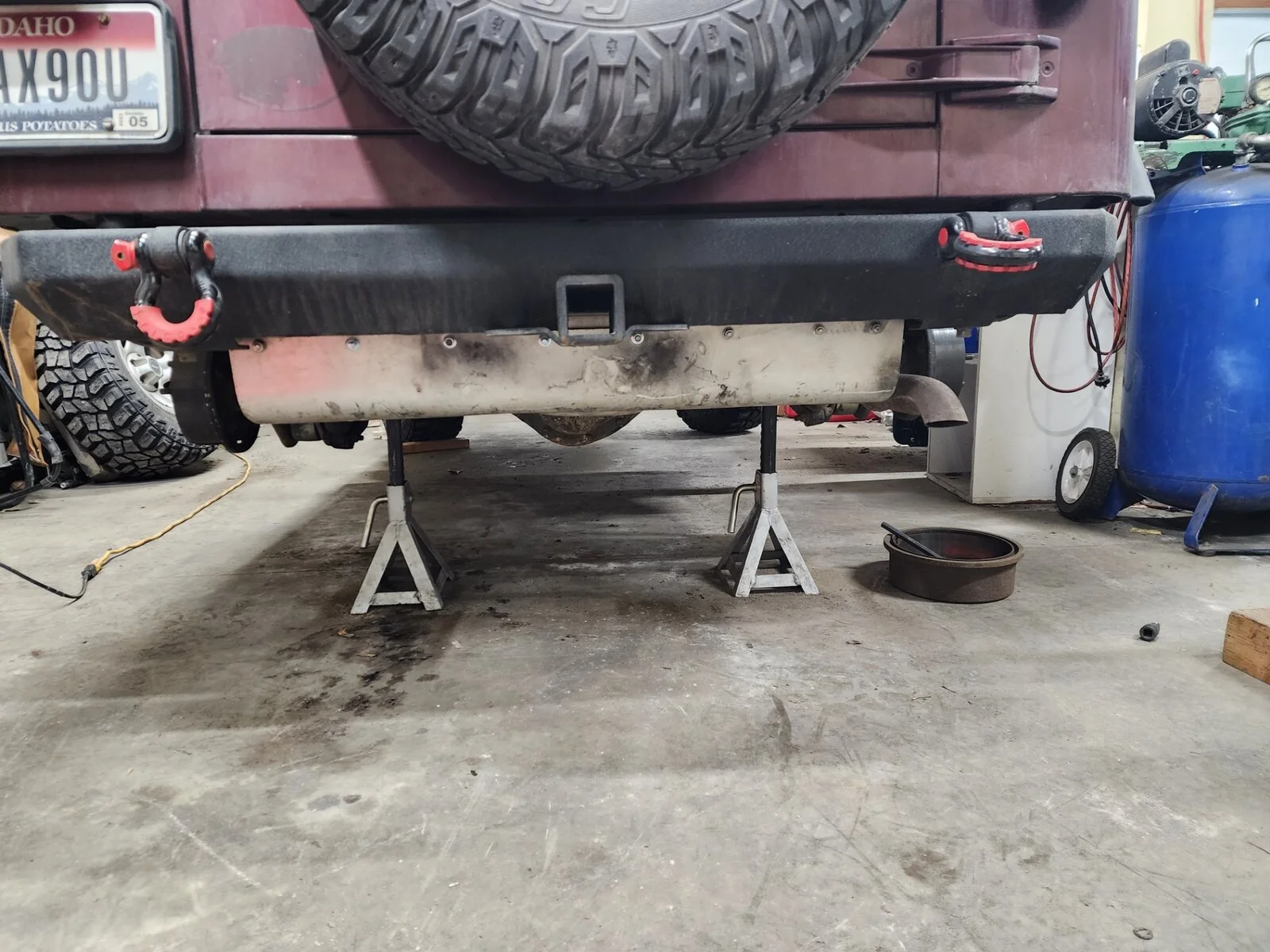

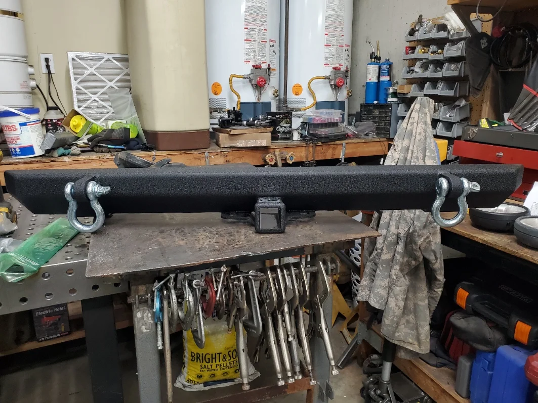

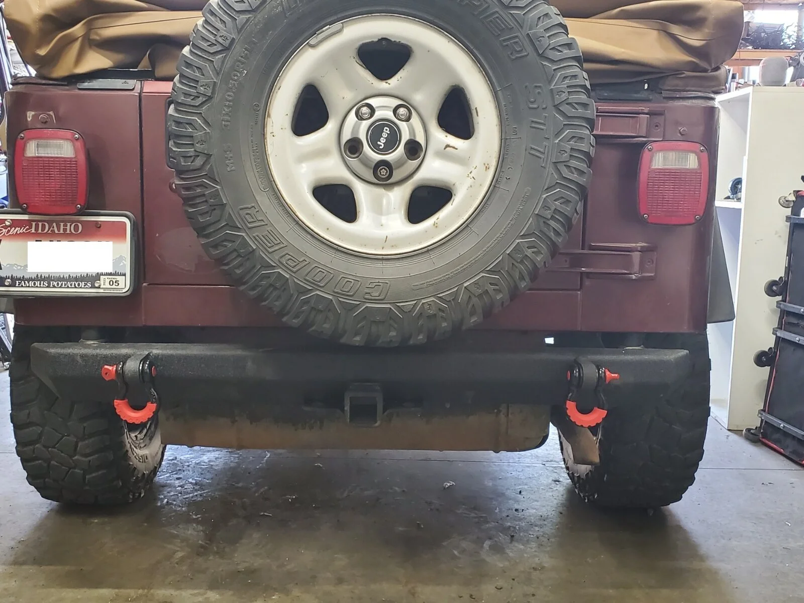

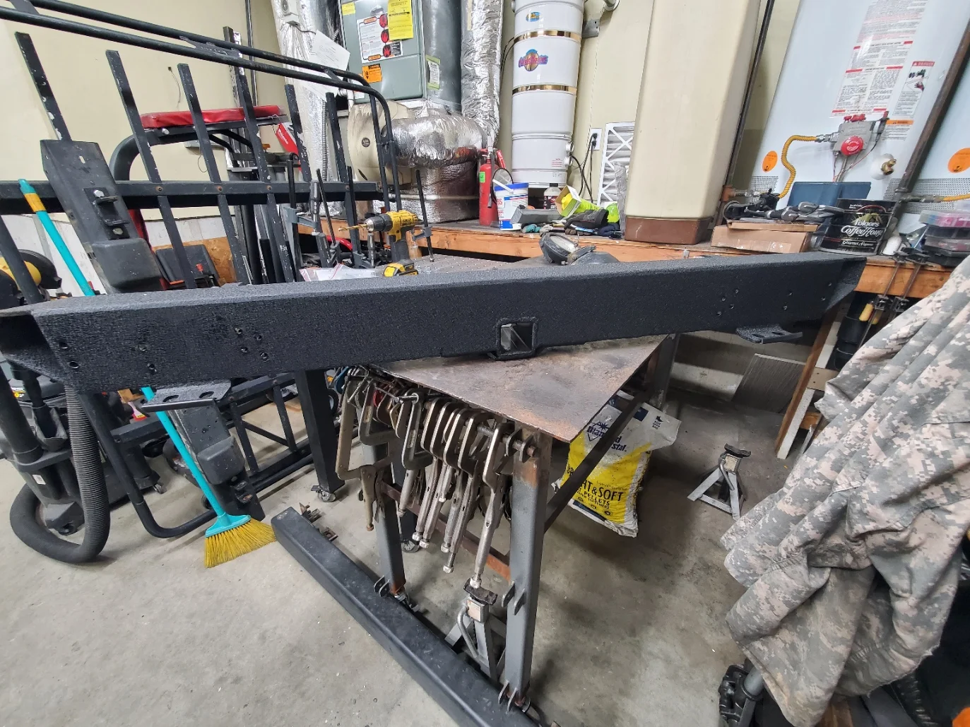

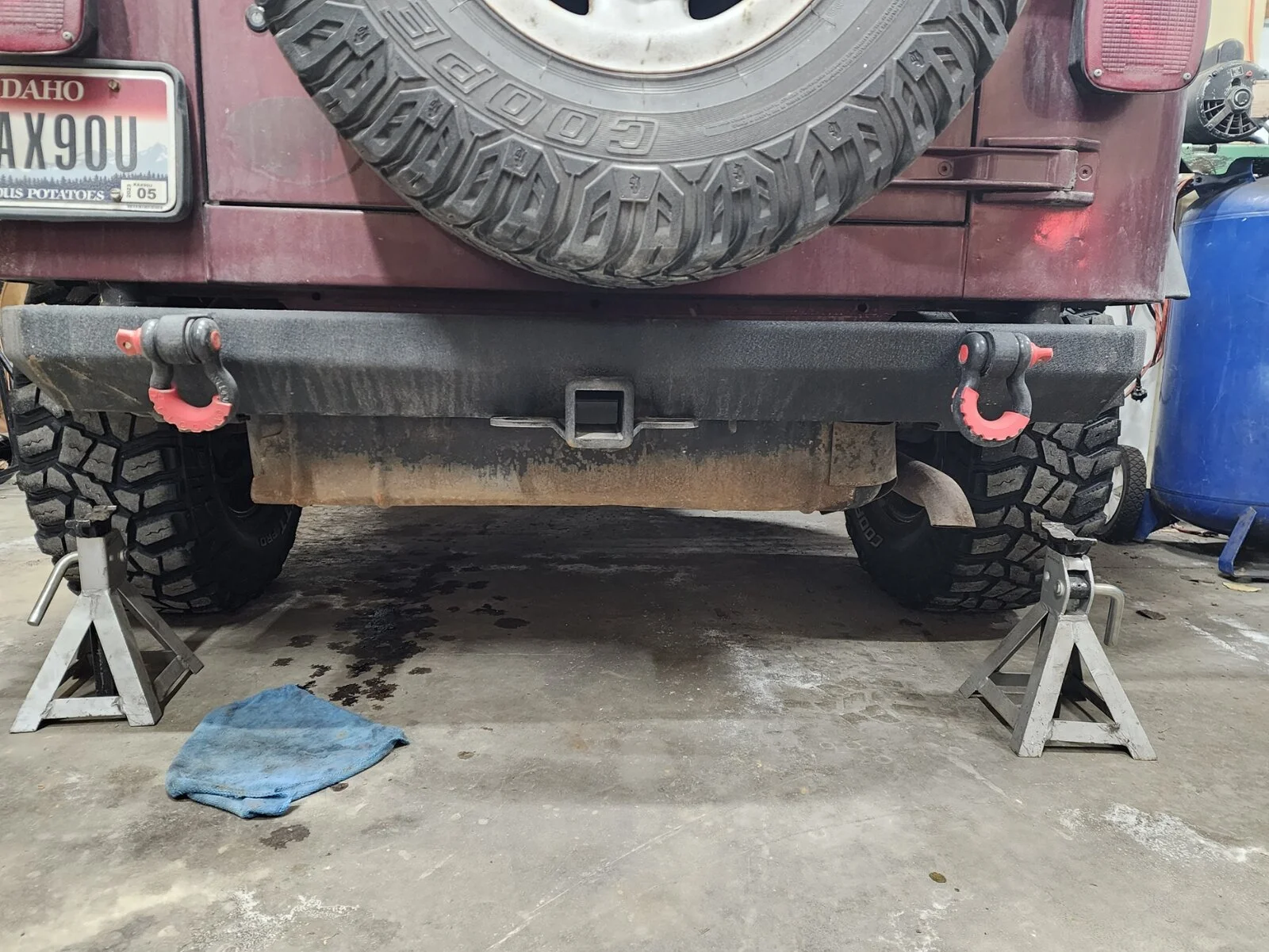

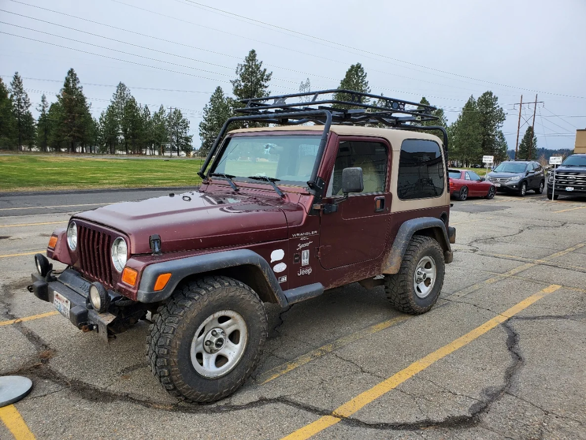

Installed a best top replacement sailcloth top. Changed from Khaki to Spice. The tan matches better, I think. Installed a Smittybilt classic rock crawler bumper. It is simple, heavy duty and inexpensive. For anyone interested, it is 1/4" plate steel, fully boxed and the hitch is rated class 3 / 500 lb tongue wt / 3500 lb pull wt and a MUCH better departure angle than the OEM hitch and bumper.

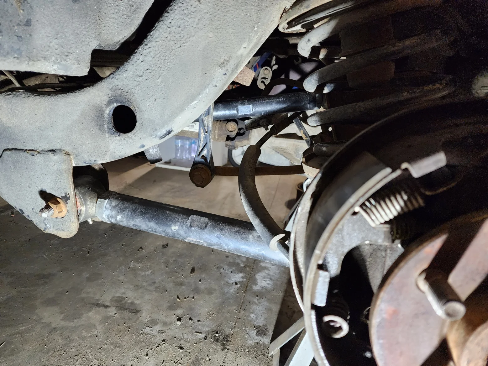

Installed the rear Rokmen Double Adjustable CAs. Also a Market Place find.
Doing rear brakes tomorrow and fixing a damaged wheel stud. If that goes well, maybe I'll have time to install the front Rokmen CAs.
