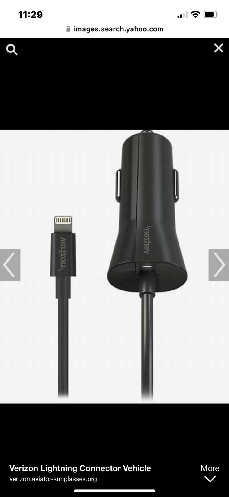

Mine works fine with this one,and if I need it to charge when I have the engine off I use the power outlet to the right
