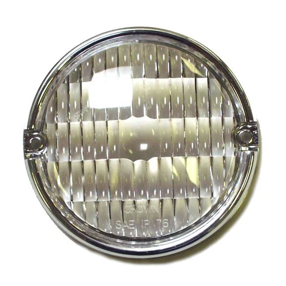

I really like the look of the CJ turn signals on the grill of the TJ with the signals on the fenders removed. But looks like it would be a little pricy if you don't know how to do your own body work of the fenders.
I would go with the original looking CJ turn signals.

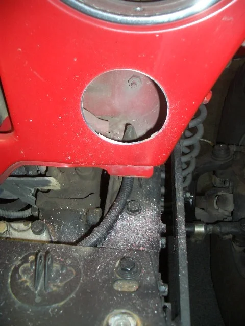

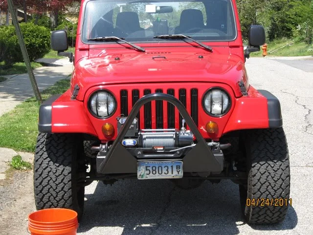

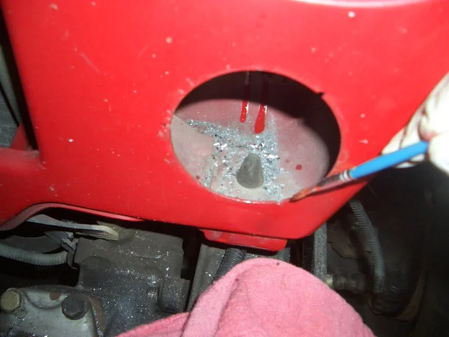

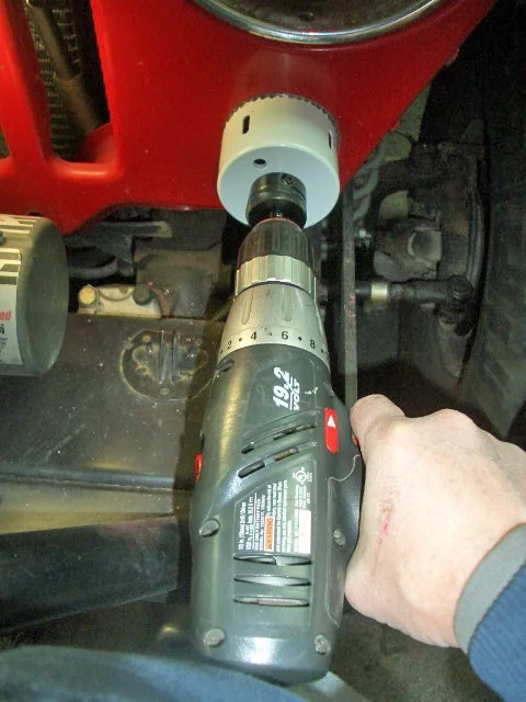

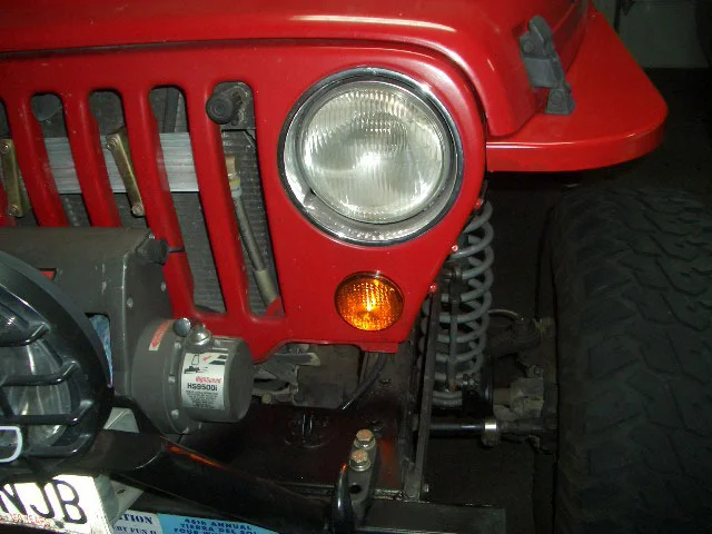

It's easily done with nothing more than a 3 1/16" steel hole saw and a pair of JK turn signal enclosures, I did mine years ago. JK front turn signal enclosures fit the 3 1/16" hole perfectly. The TJ's front turn signal bulb enclosures fit the JK turn signal enclosures perfectly.
If you get serious and are ready to do this, I have a few additional tidbits to make the mounting of the JK enclosures easy so they don't require anything additional to old them in place. The enclosures can be made to twist-lock into place with no extra hardware required.
These photos are from my previous TJ but I did the same thing on my current TJ.

I like this a lot too. The JK side markers are the way to go. The size and little details are more appropriate to the TJ then the older CJ lights.

I don't know I am tied, I can't tell what one I like better. I like the CJ because it has a border. I do like the orange lens but a yellowish orange bulb behind that CJ lens would be pretty cool too. I think I would like the JK lens better if it had a black frame maybe. I do love the painted flat fenders though on @Jerry Bransford's old Jeep. Nice and clean!

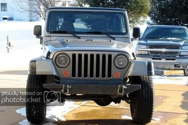

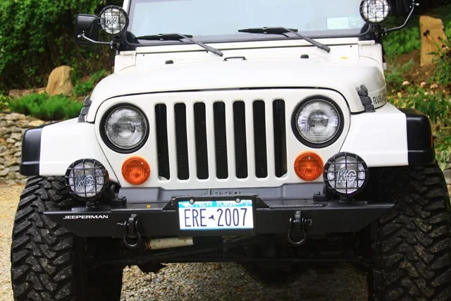

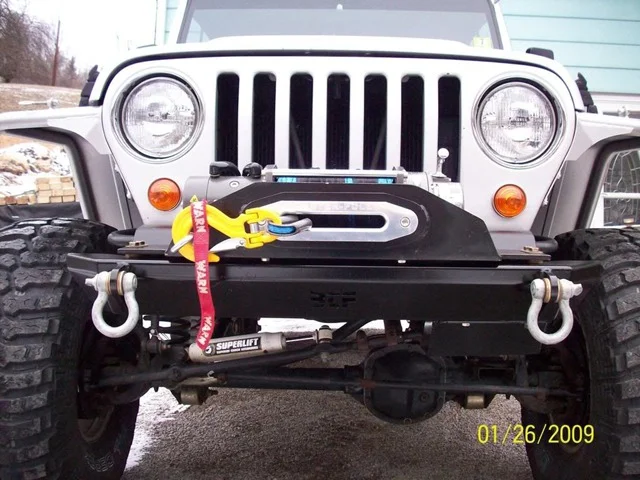

I really like the last two pictures with the stock front fenders filled in and painted. Then I would add the clear CJ turn signals with the amber bulb like they were on my old CJ. Give the TJ the CJ look coming at you. :)

I prefer the lenses in the top pic, with the ones in the second pic being my least favorite. Love the filled-in full fenders. Being that I have the Sahara, and thusly, the body color flares, I believe it will give the general appearance of an overall wider fender. That's fine for me, but I suspect some might feel it leans toward looking like a JK fender, at that point. Being that I prefer the body color flares, I'm okay with that.

You like the JK and dislike the CJ.
Ouch! That hurt just to read it. Not so much the thought of liking something from the JK, but of disliking something from the CJ. Seems counter to my general way of looking at things. Hmmm...
Anyway, the reason #2 is my least favorite is they're so large that it crowds the headlights. Makes the grill look overly busy. Of course, being that the rig has all the extra auxiliary lighting, as well, maybe that's affecting how I'm seeing it. (shrug)
