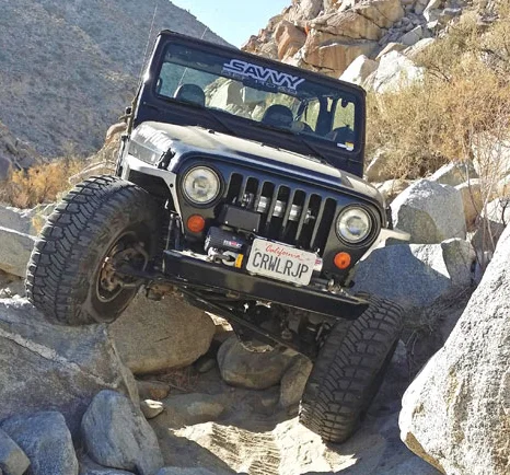

That’s true, I don’t love the look of the location on the JK. I put mine closer together and I think it looks better, but maybe I’m illegal. 🤷‍♂️
That looks perfect. The proportions are right on. It looks like it came from the factory that way. This is exactly how I would like mine to look.
I think the chrome bezels made the difference, as it is consistent with the chrome headlight bezels. Do you where the chrome bezels came from?

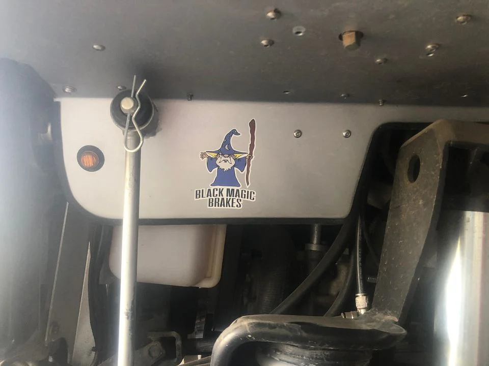

See the little dot led on the fender bracket, it is a three wire/two light version. I had to put a resistor on the drive light so you could see the flashing when the turn is on. I also put a single light led dot under the fender, the tire glows/flashes amber at night when the turn signal is on.

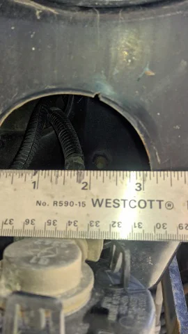

I can't tell in the photo, but there are 3 notches?
Thanks! Brian

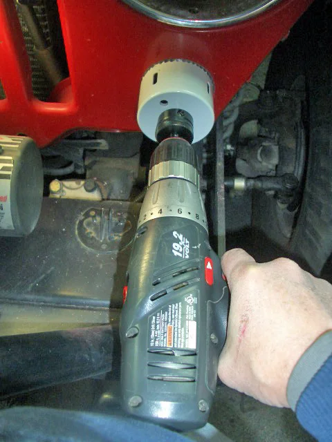

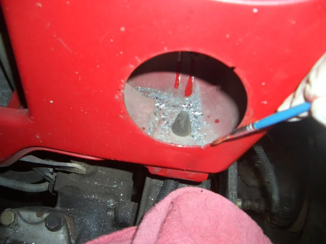

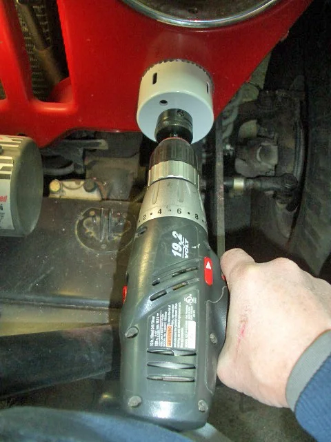

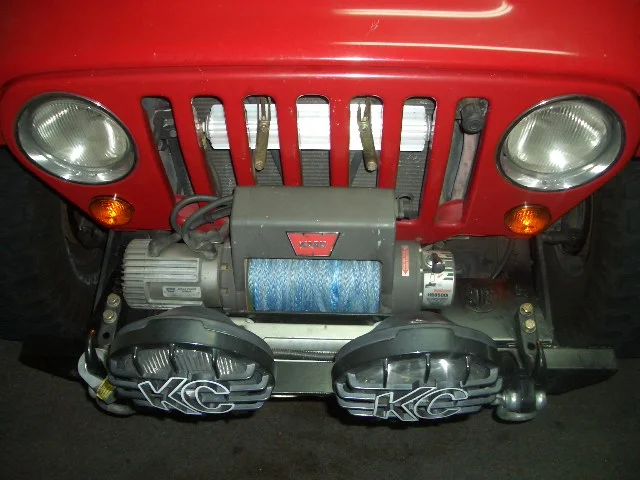

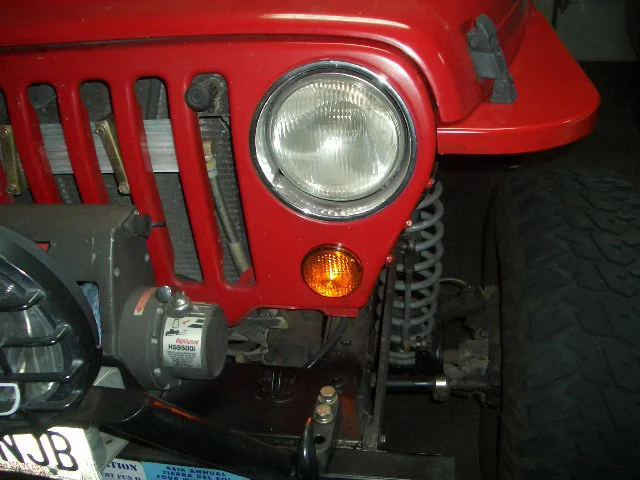

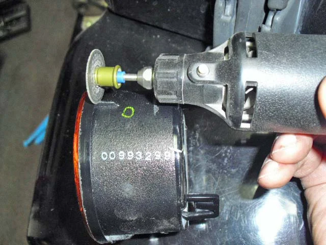

It's easily done with nothing more than a 3 1/8" steel hole saw and a pair of JK turn signal enclosures, I did mine years ago. JK front turn signal enclosures fit the 3 1/8" hole perfectly. The TJ's front turn signal bulb enclosures fit the JK turn signal enclosures perfectly.
If you get serious and are ready to do this, I have a few additional tidbits to make the mounting of the JK enclosures easy so they don't require anything additional to old them in place. The enclosures can be made to twist-lock into place with no extra hardware required.

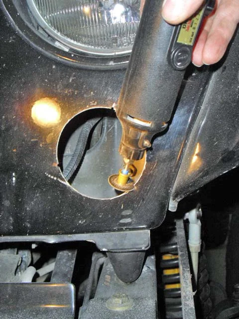

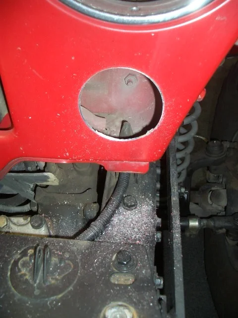

Edited to add another photo of the large 3 1/8" hole to show the notches cut into it for the ribs on the bulb enclosure to fit into.

These photos are from my previous TJ but I did the same thing on my current TJ.

I made the hole and enclosures so they twist-lock into place.
Use a 3 1/8" hole saw.
Notch the hole like this, so the three notches to match the three ribs on the JK enclosures are 10-20 degrees away so the JK enclosure would be 10-20 degrees away from being perfectly vertical.
Then cut a thin sheet-metal thickness notch at the very front of each of the three ribs. These notches allow the JK enclosure to rotate to lock into place. Insure the notches are at the very front of the ribs.
Insert the JK enclosure and twist it so its pattern is straight up & down, it will be locked into place.
Yes these pics show two colors of Jeeps, I did this to both of mine.
