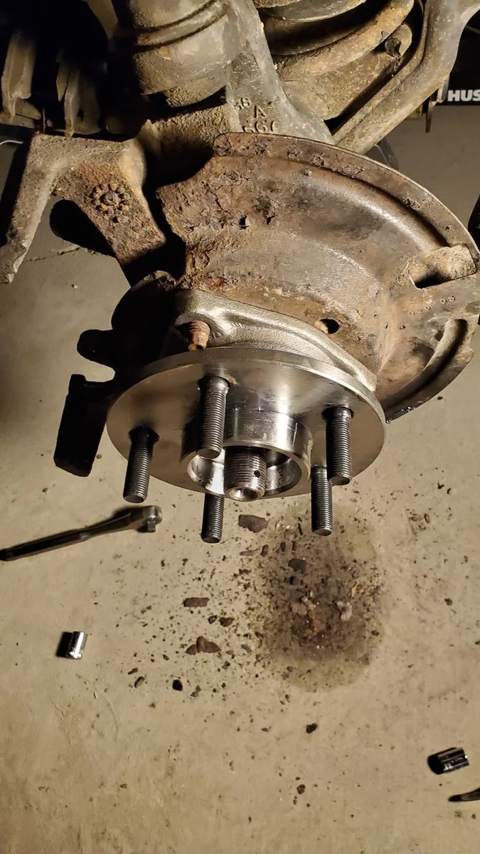

I have had an issue the last couple of days were when my jeep is moving I get a clicking noise like a card in bicycle spokes. It only happens when my jeep is going above 5mph and gets progressively louder and quicker with speed. There is no sound when parked or when manually turning the front wheels. Today I put it in 4 wheel drive and while the sound went away it, their was a vibration and it didn't feel right, almost like there was resistance. When I put it back in two wheel drive I suddenly had turning issues. When attempting to turn, even slightly, in either direction, the steering wheel seems to fight back. I suspect either front axle u joint or broken/binding splines in the differential. I just wanted to see if someone had any input and advice on if I should check the differential or replace the u joints/hubs first or if I should go in another direction completely. If my thinking is correct the steering issues rule out drive shaft u joints or joint at the transfer case (CV?)... Thanks for your help!
