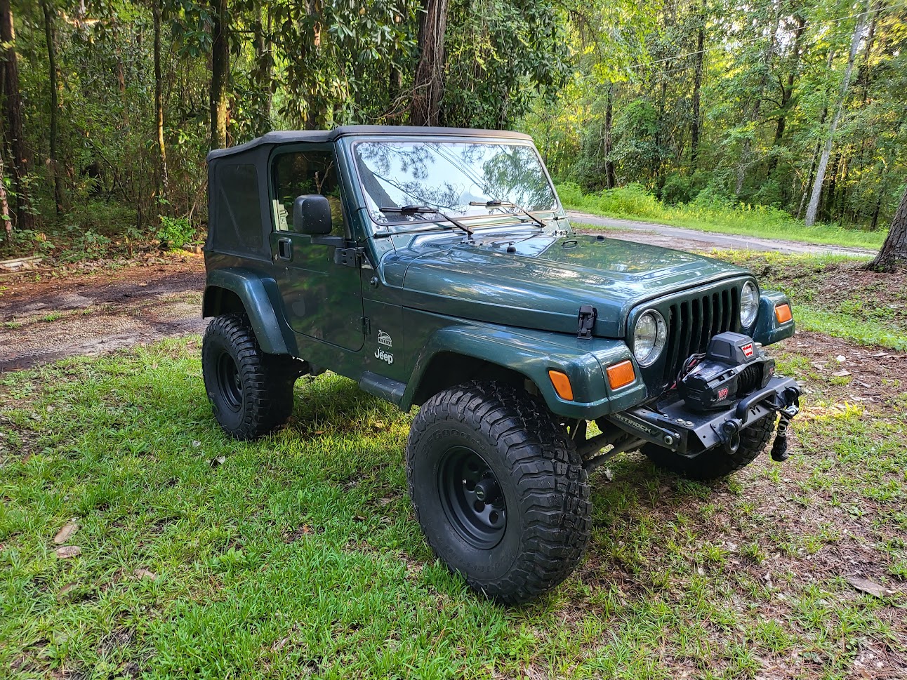

So, with the assistance of you guys I made some decisions about wheels and tires and I'm SO happy I didn't go w/33's. These KM3's look great on my TJ.
For that matter...pretty much every single decision I made was with the help of the folks here/build threads etc...and I thank you all for that.
I've tried to follow the "Buy Once Cry Once" plan...and it has been painful and expensive as I assume every proper Jeep build is.
Build Details:
Currie/RockJock Parts:
4” lift springs.
Front/Rear/Upper/Lower bump stops.
Adjustable control arms all around w/double-adjustable uppers.
Adjustable front track bar
Shock relocation brackets
Rear sway bar extensions
Antirock(steel) Front sway bar
MetalCloak Framebuilt base front bumper w/Shackle mounts and hawse fairlead.
WARN VRO 10s Winch.
Rancho RS5000X Shocks front and rear
Rugged Ridge Mega-Short Slip Yoke Eliminator
Tom Woods custom(19”) rear CV driveshaft w/X splines
Spartan Front Locker
Brake Line extensions front/rear
B&M 70624 Transmission Cooler
Tactik 15x8 Steels
BFG Mud Terrain KM3 in 35x12.50R15
Todo:
1.25” Body Lift & 1” Motor Mount Lift. (parts in hand)
CorrectLync Steering
Dana 44 Rear Axle w/trac-lock and disks.
Regear to 4.88 or…TBD
Upgrade Dana 30 axle shafts.
3/16” rocker armor.
Plate rear bumper w/shackle mounts.
Angry Bird grill...(just kidding - not ever)

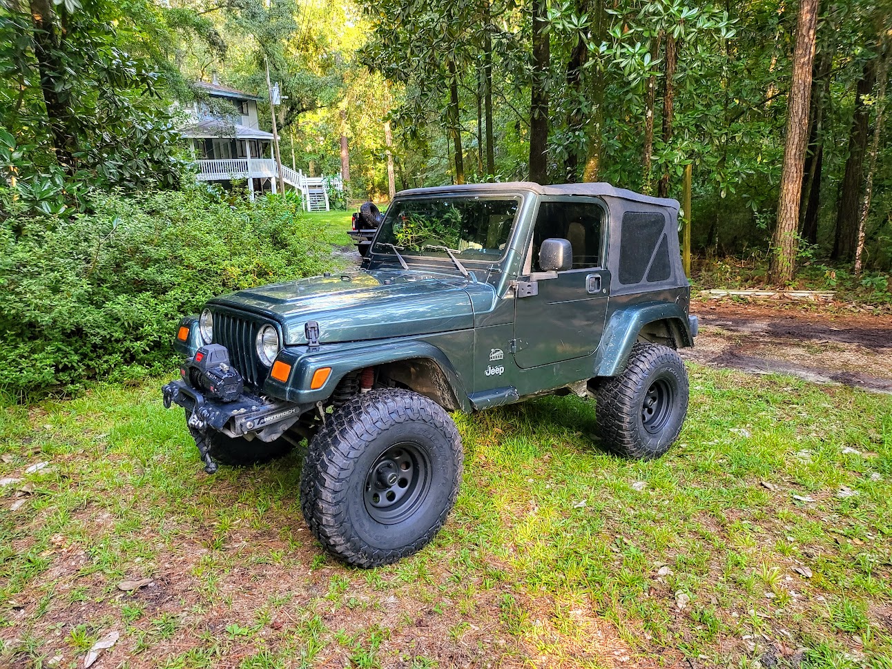

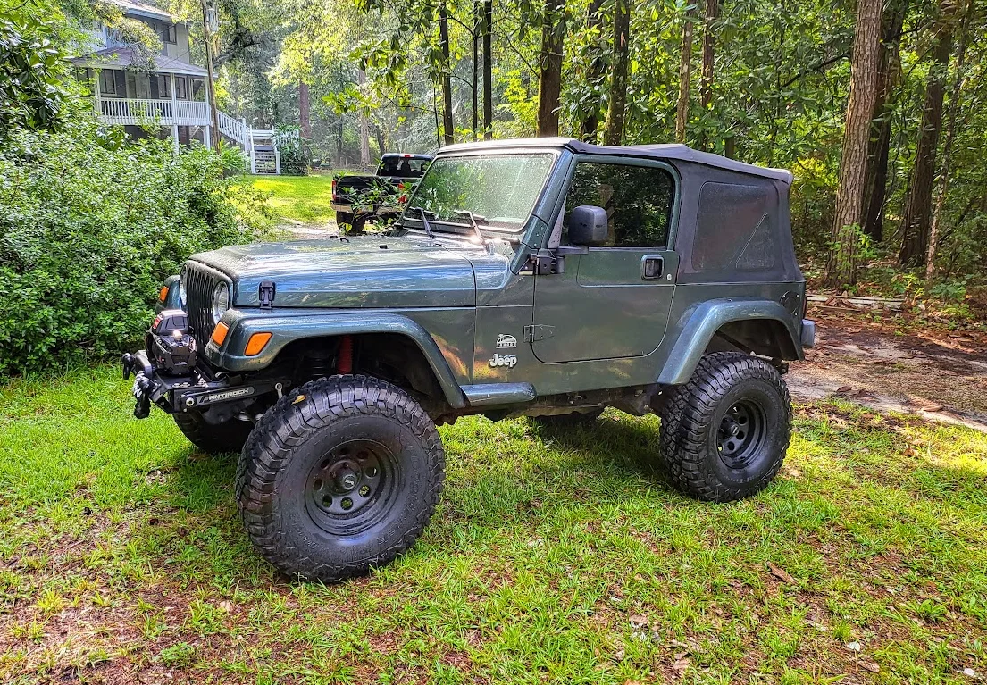

Thanks guys :) I gotta say it turned out way better looking than I was expecting.
The clean/stock-ish all-business look...This is my favorite picture - shoulda posted it first.
I'm a little concerned the 1.25" body lift will slightly spoil the look...I've always liked the big tires/low fender look...full wheel wells. I know I need the extra height to clear the tires correctly though. I'm going to try to get it installed w/the MMLs this weekend.
Usually you need the BL to go with your TT.

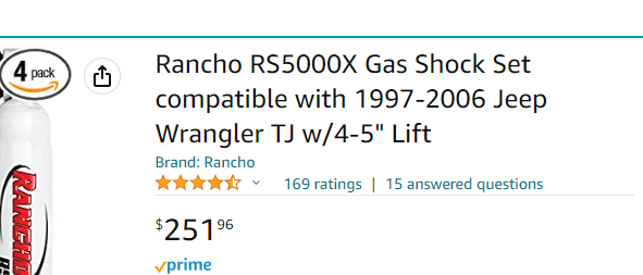

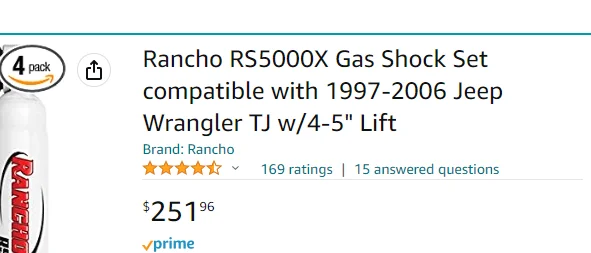

Do you recall with Rancho RS5000X part numbers that you went with?
Part Numbers RS55255 and RS55256
As I remember their range of motion in this application fit a 4" lift slightly better than the appropriate 9000X.
I can't say I've put them to the test but they sure ride nice with these spindly 4" RockJock springs. Amazon has them as a set for $251.

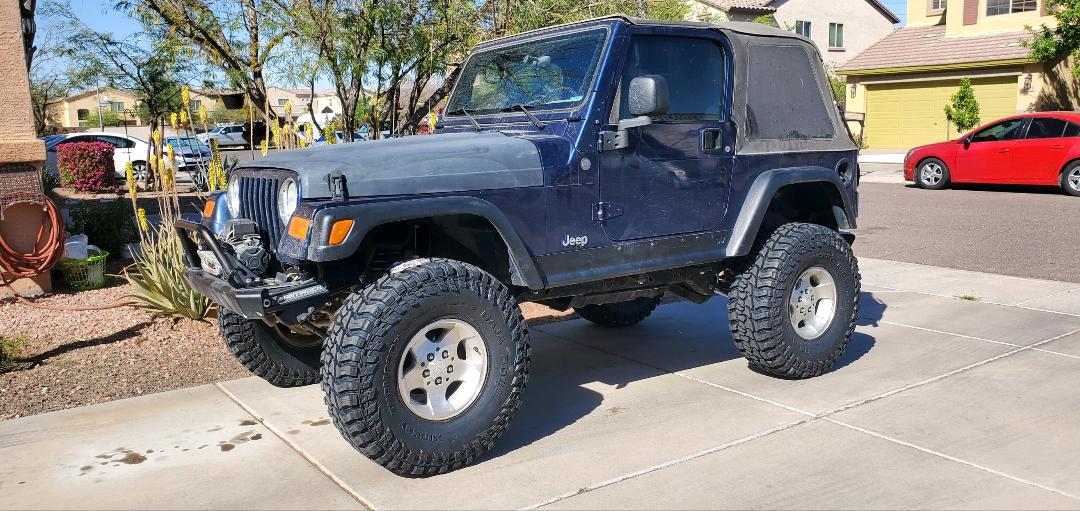

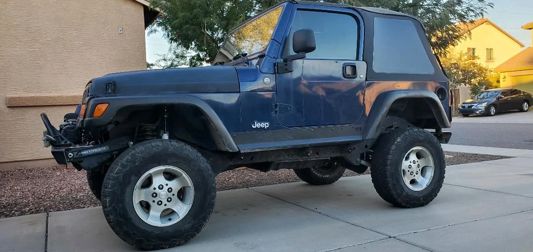

This is with the body lift while I still had 31" tyres.
Now with 35" tyres.

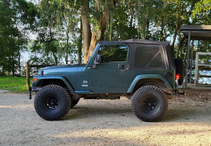

This is a similar pic after the 1.25 BL and MML install...now I gotta slip a Moryde tailgate reinforcement kit by the wife so I can get this giant spare tire out of the way :)
