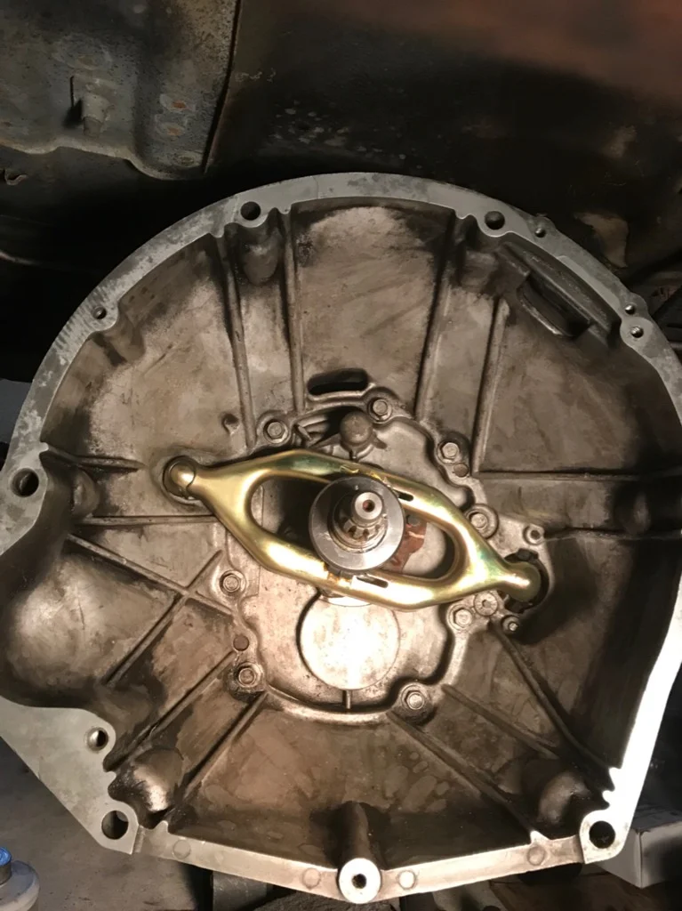

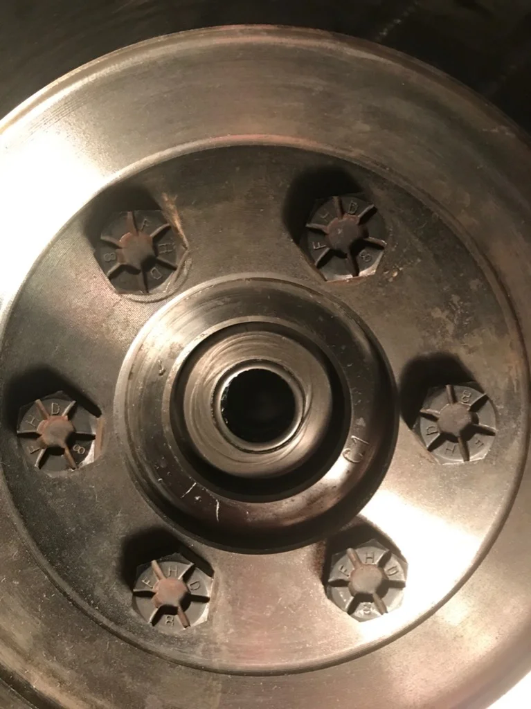

Finally getting around to replacing the clutch, ToB, fork, fork clip, pivot ball, and the pilot bearing. To remove the pilot bearing, I used the wet paper method (as seen on You Tube) and it worked like a champ. I didn't use the LUK ToB since it was a composite sleeve. I ordered a Crown Automotive one with a cast sleeve.

If you can get a bushing instead of a bearing you will likely get longer life. It seems it should be opposite but a pilot bushing seems to hold up longer than the bearing does.
