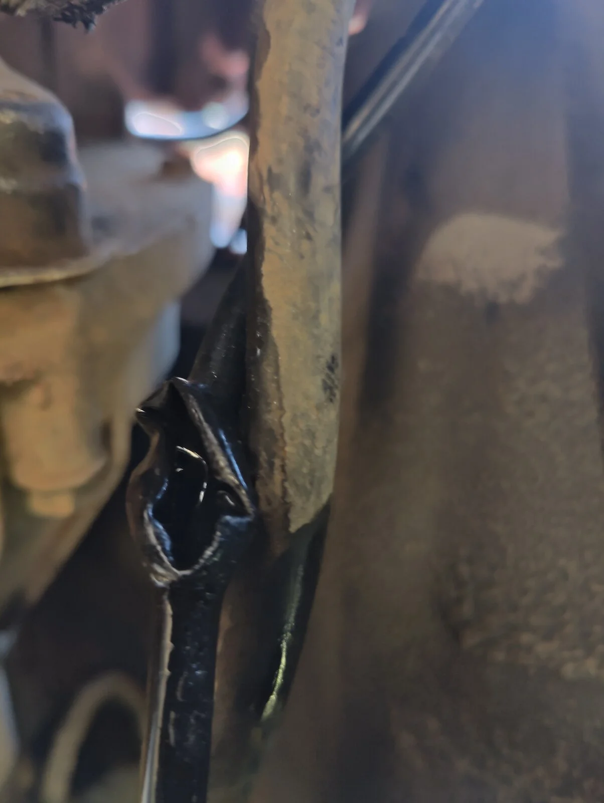

I burned a hole in my prebled Luk master slave on an epic 1600 mile road trip to Canada and back on the WABDR.
Only replacement I could find was a Duralast. It was pure shit. 4000 lbs leg press one second and slamming to the floor the next. Plastic cap shattered.
Put a new Luk on it as soon as I got home.
