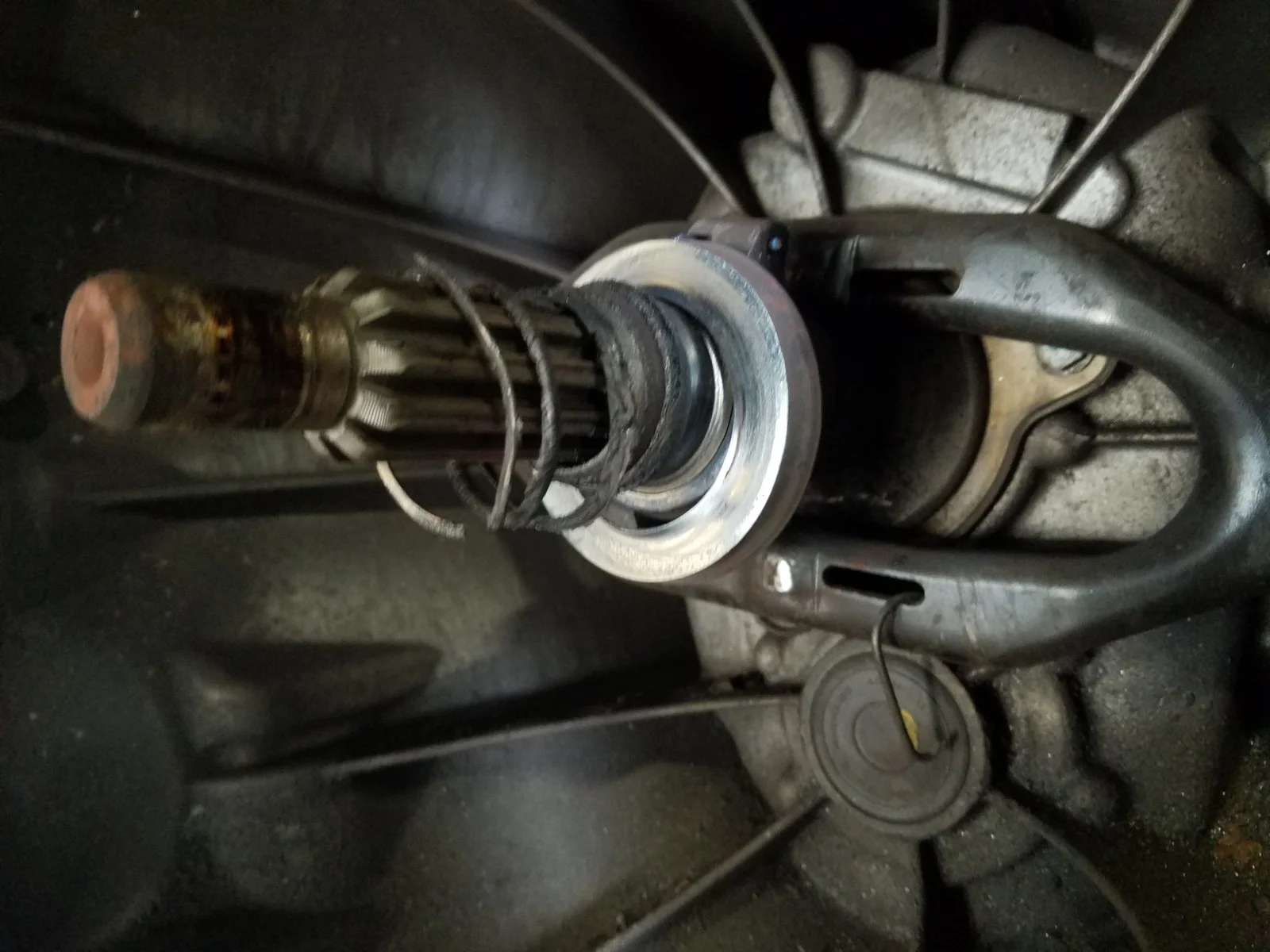

Not necessarily true. I recently replaced my clutch, multiple ppl told me it wasn't the throw out because of the noise when not pressing pedal. My bearing was wasted, somehow it was spinning at all times. Noise is gone now
