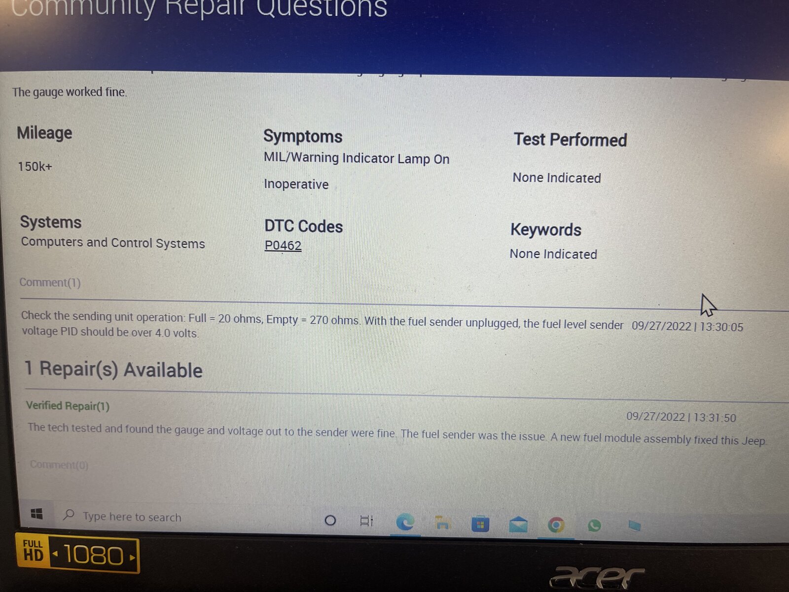

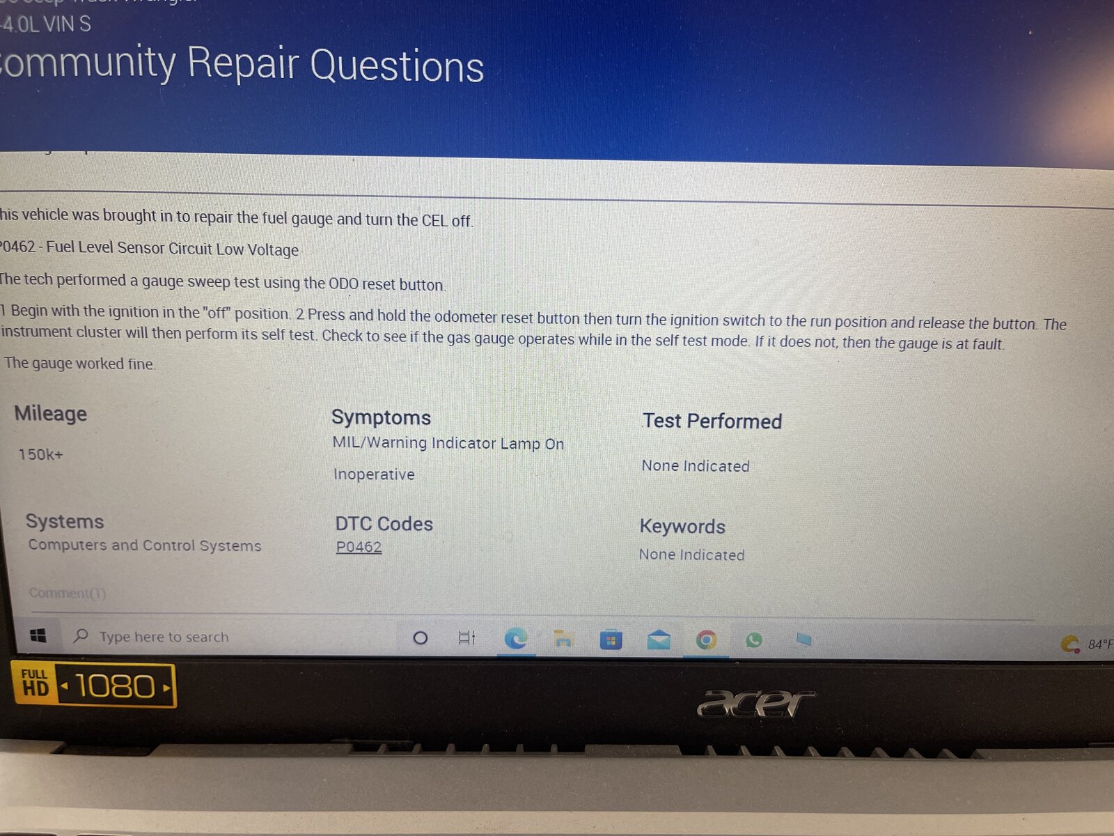

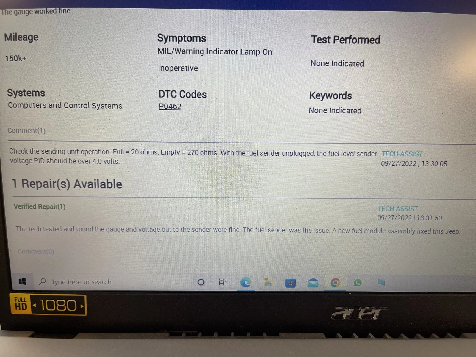

I have a 2005 Jeep Wrangler LJ, it has been throwing P0462. Replaced the fuel pump twice and it is still throwing that code. Jeep dealer and multiple shops say
The last one I replaced it with was a Bosche and still nothing.
I suspect it may be the sending unit?
Went over all wiring and there is no short anywhere.
Check your fuel level sensor
