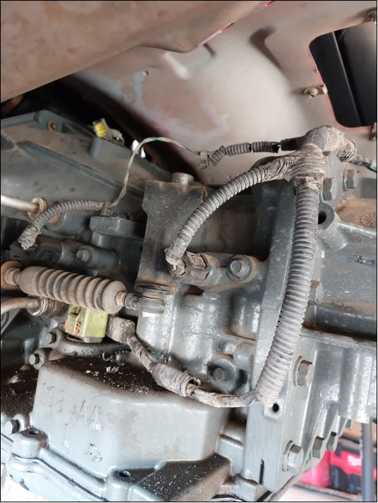

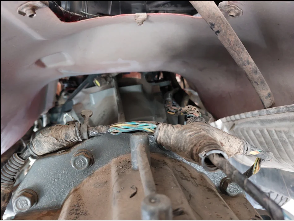

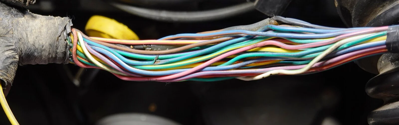

As luck would have it, we are working on one to install an Atlas. It is immediately obvious that the loom is in sad shape and the risk of a chafed wire is very high.
We pull the harness up into the engine bay to inspect and redo the loom on it. This is what your shop will likely find eventually.
