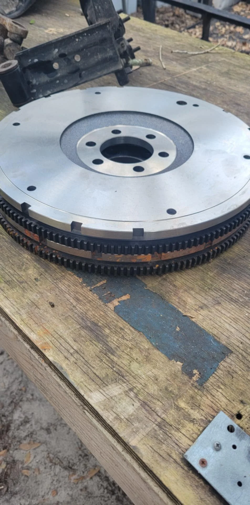

Ok boys, @RAM1488 was correct. So I appreciate the information @RAM1488 . If you look at the picture. The bottom flywheel "luk" is from Amazon and the top one from. NAPA"luk". The holes are lined perfectly and you see the notches are not matching up. My guess is if the CPS can't read it correctly it shuts itself off. My mistake is I didn't line it up from The one I removed originally. Just slapped it in like a idiot. Now runs perfectly 👌

I'm pretty sure, it has to do with the CPS reading the flywheel. But the science behind that. I'm not sure.
I just went through the same thing with my 04 TJ. Wound up replacing everything as well. I WILL NEVER BUY Another LUK Anything Again. In addition, I tried calling the Schaeffler(Parent Company to LUK) Customer Service Line and proceeded to sit on Hold for an Hour and 28 minutes before I gave up and realized they just don't care about the Customers. The Flywheel that I wound up replacing the LUK with is a Centerforce and it works and feels Great. Look at the Timing Marks on the side of the attached picture. They are Very Different. And that's what was causing the 0351, 0352 and 0353 Codes.
