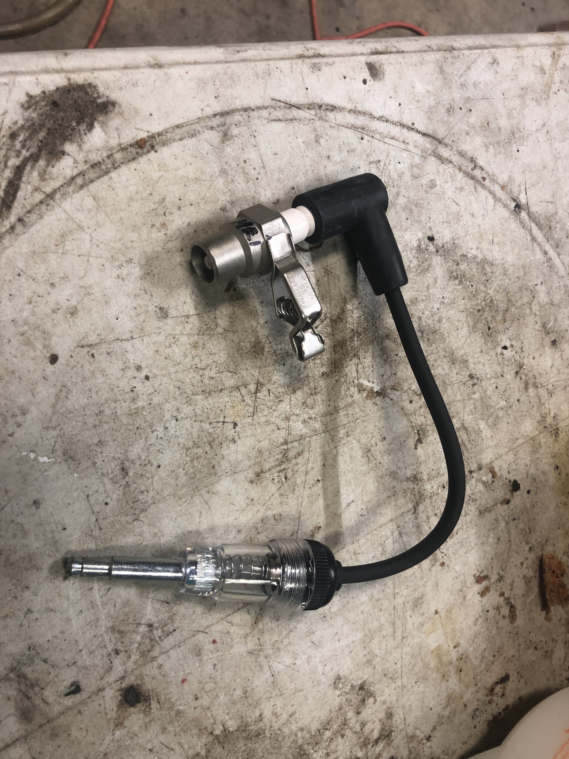

I used the setup below when I was diagnosing my P0303 code.
05. Plug it into the coil and ground the fake plug. Plug into coil and connect to plug to test plug. My P0303 code was caused by a failed plug.
