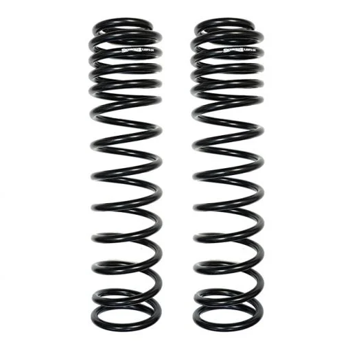

Love to see some pics when installed. So far all the 'dual rate' springs I've seen (far from all of them) sit with the top of the spring coil bound at ride height and only seem to come in to use when the axle is at full droop to keep the spring propperly located.
These Skyjacker might do the same thing.
Hell they might all be getting their springs from the same plant and slapping different names on or no name at all..
As you can see they look eerily similar with rock krawker and skyjacker having their name on it damn near the same location and metacloak with none at all. All powder coated black.
Coincidence or same plant? 🤔🤔🤔
