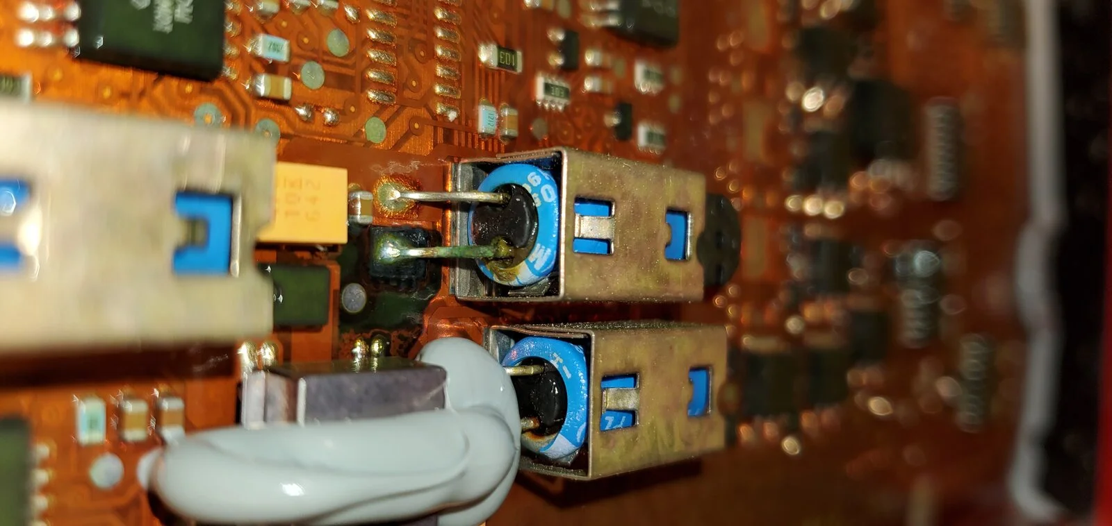

Received the remanufatured PCM yesterday and it works perfect.
I wanted to confirm my suspicion that it was a bad capacitor, and I opened the bad PCM and that is what it was. Attached is a picture of the bad capacitor. I'll see if I can find one online to fix it, and have a spare PCM for the future.
Thank you for your help!!!!!
Great news! Glad it worked out for you. I am sure my old PCM also has a bad capacitor. If you are able to repair yours, please post an update. I may try to do the same just to have a spare for the future.
