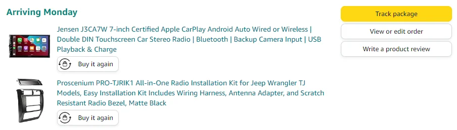

So I just ordered a few things from Amazon for the LJ that I always wanted in my previous TJ.
Jensen Double Din w/ Wireless Carplay + Install kit.
In my dealings with car audio, I've never been the biggest fan of Jensen.
So i'm quite hesitant on whether or not this head unit is worth the $220 pricetag.
However, In my vehicle previous to my TJ I had a $500+ Alpine Carplay unit, and that thing SUCKED.
So as long as the Jensen can prove equal or better performance, I'll be a happy camper.
