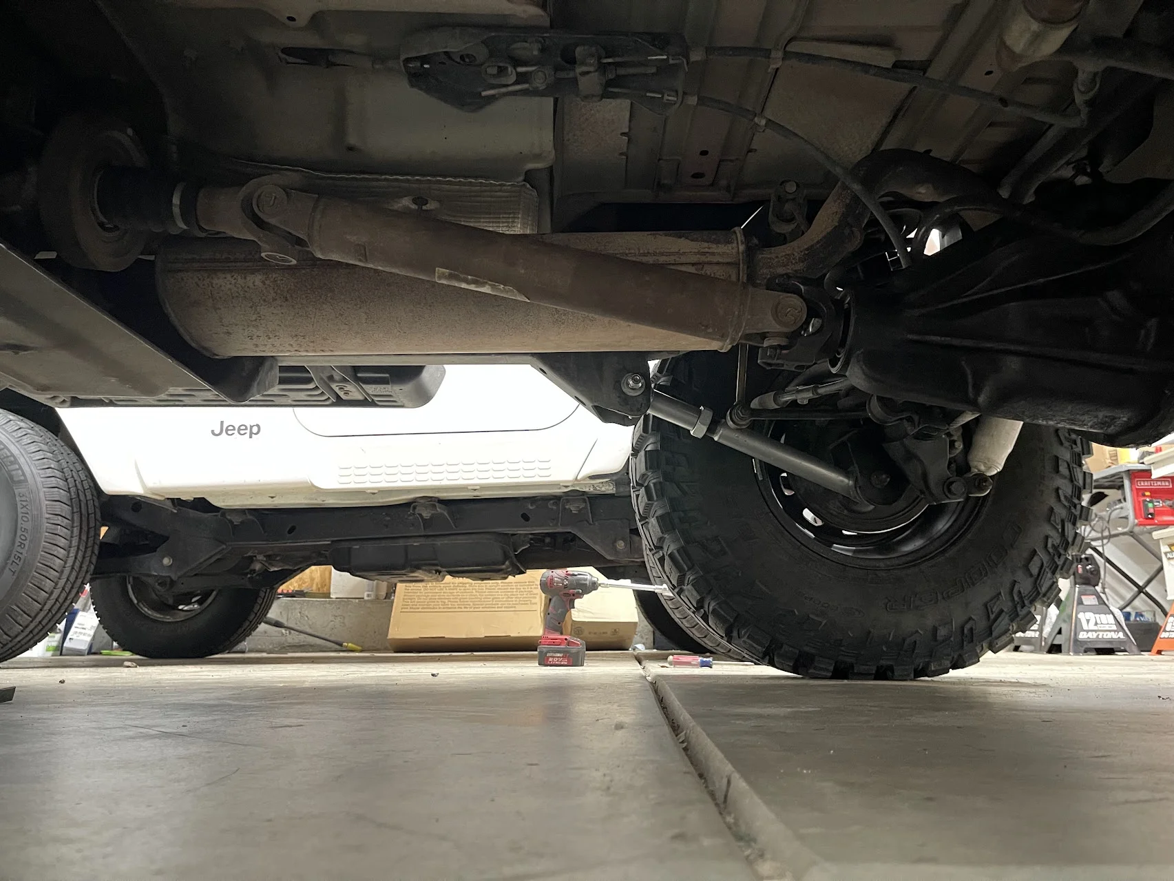

Another issue I'm running into involves pinion angles.
I stated the other day that everything was "good" but I've got drivetrain vibrations.
Vibrations don't start until 65mph, but are the text-book "vroom-vrooom-vroooom-vrooooom" drone noises of a vibrating driveshaft.
I crawled underneath the rear of the Jeep, and measured the output flange of the transfer case, as well as the rear pinion angle.
Transfer case output is 7 degrees, and rear pinion was 12 degrees.
Since i have NOT installed an SYE, I am still on the factory driveshaft.
So theoretically my pinion angle should be matched to Transfer Case angle.
The issue lies in the fact that I've got the rear upper control arms adjusted as short as they will go, and reduced some of the pinion angle.
My rear upper arms are now at their absolute SHORTEST length possible, and the pinion is STILL sitting at 10 degrees (3 degrees more than Transfer Case).
The vibrations might have gotten a bit better, but it could also be placebo effect, as they're still noticeable at speed.
So I believe my only option is to lengthen the lowers by a few turns, to account for the extra angle I need to pull out.
This in turn will push my axle back slightly, which will push my bumpstops slightly out of line with each other.
The bumpstops are almost perfectly aligned as of right now, but I'm sure to get the extra angle out of the pinion, they will ultimately only sit about 1/2 way centered on the bumpstops.
I'm not knowledgeable enough to know whether this is an 'okay' move or not.

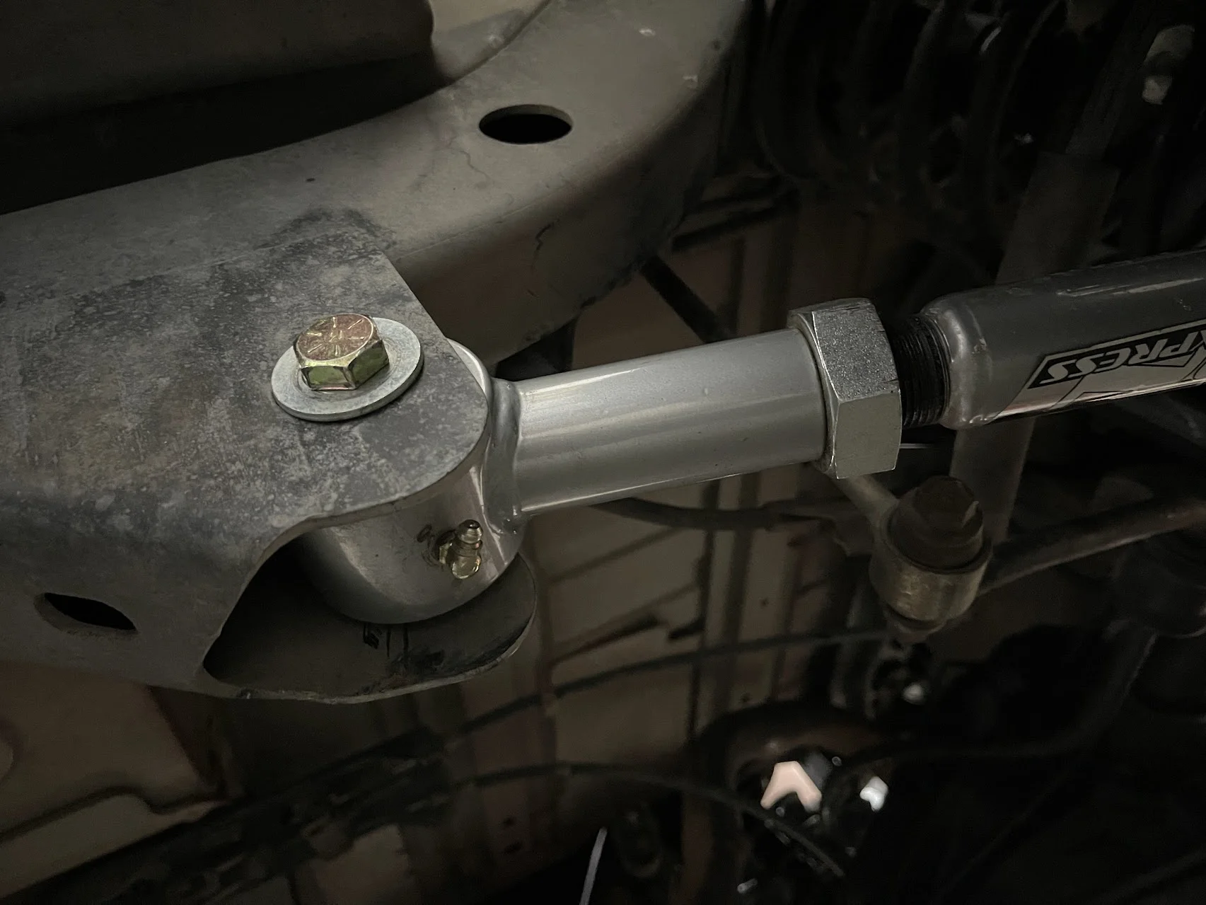

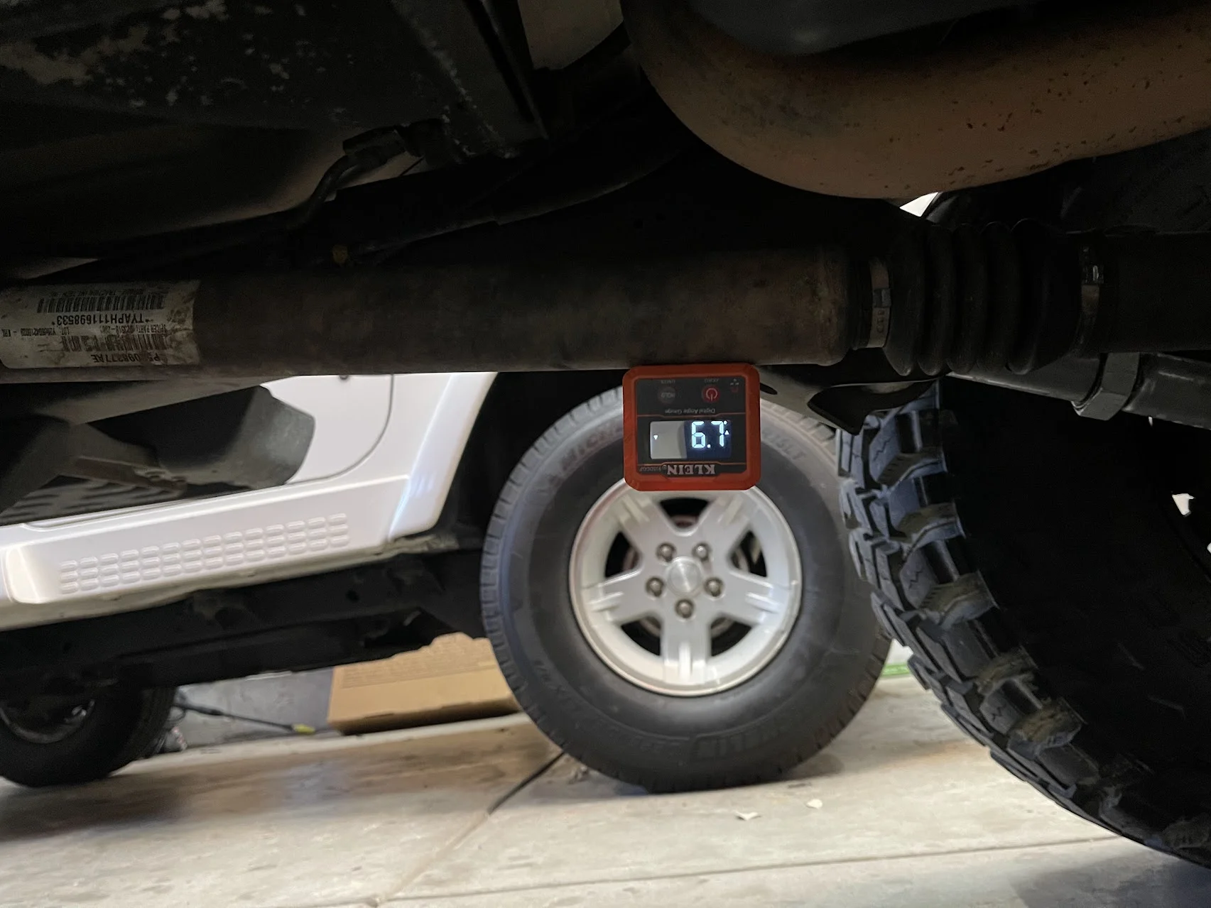

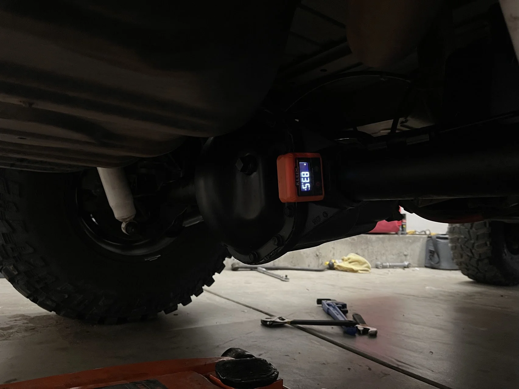

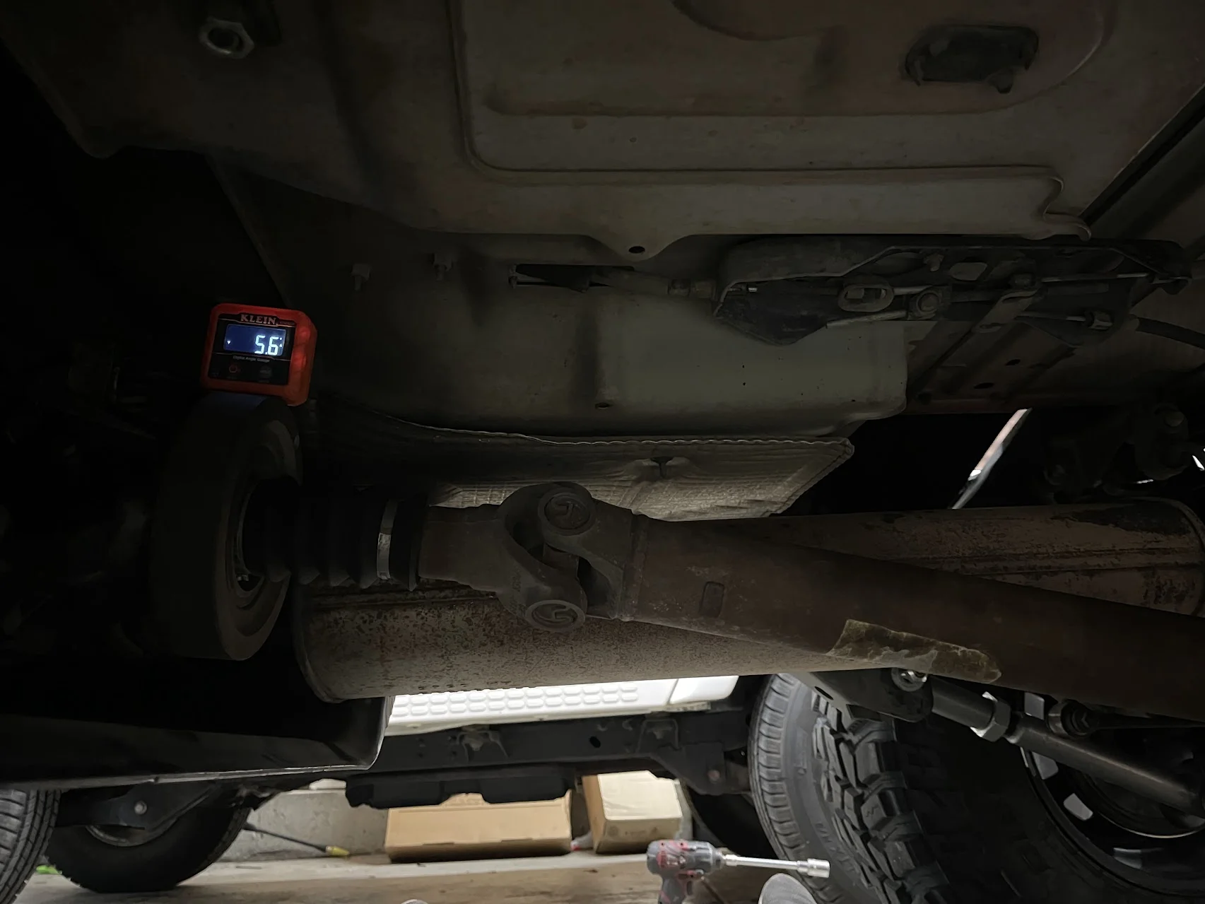

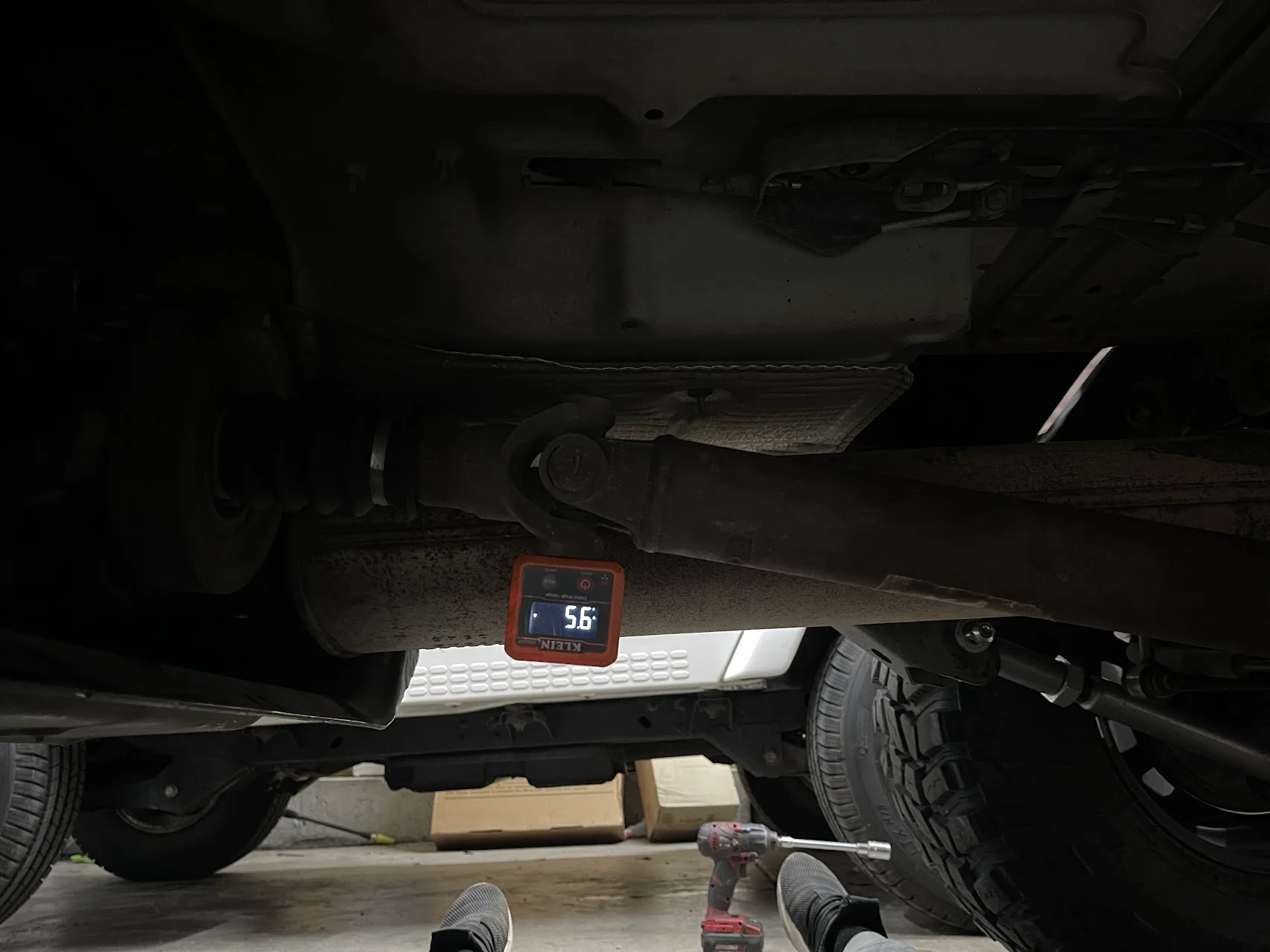

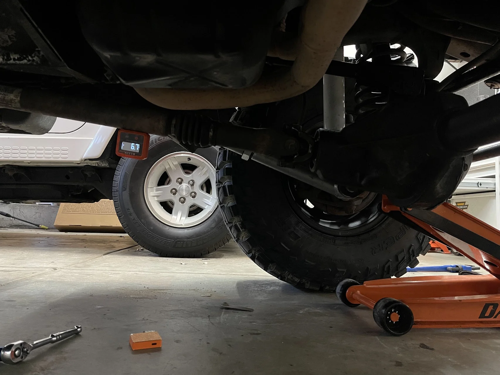

Spent some time in the garage this afternoon playing with my Pinion angles.
Ended up adjusting 8 turns out on my Rear Lower Control Arms, so that I could actually utilize my Rear Uppers
(yesterday the Uppers were maxxed as short as they could go)

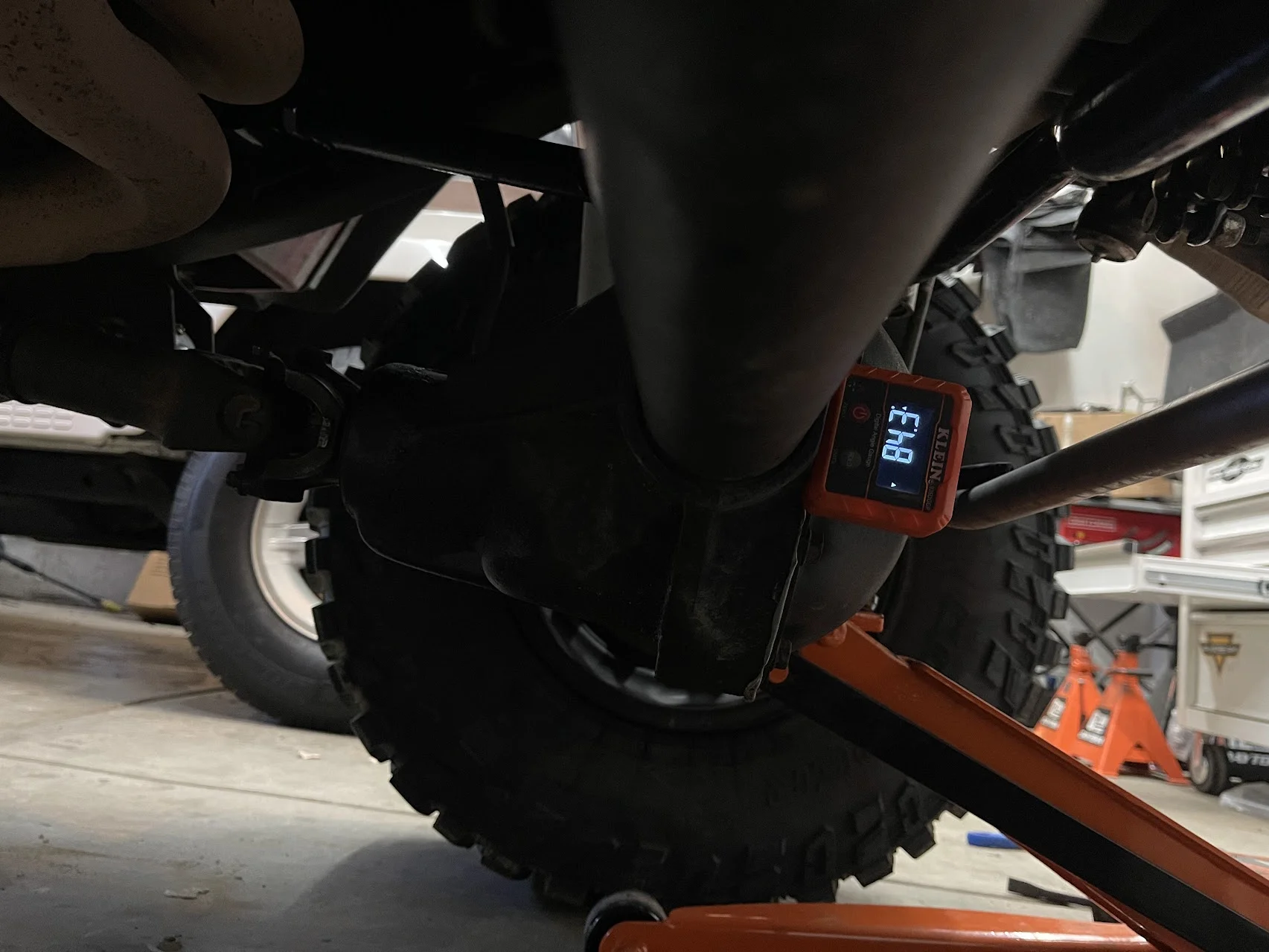

Here's a photo of my rear pinion angle. Roughly 6.5 degrees.
As well as my rear Transfer Case angle, measured from two spots, at 5.6 degrees.
Rear Pinion/Transfer Case angles SEEM to be correct.
(although I'm learning what I'm doing, so I could be botching something completely...)
Also adjusted the front to what I THINK is correct...
5.7 degrees on the front pinion
Followed by 6.7 Degrees at the front Driveshaft.
Ultimately, I fixed NOTHING.
The vibrations are STILL there at 65mph, and got no better/worse.
They're the same as they were.
At this point, i'm just uber confused.
With the LJ having the longer rear shaft, I wouldn't think I should be having issues, given the angles of everything.
Nothing is at an "extreme" angle.
I'm thinking it's time I take this entire conversation to a thread of it's own, and let the big-boys duke it out with solutions/theories.
I'm planning to go to Lowes tomorrow, to pick up some washers, just to see if that possibly can cure some issue.
Just not sure where to start, am I putting washers between frame/skid to lower the TCase, or am I putting them between Tcase and skid to raise the TCase?
Any further insight is appreciated! :ROFLMAO:
Try something, anything…and don’t puss out and use like two washers or something silly. Get yourself enough to raise the tcase or lower the skid 3/4 an inch or more. Also, only change one thing at a time. You charged the rear and the front at once. You might have fixed one problem and introduced another.
Pull the front driveshaft out entirely. See if you still have vibes. If you don’t, you’ve just narrowed your search down. Unfortunately, I don’t think you can pull the rear D/S with a slip yoke without puking your tcase fluid everywhere.
At this point, I'm willing to try it all, whether that be the 'washer trick' or a full blown SYE/Tom Woods in the rear.. :ROFLMAO:
The plan in the morning is to pull the front driveshaft entirely, and take it for a spin.
Swing by lowes, and grab a big stack of washers while i'm at it. (if needed)
I'm HOPING that by eliminating the front completely, I can at least solve SOME of the issue, at which point i'll dial the rear to no vibrations, and then focus again on the front.

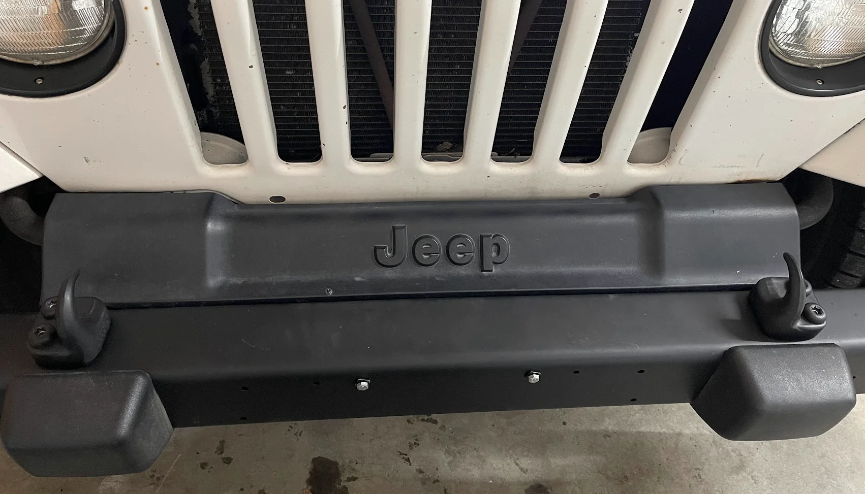

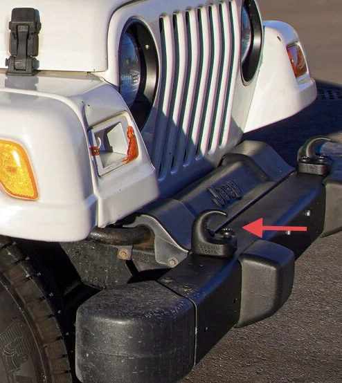

The busted marker lens doesn’t bother me too much, but you gotta turn those tow hooks around. Also, both front bolts looks loose. Sorry to nit pick, but they are in about 7 pictures.
You guys and my damn marker lights/tow hooks. :ROFLMAO:
That was my lack of paying attention while swapping the bumpers around.
I put them on backwards, realized it, and stopped working on it before flipping them around.
They're now both corrected as of 2 days ago.
I have to update photo's tomorrow at some point anyways, because for some reason Facebook Marketplace doesn't allow full-resolution 4k photos, and instead decided to downscale the 20 uploaded photos into some kind of blurry 2000's era looking mess.
So I plan to go to the same spot tomorrow, take new photo's, and update.
But also, In my opinion...
If someone wants to haggle around about backwards towhooks, id rather send them on their way and save their time as well as mine.
