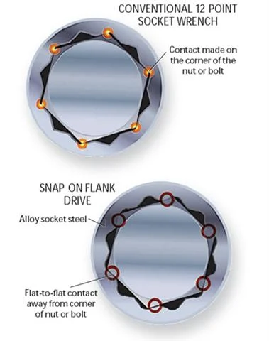

No, 12 point are not better than 6 point. I did 6 point Metric and 12 point Imperial just to make the choice obvious.
SnapOn Flank Drive explained.
Believe me, 45 years later it works. You get what you pay for.
You will love how snug they fit everytime you use one.
12 point, 6 point is not an issue.
79211

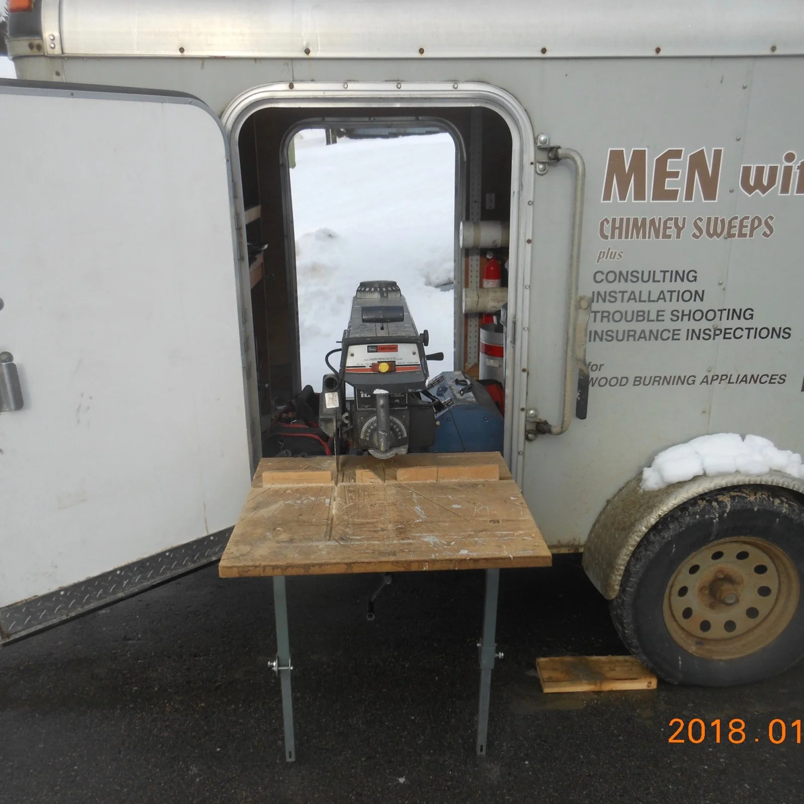

I really miss Sears and Craftsman. Best radial arm saw ever. Mine is 40 years old.
79231
