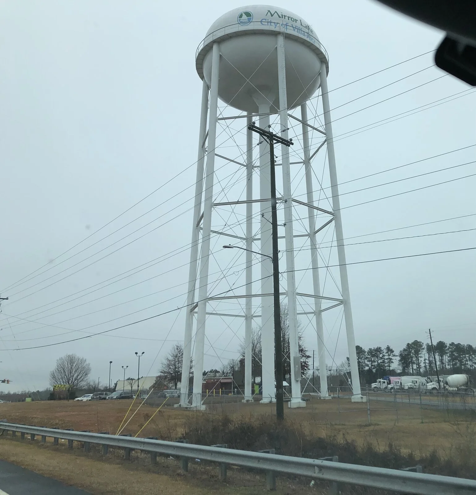

What’s the location of the existing repeater? The ones around me are on water towers and are difficult to get to.

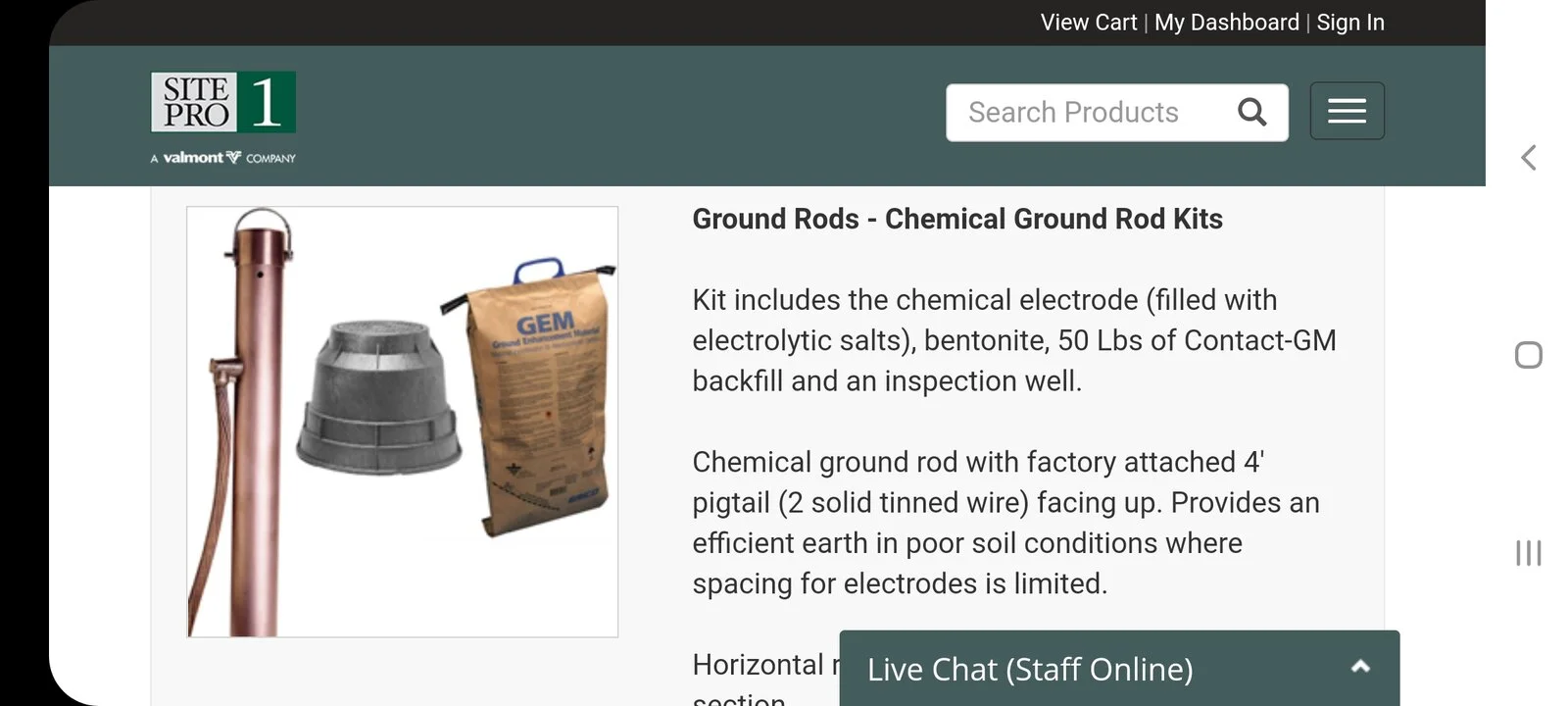

What is the advantage of a chemical ground over a ground rod, delta ground, or even a ground ring? Serious question. I’ve never seen a chemical ground.
Correct, A large ammo can would be about the size. Or maybe a medium pelican (1500) size would be a fair comparison for size.

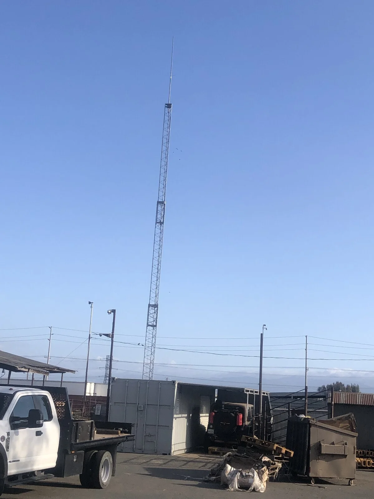

It is on a crank-up and tilt over tower. No water at or near the site. What is a water tower?
From the website:
It maintains a low ground resistance, maintenance-free installation that dissipates lightning energy and other dangerous electrical fault currents, even in sandy or rocky soil conditions. The chemical ground electrode is useful for providing an effective earth in poor soil conditions
  • Contains natural electrolytic salts, which permeate into the surrounding soil to condition the soil and increase its conductivity

From the website:
I thought it might be something along those lines but wanted to verify first.
As far as I know the National Electrical Code doesn’t approve the use of chemical grounds, ie rock salt or similar. It dissipates and all those benefits fade away. We’ve been using metal rods for a long time and they work pretty well, even with lightning strikes if the structure has a lightning protection system.
Would you mind shooting me an actual link? I’d like to read up on that product some more.
Ahh, the repeater owner rents a spot on top of a “water tower”. Not many of those around the inland empire. We rent spots in mountain tops.
We have repeaters on mountains too. The water towers are great for local access. Some clubs even have them on actual towers. Where there’s a will there’s a way and all that.
Most chemical grounds need a periodic servicing. Some may say they don't.
Below is just one product. Google chemical grounds.
https://www.sitepro1.com/store/cart.php?m=product_detail&p=248
That may solve some of my other grounding problems. One of my buildings looses neutral in the summer and I have to soak the area around the rod with water to get the ground working. We are in loom, which dries out quick.
It probably will. The chem grounds we had at our buildings needed some servicing. I think it might have been every 5 years.
