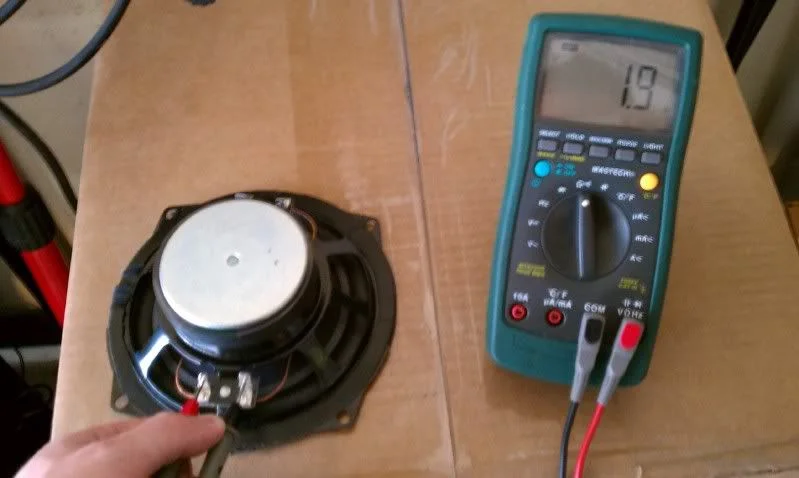

Suppose if I hooked up an ohmmeter between two positive speaker outputs on the factory amp, it should be an open circuit if there are two channels and no almost no resistance if it is mono and the wiring is parallel?
Is there a way for me to definitively measure the stock setup for how many ohms the stock sub voice coils are?
The stock subs you can use an ohmmeter but it is 1.9 ohms per coil. Here is a picture from another thread. I believe the first post on this thread goes over it. What are you trying to accomplish here?
