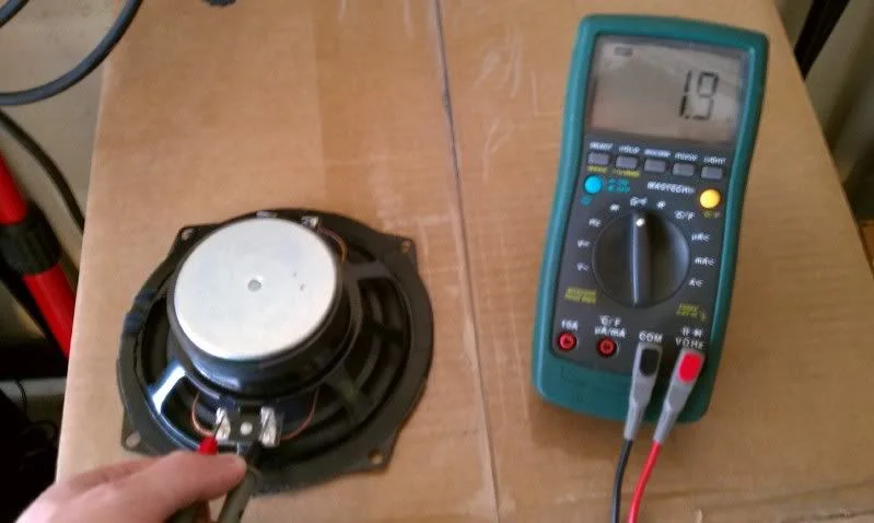

The stock subs you can use an ohmmeter but it is 1.9 ohms per coil. Here is a picture from another thread. I believe the first post on this thread goes over it. What are you trying to accomplish here?

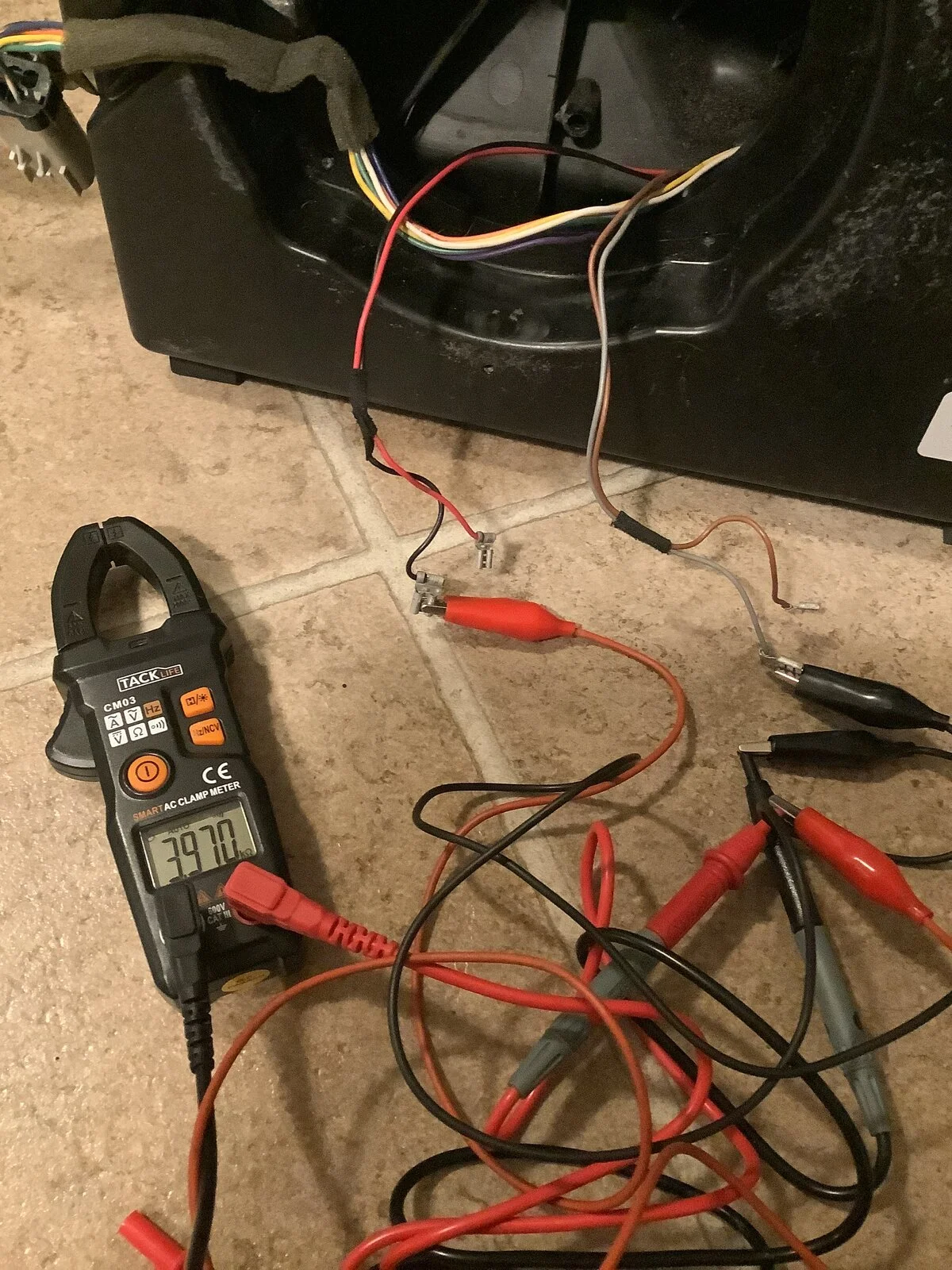

I just checked the speaker wire outputs of the factory amp and getting ~ 4,000ohms - almost open circuit, not connected to each other. That leads me to believe they are not wired in parallel. Looks to be a 2-channel amp driving 2ohms each based on that and your photo. Is that wrong?
Re: that photo - Jerry said you can't measure speaker (AC) ohms with a battery powered (DC) meter? Erroneously low reading?
Edit to add photo
Edit to add photo
That makes sense if the amp is two channels, 2ohm at about 40 watts, making the stock sub a 2 ohm DVC at about 80 watts.
At the end of the day, that stock amp is not very powerful and if you have room in the budget and time in your schedule, you should add a mono amp to power that Kicker woofer, or grab a five channel amp to power the sub and four corners.

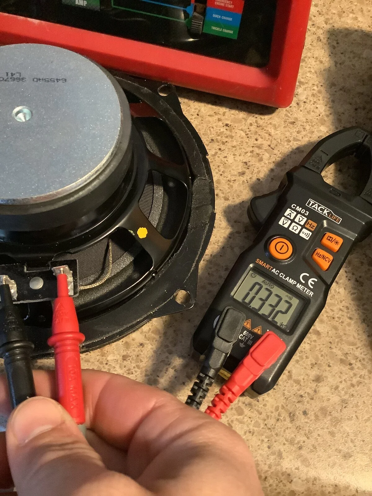

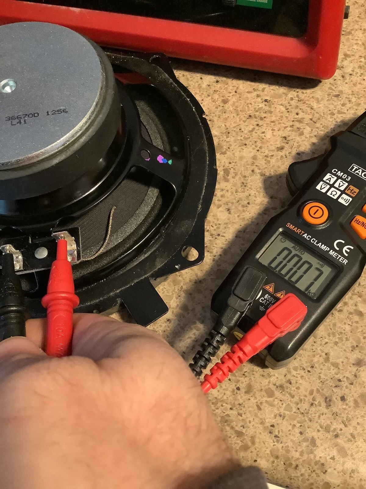

I obtained a used factory subwoofer speaker. I haven't tested it so I'm not sure if it works or not but this is weird...
One voice coil showing 7ohms and one voice coil showing 332 ohms.
It could be blown, bad connections within the speaker or a bad connection with the multimeter.
Tough to say, and I don't have my subwoofer speaker anymore but I did test the 5.25" front which are 4 ohm, but you can see a bad connection can lead to a wonky result.
