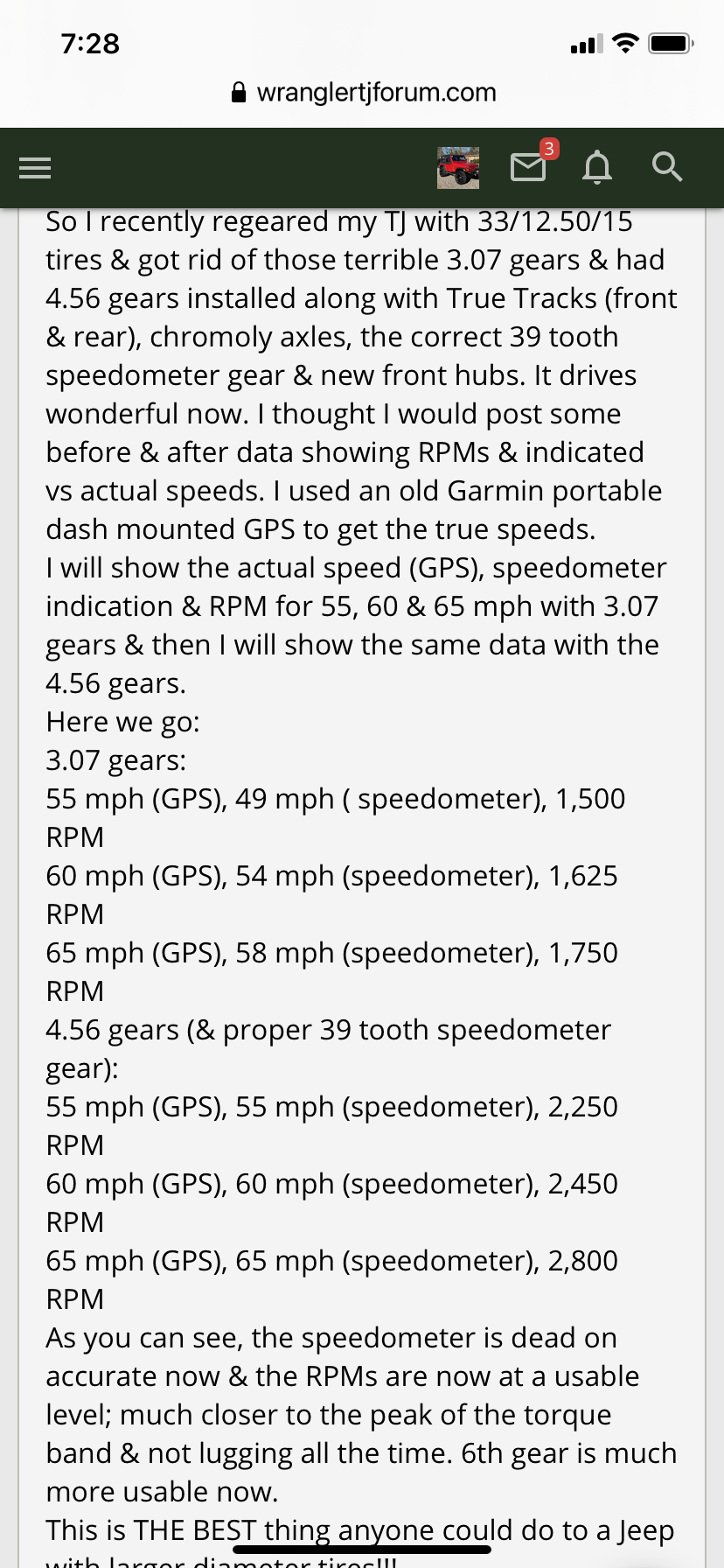

This “before & after” data should confirm if your current gears are 3.07 & also what 4.56 gears will do for you. You just need an old portable GPS or maybe some kind of phone app that does the same thing. Freeway mile markers coming by at a mile per minute is also 60 mph.
Personally, If I were going with 31” tires I would use 4.10 gears, but that’s just me.
While the gears are being changes it’s a great time to also install chromoly axle shafts & either lockers or limited slips. Doing that at the same time will save a lot of labor costs.
Good luck!
If that's accurate, it can't possibly have 3.07s
That’s an assumption. There are plenty of folks out there who have 3.07 and say it’s just fine. You or I would never say that, but we’ve driven other setups. He’s only going 55 and he’s leaving it in 4th. Chances are he has 3.07 and just hasn’t pushed it enough to realize the deficiencies. While 3.07 certainly sucks, it will still roll and to someone who is new at Jeep ownership, may not be that bad in their perspective.

Did you ever use GPS to verify your actual speed and what rpm you're at at each speed? How did you confirm you have 3.73?
