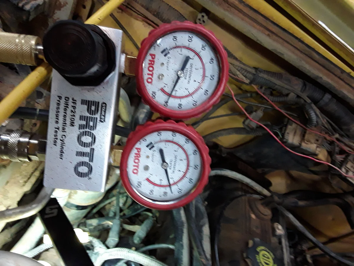

Did a leak down test today, not looking good.
