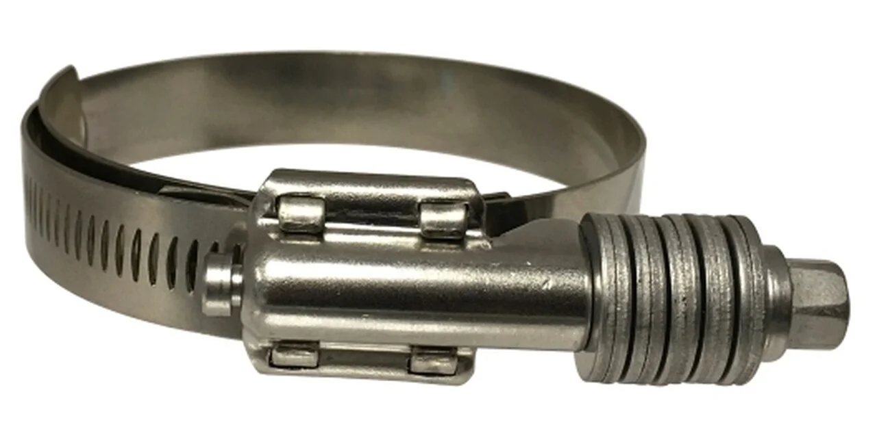

I'm looking at using these constant torque hose clamps on my rad hoses since the prior owner had those worm gear type. Should I have any concerns with these? Any lessons learned worth sharing? Thanks in advance

I had worm gear clamps on mine for a while. when the temps would fluctuate between warm/cool in the fall and spring, I’d get small leaks. I replaced them with the kind you posted. No change, still had small leaks in those situations.
1year ago I rebuilt my entire cooling system and went back to the constant tension clamps that came on it. No leaks this past spring or this fall.
X100 for the OEM style constant tension clamps. Only thing you should use on the cooling system hoses (well, that I know of at least).

You can use it but nowhere near necessary.
Simple spring steel tension oem style is suffice.

I'm using them for going on five years now because the spring steel style clamps weren't readily available at the time.
You should be looking at constant tension clamps.
those are constant tension clamps
