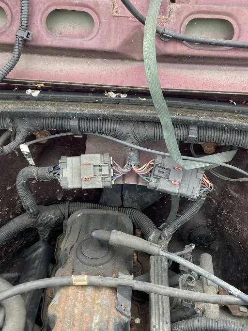

Inspect the wiring harness? Especially the notorious spot on the back of the engine where it's anchored with a stud?
