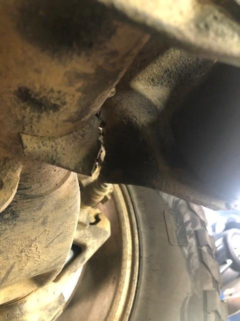

While my lj was in the transmission shop they found this nice crack in my passenger front lower control arm mount. They did a great job of welding it back together but I’d like to replace both of them regardless. I’ve ordered new brackets and the control arm skids. I would call myself a competent welder but I keep reading mix things about whether or not you need to prep (heat) the axle. There’s plenty of threads on here about the bracket to use but I cant seem to find any tips on prepping the axle. Welder is a 220 Miller.
Thanks
You can weld directly to the axle tubes without any issue (no preheat). The pumpkin is a different story since it's cast.
Reactions: MeanGreen86
Thanks
Burn it it..no problem at all. You might want to stitch weld, just to keep the heat to a minimum so your axle tubes don't turn into pretzels...
