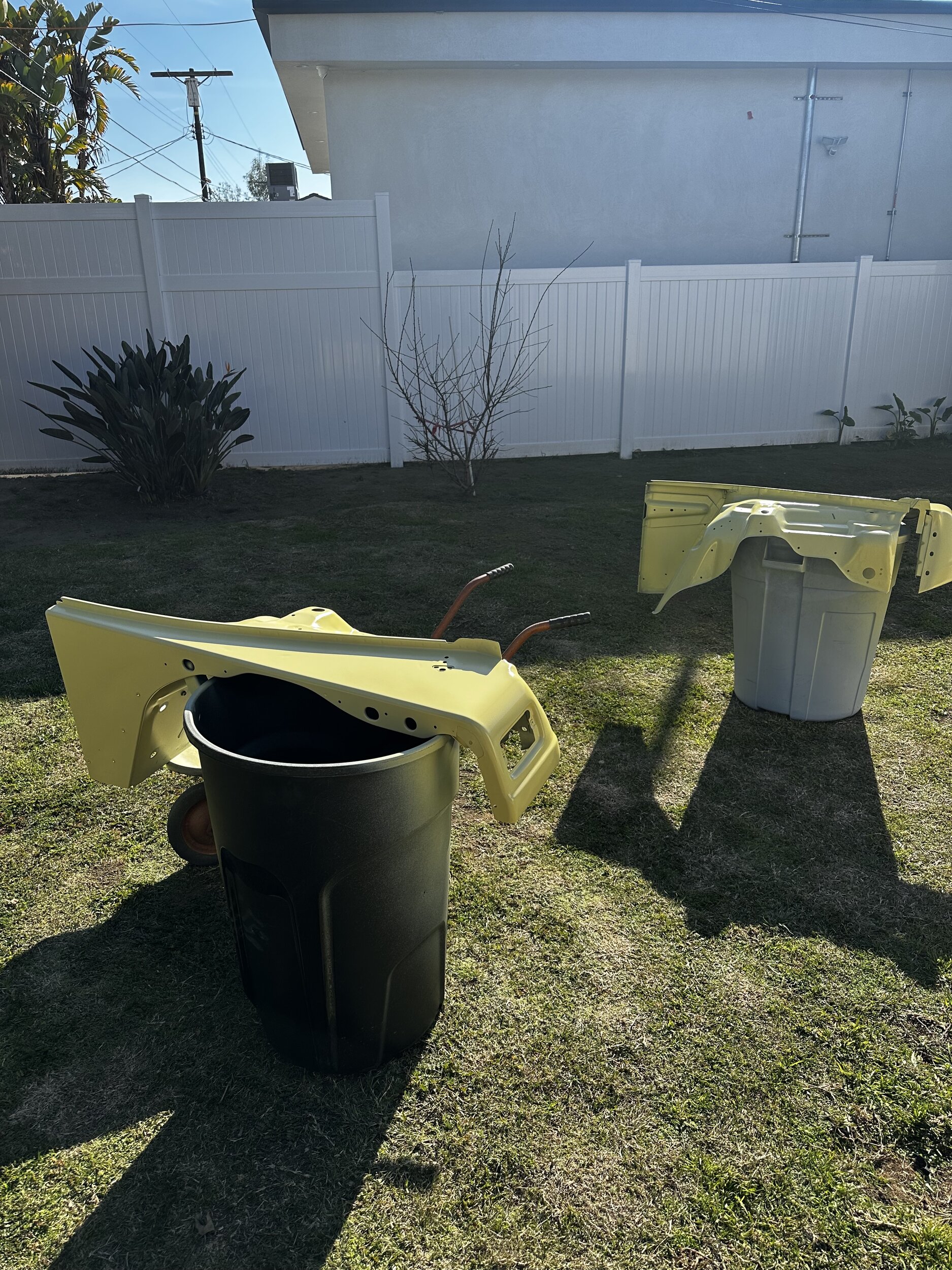

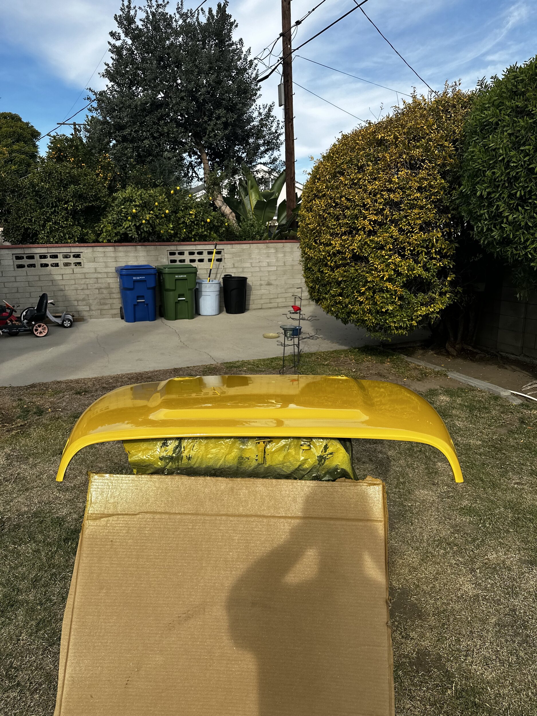

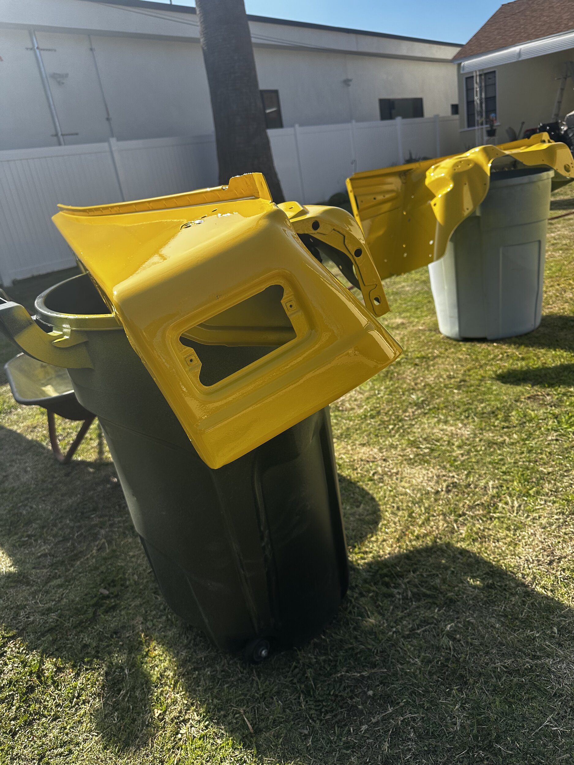

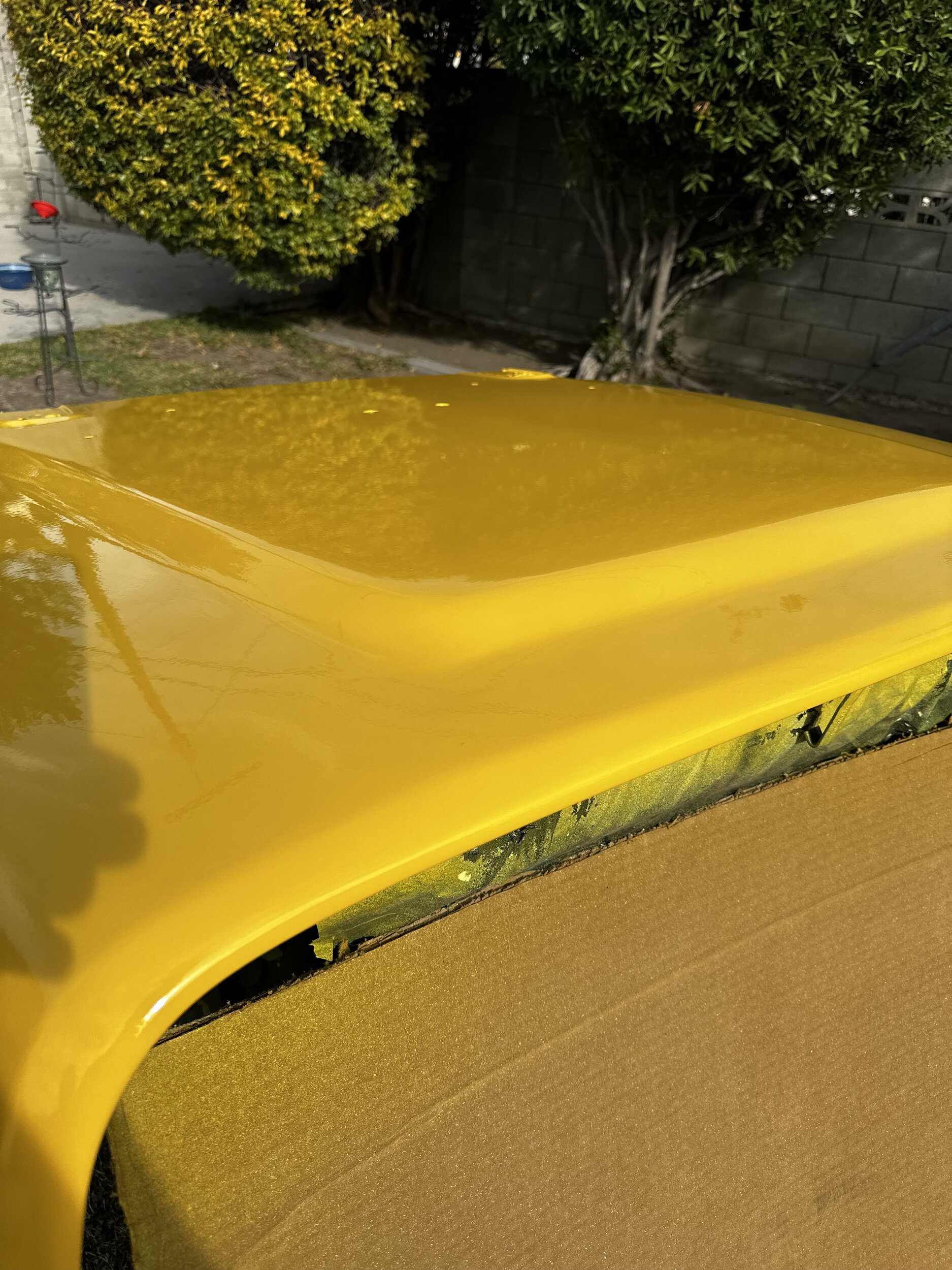

Funny enough I’m repainting my whole Jeep.
My recommendation is too find a local auto body paint supplier and have them match your paint by giving them a part of your Jeep. Then they can give it to you in a can or whatever.
We have an auto paint shop here in Hollywood that has given me great stuff.
They matched my faded paint 100%. But after getting into a small accident I decided to do a full repaint with the original factory yellow. Not the blended faded yellow.
Here’s some pics
They also give me a 2k spray can if I ever need to touch up.
Now the difference between my new paint and old is that mine is single stage. No clear.
This makes repair jobs sooooo easy. Light sanding and spray and it’s like brand new.
The single stage is not as super glossy but it’s still very glossy
