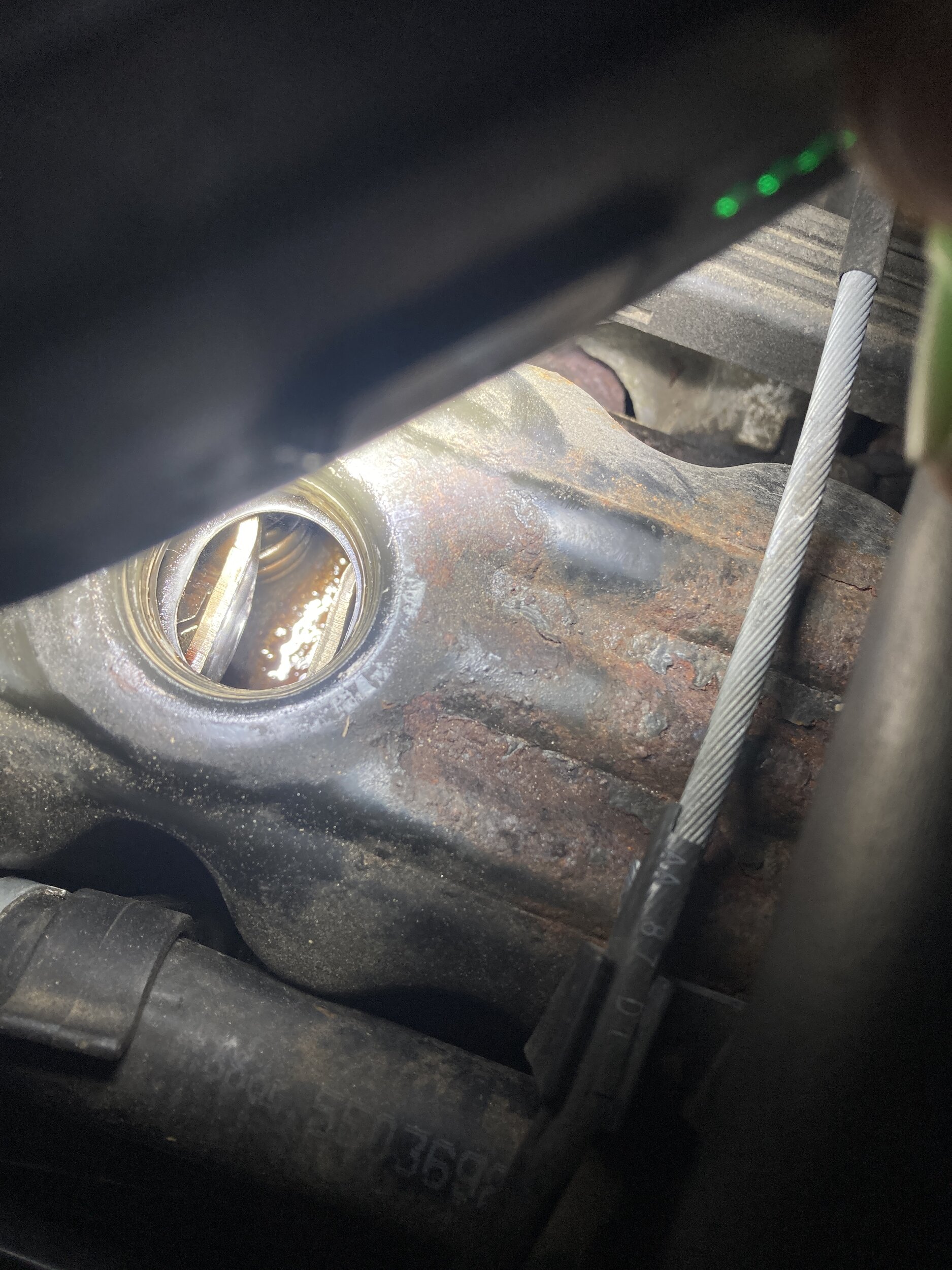

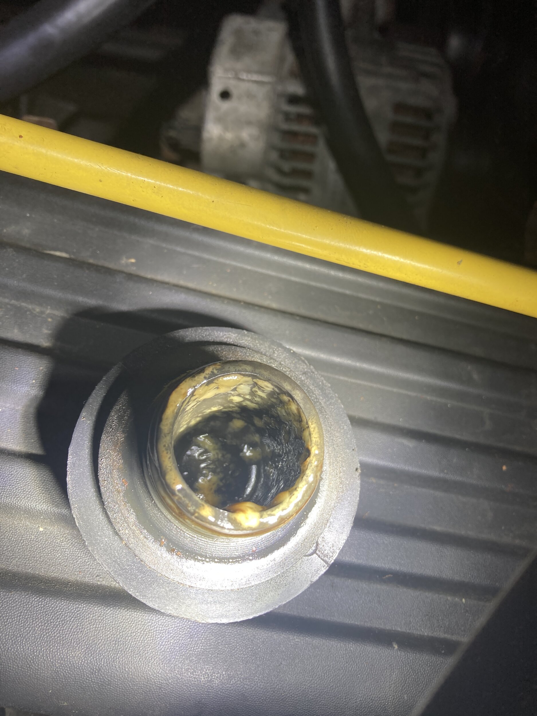

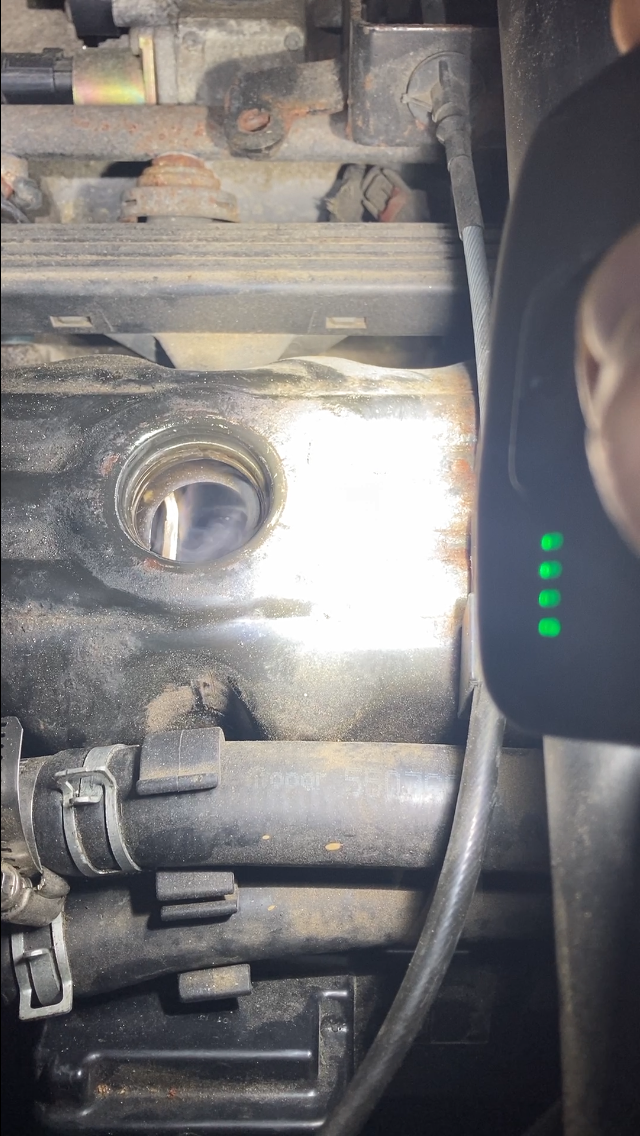

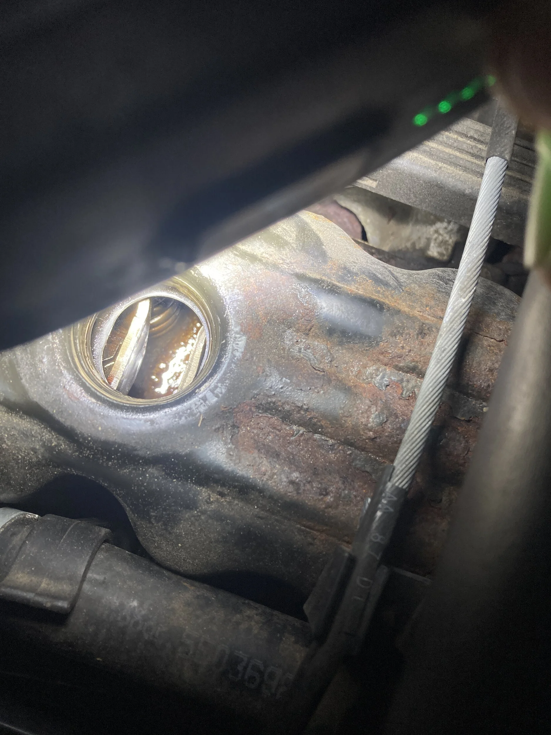

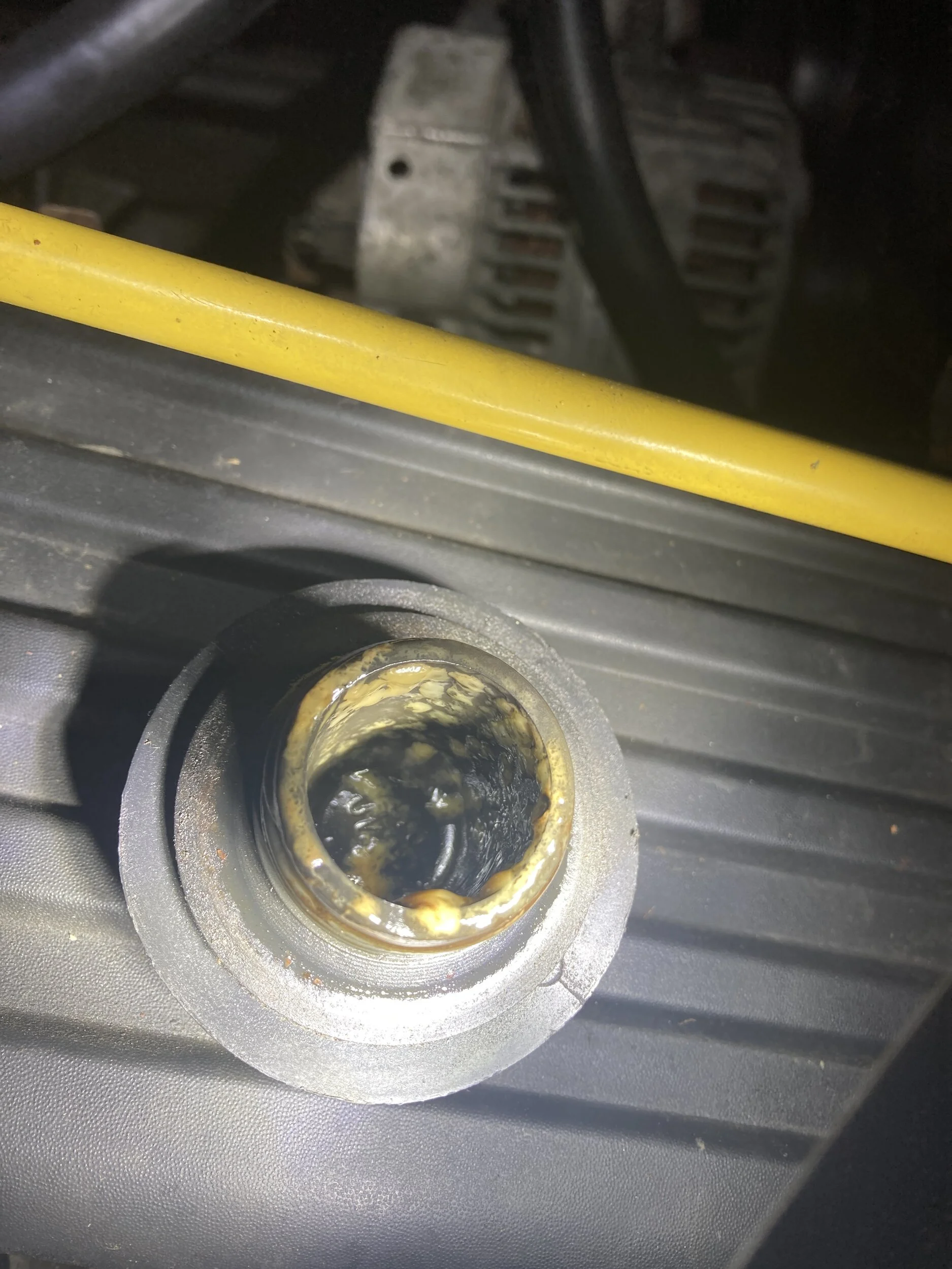

It appears that I have a cracked non-TUPY head. Removing the oil filling cap revealed some milky buildup that I hadn't been seeing when checking the dipstick. I let it idle for 10 minutes, sit for 5, then opened the fill cap to find a lot of steam(?) wafting up from within the valve cover. Wiping some of the oil away from between the valves made it more apparent that coolant was sweating from a crack. Thx for the guidance everyone!
