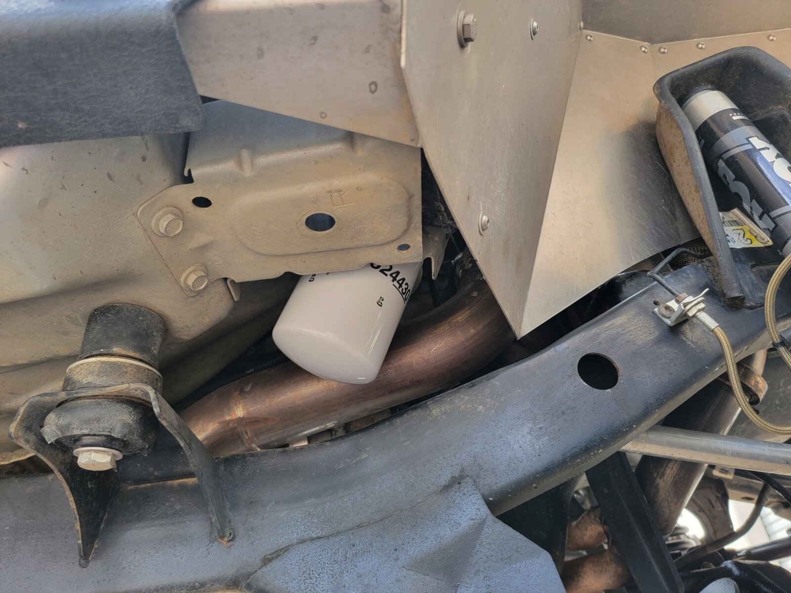

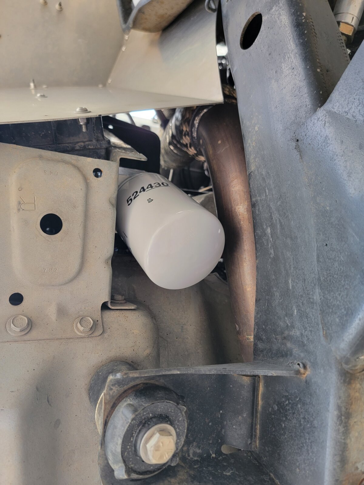

A couple of pics of the filter installed. Between the filter and the lines it probably holds an additional quart of coolant. I placed it lower than needed to get the base of it in the slipstream under the inner fender. When my new engine is done, hopefully in a month or so I am going to wrap that downpipe down past the starter. That should help for heat as well.
KingCarGuyZ
Feb 26, 2020
1,460
Dallas, TX
That’s pretty slick, what all did you use for the install? Kit or did you have to piece mail it.
OP
Jezza
Jezza
Jan 7, 2021
1,030
DFW Texas
I make the filter bases here. Actually it is the same base that I make for the remote trans, fuel, and coolant filters. The only real difference is the filter stud threads. The rest of the lines and such I just pieced together.

No concern about a rock getting thrown at it and punching a small hole in it? Seems vunrable in that spot.
I suppose you could get one up there. I could mount it up higher, or do a skid. Probably not an issue for what I do.
