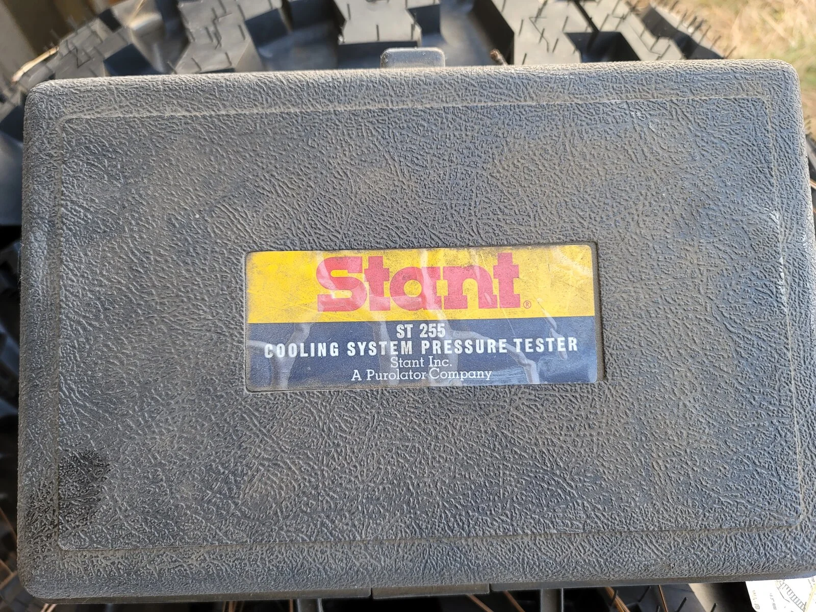

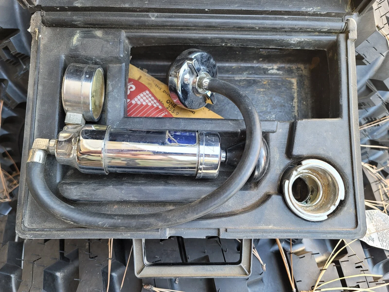

I rented a tool two days ago. I literally tried O’Reilly, Napa and got nothing. Advanced Auto had one. When I got it home none of the adapters fit (there were 20 adapters and 3 universal). None of the universals worked either. Either too small, hit the fins, or too big. I had to wrap some thread tape around the one that hit the fins to get it to work. Required two people. One to pump and the other to hold it on so we could get up to 18psi. Pain in the neck.
The dye is probably a better route.
Further, none of the adapters for checking the radiator cap fit either. IDK if this is the new norm for radiator cap sizes, but the ones that would fit our radiators and caps were all way too small. The vast majority of the caps were those that screw on the reservoir tank. I think that’s the most common way it’s done now.
This is the kit I rented.

Wow. That sucks. In 25 years I have used maybe 3-4 different Adapters. The Jeep adapter is a very common cap size.
Yeah, I called @Wildman and the first thing he said was “jeep radiator cap is the most common size.” That ain’t true anymore or else the people who put the kit together are complete morons.
I've had this pressure tester kit for 35+ years and it's fit every American made car I've ever tried to use it on including the radiator in my daughters TJ when her top tank split open.
So, either that kit is missing an adapter or someone is a moron.

The only bad thing about the dye is it doesn’t test the radiator cap. If you can find a pressure test kit that has the Jeep cap adaptor then it would also have the cap tester. That’s the advantage of the pressure tester. But if yours is just a leak, then the dye should work fine. Just need to clean everything up and have some good eyes to watch for such a slow leak.
