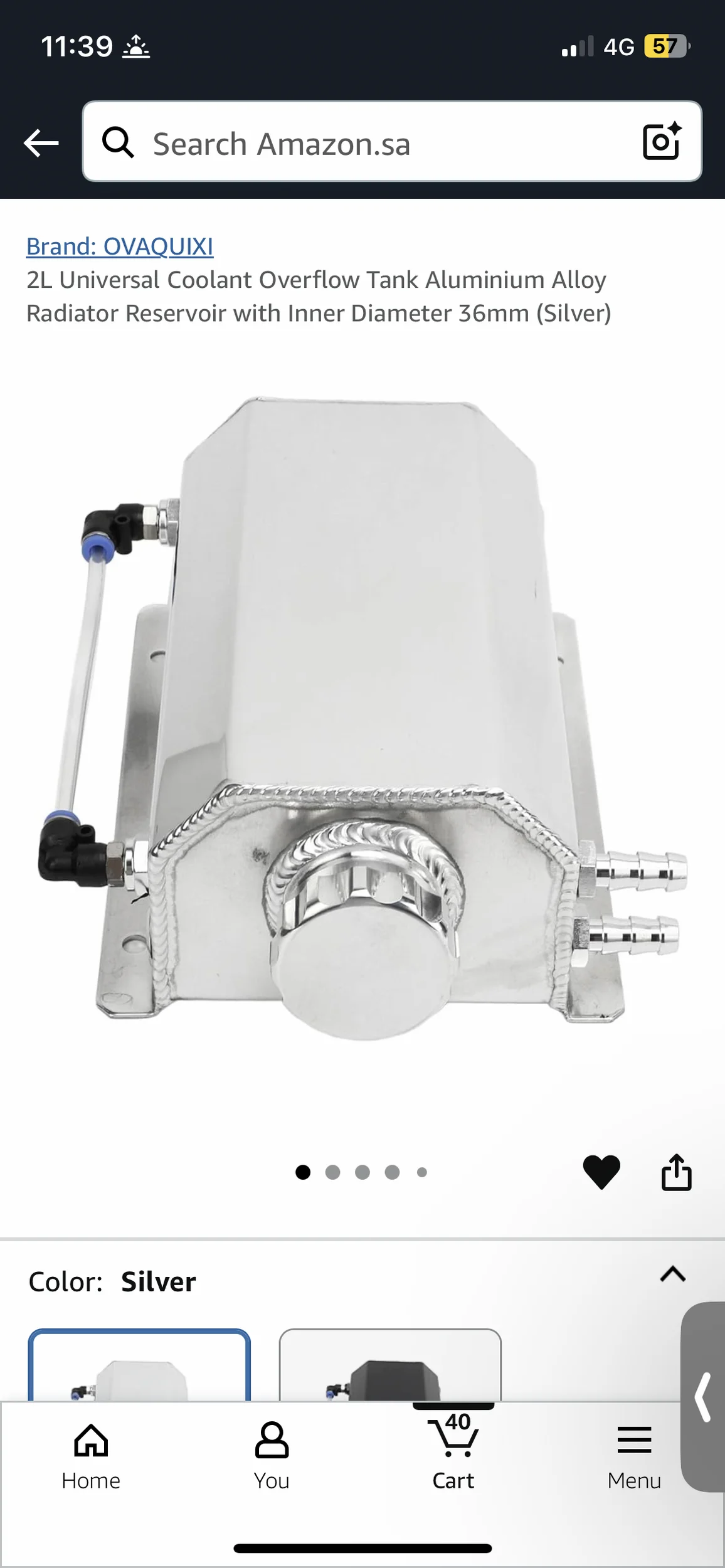

If it doesn't have a sight tube, it would be pretty useless since the level in the overflow tank is how you tell when to add coolant.
X2, it's made so you can see through it to see the coolant level without having to take the cap off. I'd hate having an aluminum overflow tank.
I run that aluminum tank, and it is a pain to have to pull the cap to check the level. And it’s likely that you won’t catch it if the level drops quickly.
The advantage for me was that I had to shorten it to fit in my setup, and I could cut it, shorten it a bit, and weld it back together. Can’t do that as easily with the plastic tank.
Put a sight tube on it.

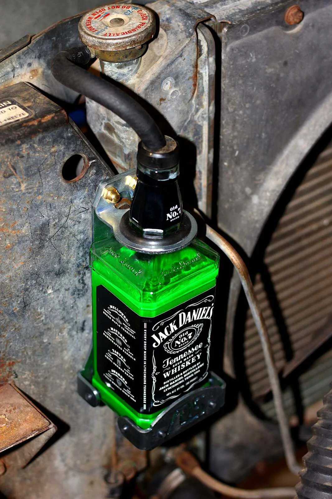

You could make your own:
