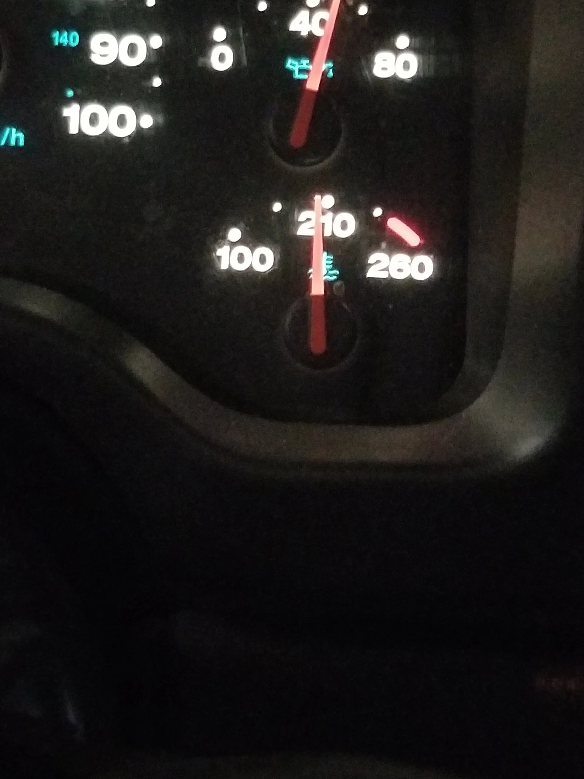

I run the same one and my temp stays just left of 210 consistently.

Bled system, and the robertshaw as advertised- back to normal!
