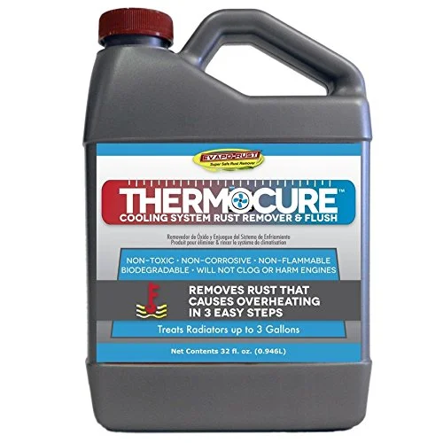

What I'm gathering is that products such as thermocure and superflush are controversial products.
I am planning to use one of these products because the cooling system has not been properly maintained. These are all original parts on the jeep. I can smell coolant when I drive, the overflow is dropping slowly, it's its a 15+ year old jeep with >100k miles so in my opinion it's probably best to replace the cooling system anyway and get the maintenance on track.
But the original question is how to quickly and efficiently flush. Can I run the cleaning/ flush product with the stat removed, cycle water through until its clean, and then reinstall parts?
If you're going to use that Thermocure product you'll just add some to the radiator, drive it around for a few hours, then drain & flush everything. I've never used it on any of my cars, but that's what the instructions say.

If you are smelling coolant when you drive have you checked the passenger floorboard for coolant? That would be a leaky heater core. My heater core leaked the day after I put thermocure in.
Yeah, I was smelling faint coolant for about 6 months, it would come & go. I finally replaced my heater core and it was leaking just enough to evaporate before it spilled onto the floor. It is a telltale sign.
