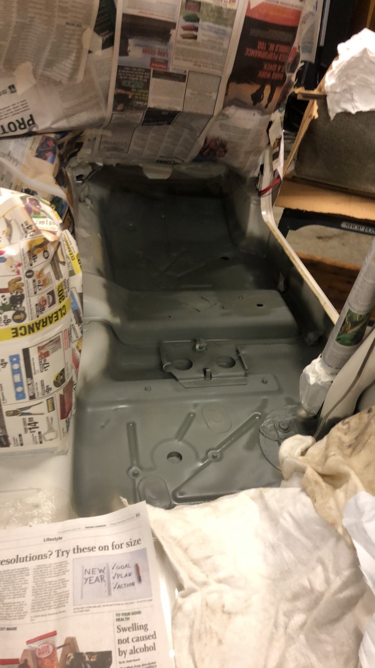

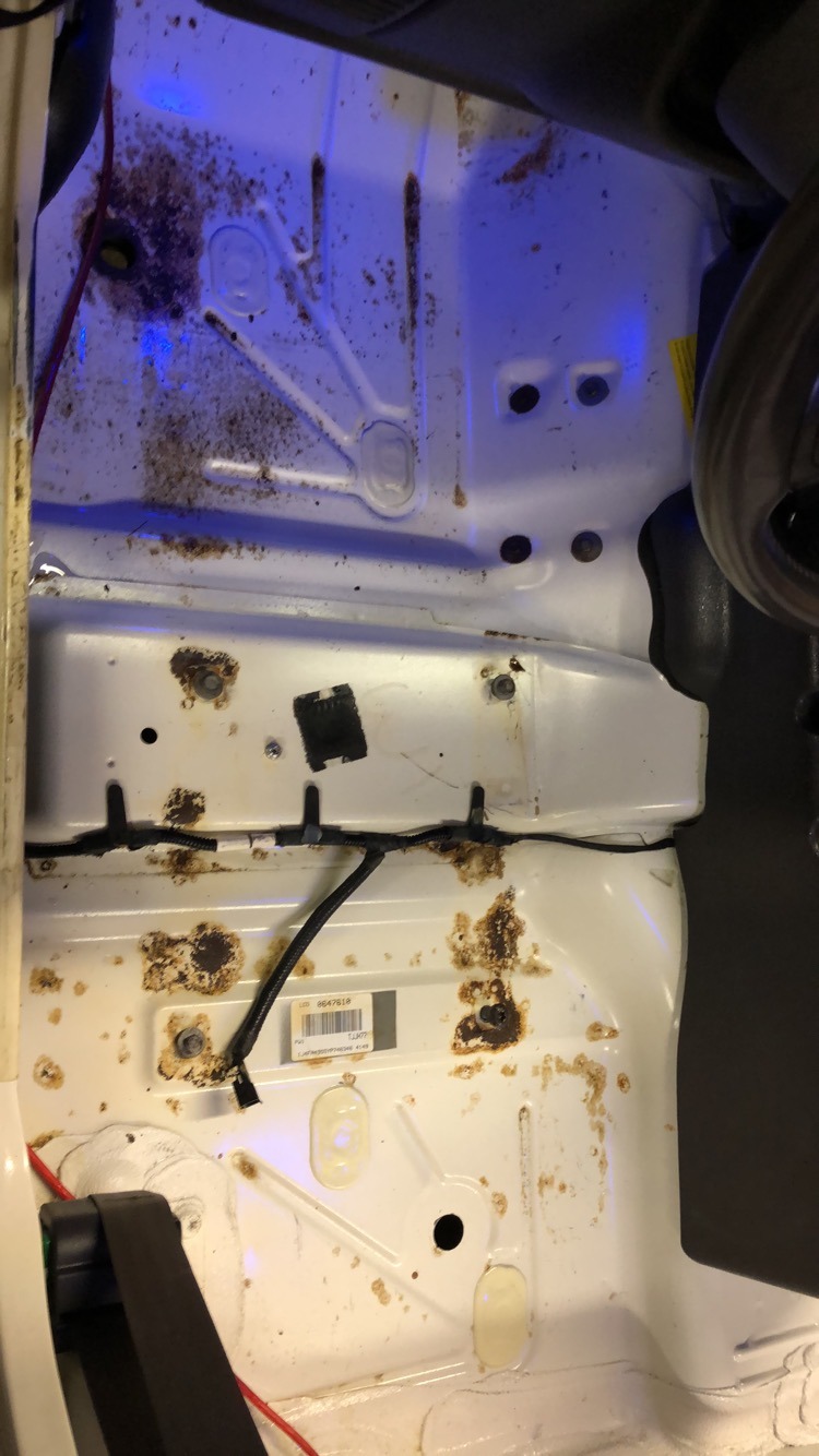

While winter has set in, I spent the last few weeks doing a major interior overhaul. My carpeting was very dirty, after vacuuming I could still pat dust out of it. So I decided to pull my carpeting and hose and scrub it with detergent. After pulling the carpeting I found my driver and passenger floor boards had serious surface rust. If I didn’t do something now this would cause future problems.

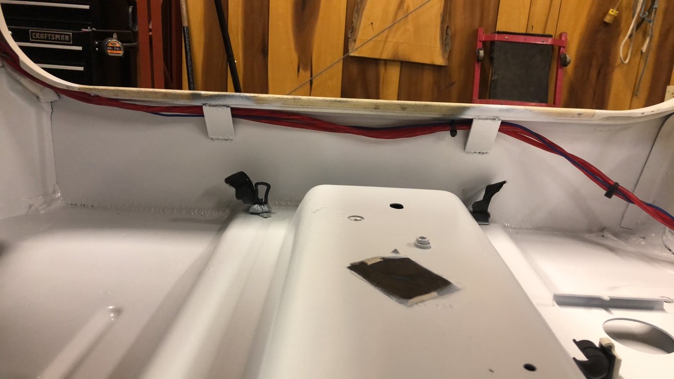

I went ahead and pulled my seats. I sanded the floorboards down with an electric sander, and used a rotary wire wheel on a die grinder in the pitted areas, especially around the drain plugs. I then washed the entire tub with detergent, let it dry for a day with a fan, and primed the footwells/seat mounts with rust oleum self etching primer. I did the same with the bottom of the seats. I then painted them with rustoleum white gloss. It wasn’t no perfect match but is covered by carpeting 100% of the time. I considered bedline but I figured paint would clean up much better being smooth and looked way more factory.

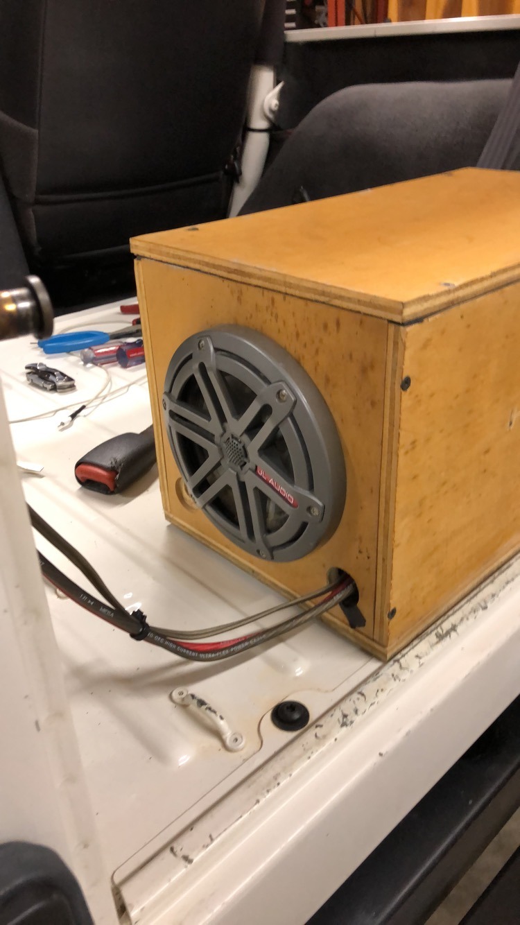

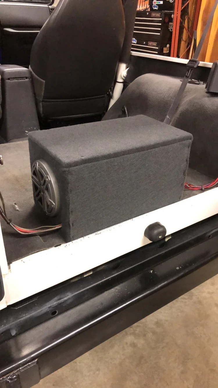

While everything was out, I decided to tidy up my speaker/amplifier wiring that runs to my custom trunk box I made a couple years back. The wires were loosely ran under the carpeting. I now routed the driver side wires alongside the factory hardtop wiring trim. For wires on the passenger side I tack welded some steel brackets up under the ledge of the tub, I left plenty of space for future wiring in the brackets.

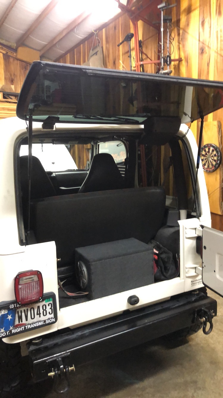

I bought 1 sq yard of grey sub box carpeting off eBay and used stainless steel staples and dressed up my box to give a more factory look.

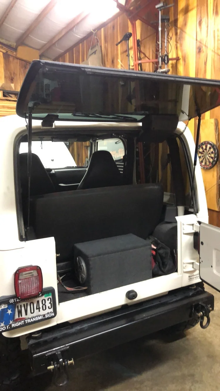

I also replaced my hardtop windshield shocks with new ones. So much nicer than holding the glass up with my head!

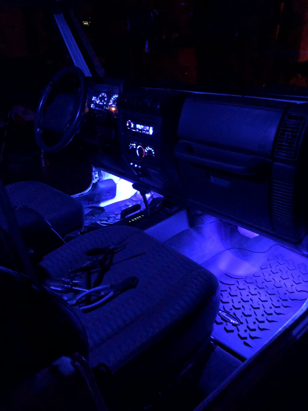

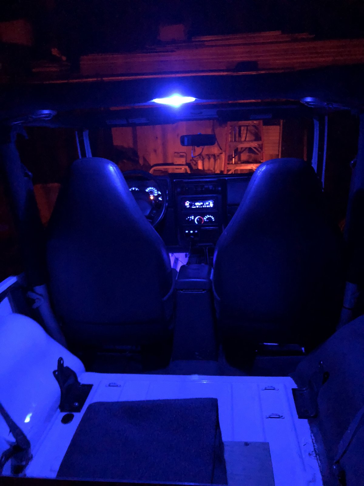

I replaced all interior lights with blue leds, they pull much less amps, don’t get hot, and are much brighter!

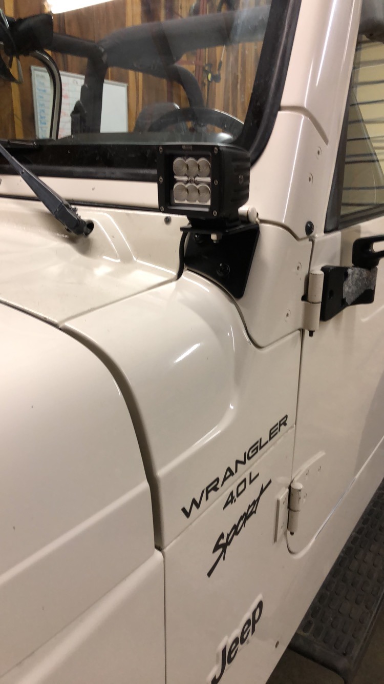

My cigarette bezel was broken, I replaced it with a new oem. I had one center dash vent broke, so I replaced both with daystar swtch vents. I bought 3” quadratec led windshield pillar cubes I wired to one switch, wired dual usb charging ports, and have two blank switches for future use:cool:. The windshield cubes are super bright btw, they are small and not noticeable which I wanted but make for great flood lights. For $150 they came with a really nice wiring harness that taps into the factory cigarette lighter power, and came with one of the daystar vent switches with the USB ports. While I was at it I bought the daystar dash tray to gain a little more storage, really like this for $20!

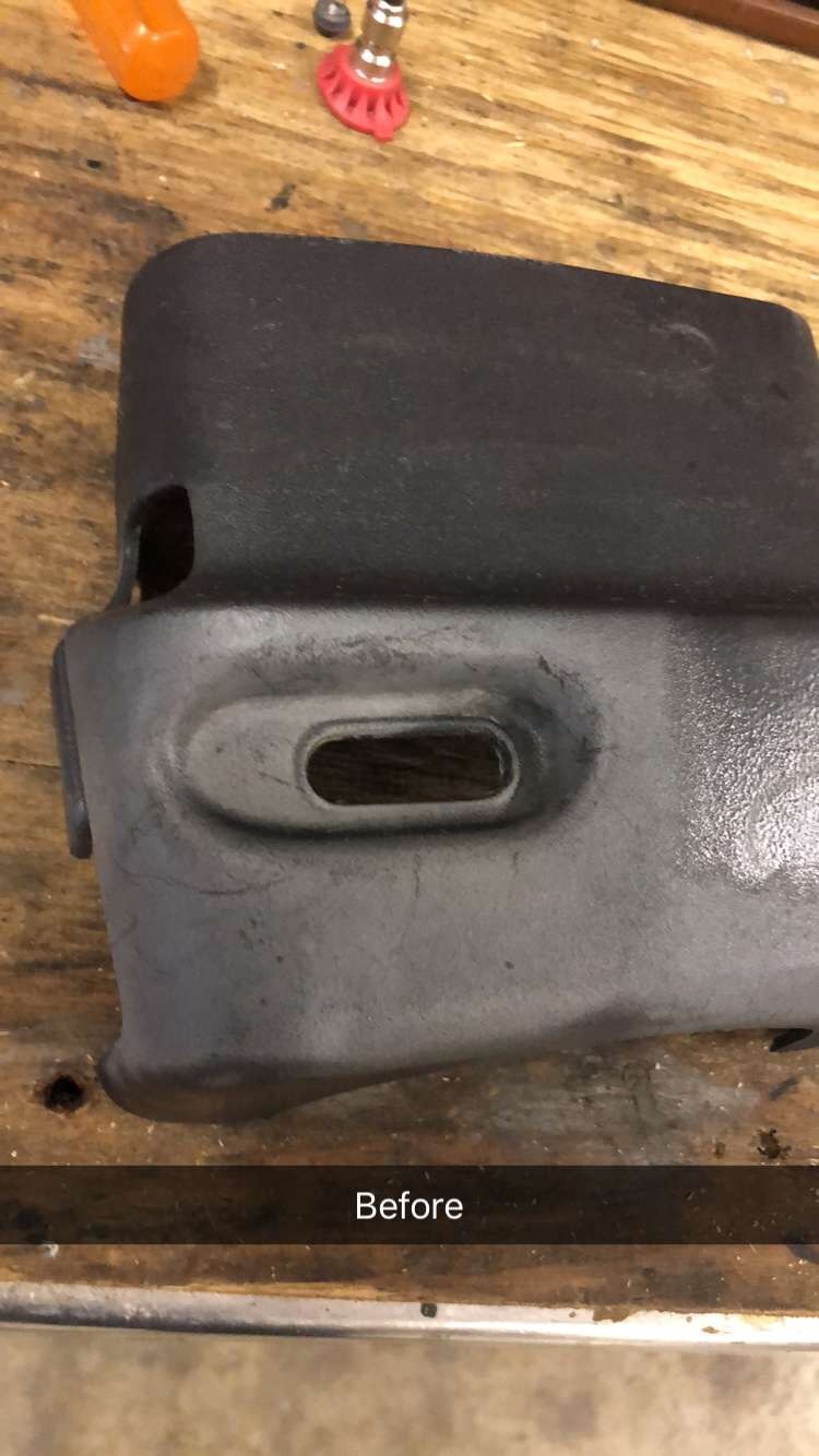

I then used tuff stuff to get all the stains out of my carpeting, then reinstalled the carpet. This product also worked great to clean my mud stained roll bar pads! I bought quadratec floor mats to keep the water off my freshly painted floorboards, I’m almost positive not having floor mats was the culprit behind the rust. Last but not least I used a small propane torch to give new life to some faded trim. Pictured below in the trim that goes around the steering column.
