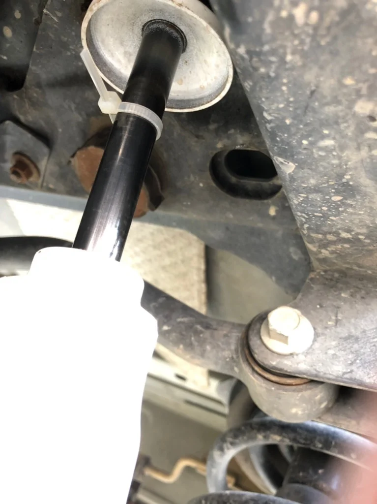

It’s been a year. Technically their warranty is over. I just didn’t notice. I will see what he says. I did the zip tie trick. The photo is where the zip tie landed from a 5 mile asphalt drive home from work last night.

Unless it’s on the shock body, it would be tough. Maybe it’s embossed on there. It seems like it has enough travel on asphalt until you stress it with a drainage ditch or railroad tracks.

The model number is stamped on the body. FWiW, I can easily use 5" of up just going to the grocery store.
You must be a more spirited driver than I am. :) I didn’t measure but that was only a few inches as a guess. I just happened to hit the drainage ditch faster than normal.

I’m getting there. It’s certainly not solidly in my head yet. But, at least I have a bit of an idea of what happens in there. Right now I know that my shocks essentially travel 3.5” and my Jeep will travel 6.25”. Something has to give.
The RS55239/RS55241's fit 2.5" lift according to Rancho, but like Jerry said, they run long in the tooth.
OK, so the gentleman returned from vacation and I had a chance to talk to him a bit. His guy measured what I had going. 3 1/2” travel in the shock and 6 1/4” travel to the bump stop. I have not measured that by removing the spring, nor have they. He said he bought shorter shock bodied shocks and got me 5” of travel. He also stated that we can’t give in one area without losing in the other. Because there is only so much shock length. So, as I understand he has gained me 1 1/2” towards the bump stop but that is going to cost me in the tire off the ground droop. Mind you, I don’t wheel hard so tire off the ground isn’t as important as my upward travel when I hit something. There must be a way folks deal with this. He already has the shocks in hand and although the original install was a year ago he still is willing to work with me on costs.
The appropriate shock length will split it's overall travel roughly in half.
Roughly. Are you closer to that being the case?
