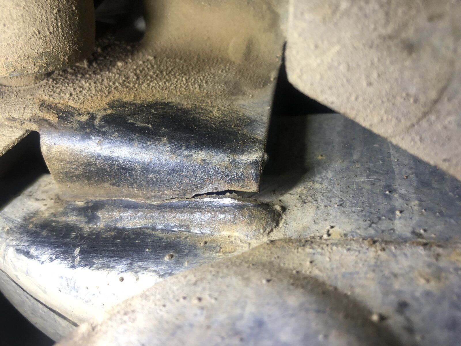

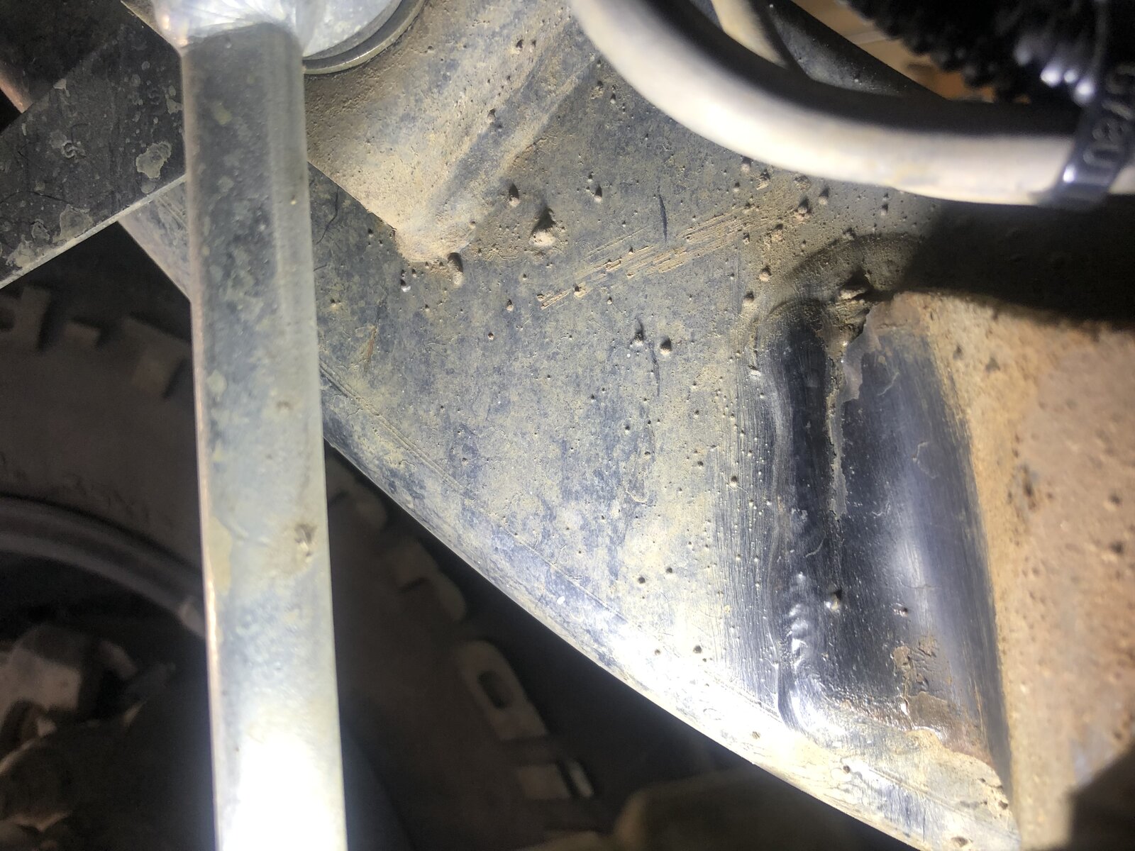

So crawling under the TJ tho afternoon looking for a mysterious rattle (I think was a lose fuel line) I noticed some cracks in my rear upper control arm to frame brackets. Question is do I just clean them up an run a weld over them or do I need to reinforce an box them. Open to input.

Weld them up. You are likely dealing with end result of too stiff bushings in some previous arms and set to length by dimension rather than floated the correct length.
Reactions: Jerry Bransford
That was my thoughts. The savvy arms have more than enough float and should not have caused this. This is the fourth set of arms I have had over the time I have had the Jeep. One of the configurations must have put too much stress on the brackets.
