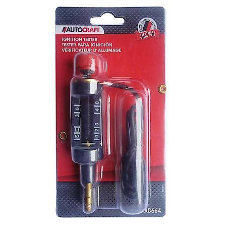

Get some carb spray or ether (staring fluid), and spray it in the air cleaner. If it starts, you have a fuel problem. If it doesn't most likely a spark problem. I have a cool tool that is cheap for checking spark. It looks like a spark plug with no electrode. It has a clamp so you unplug your spark plug; put the boot on to this tool then clip it to a ground somewhere, and crank the motor, you will see spark shoot to ground if you have spark.
It will not start on starting fluid. I also picked up one of those spark testers and when I adjust the gap to where it tells me for electronic ignition, I get a consistent, but dark orange spark. Should it be bright blue or white at that gap?
It also has different gap settings to check increasing voltages. I can do that, but not sure what the voltage is supposed to be. I have a new coil coming today anyway so probably not much point in checking right now.

Your spark should a bright white/bluish color. I'd suspect a weak coil, high resistance in the cables or a poor ground from whatever you clipped the spark tester to. The manual calls for a .035 gap, is that what you had it set to?
The spark plugs are set to .035.
The tester is this one from advance auto:
the package instructions say to check for spark with the gap set at the "E" for electronic ignition, and the 2, 3, and 4 markings are for 20k, 30k, and 40k volts, respectively.
I didn't measure what the specific gap is at the E, but I can. It's quite a bit larger than a typical spark plug gap, though.
