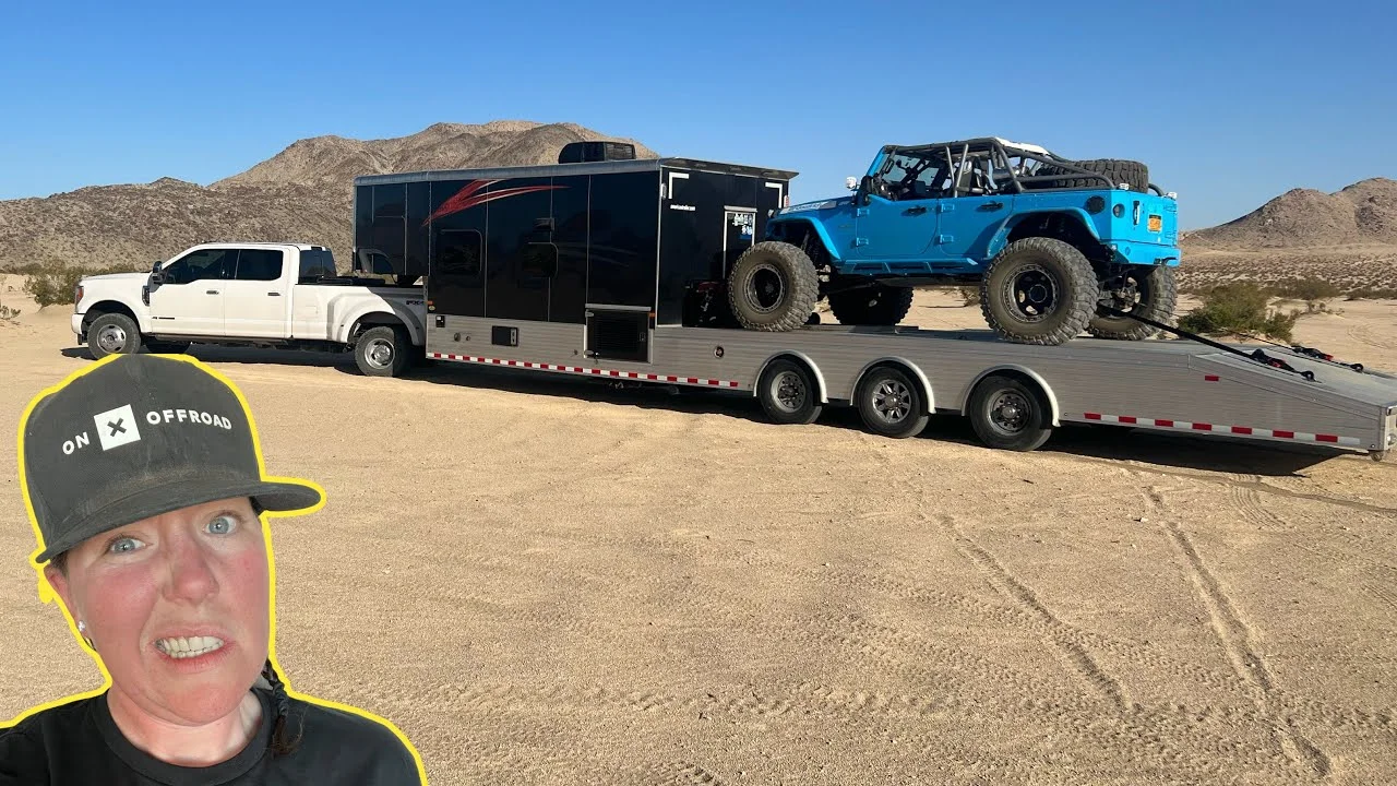

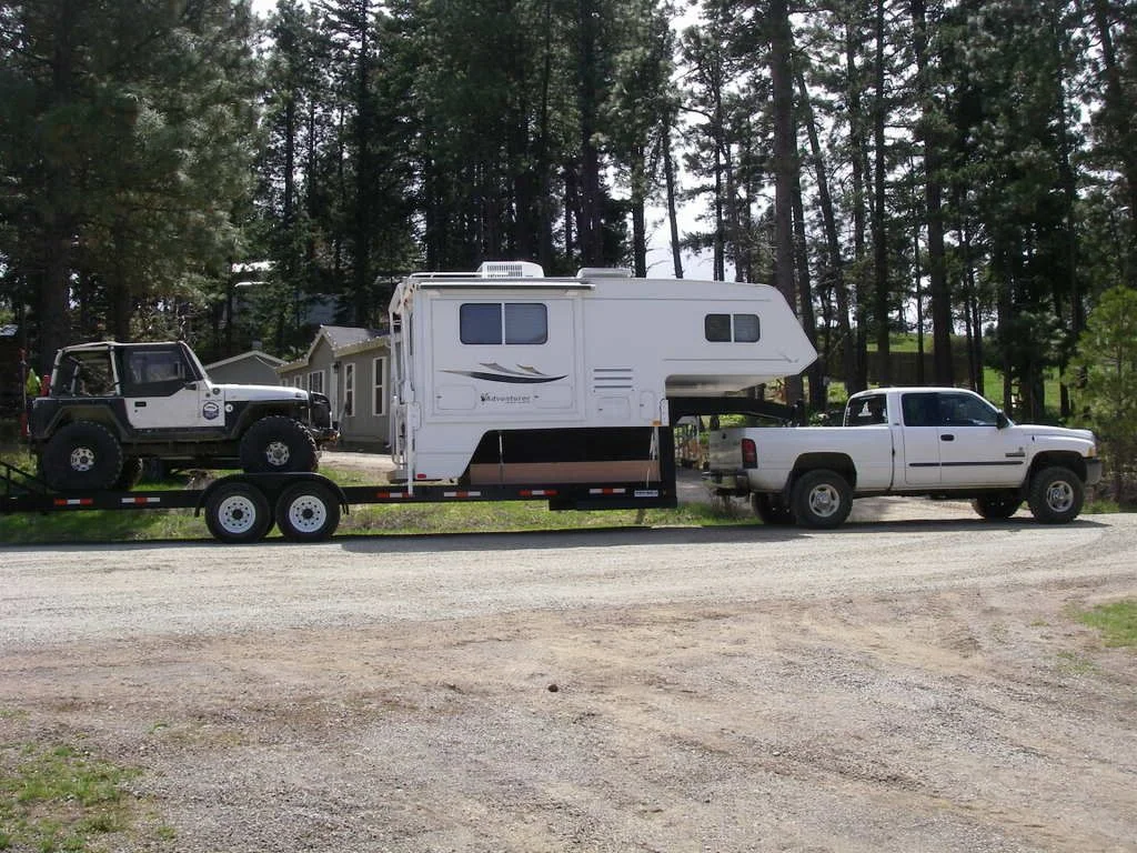

I called mine a Redneck Toyhauler but now the term seems to be Crawler Hauler. This one was made by Dunes Sport in AZ. They also build ADA accessible trailers which was how I'd first found out about them.

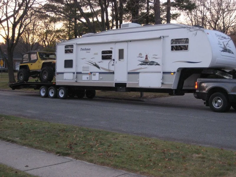

What do you figure the tongue weight is without a rig on the back to balance it out? Or does the triple axle take care of that?
I was thinking about this the other day and was thinking about some way to put the axles leaf spring mounts on some sort of worm gear trolley system so I could move the axles forward or backward to allow for hauling with or without the crawler...but maybe it's not necessary. I don't think I've ever towed anything heavier than 5,000lbs total.
@toximus may have an idea of the weights.
I never weighed mine without the Jeep on it so I can't tell you how much it changed the pin weight but it towed just fine with 2 quads on back instead of the Jeep.
I don't know why you couldn't have the trailer axles slide like they do on a 53' semi trailer if it was that big of an issue.

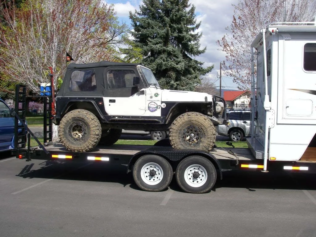

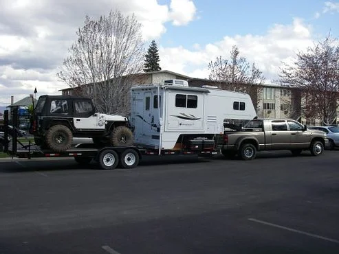

When I built mine I had a shortbed truck and wanted a larger camper. Extreme 4x4 was building their crawler hauler using a tent trailer which gave me the idea.
I towed it to Moab & back to WA with my 3/4 ton Ram and then traded up to a 1 ton dually Ram but still a Mega cab with short bed. For what I was doing then i LOVED the setup. The only reason I went with the motorhome this time was I plan on being on the road for longer periods of time. So the added room for comfort seemed like a better idea.

1. Doesn’t like black color, too hot
2. Lack of storage
3. The mattress, Walter is 6’10” tall neither is small
4. Wants a visual gauge for fresh water level
5. Two TV’s with same remote
6. Lack of outlets
7. Needs more living space
8. Smell the black tank in hot climates

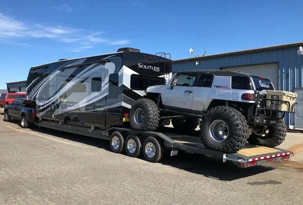

Keep the axles at the back. It makes a huge difference in how stable it tows. Having had no experience towing anything large, I started off using an RV GPS which warned me every time a sharp turn was coming up, I literally got annoyed by it dinging every time and turned that option off since I either had time to react or didn't had to react at all. Yeah, I can tell there's weight behind the truck when accelerating, but driving was so surprisingly effortless that you have to remind yourself that it's back there so you don't clip a turn. Which brings me to the downside of placing the axles at the rear: the turns are very wide and you will be driving into other lanes to get it around turns and taking roundabouts very wide. But it's all doable and I got the hang of it even in traffic after a day or two. My passenger's can't tell it's back there.
I haven't been able to place my Jeep in the back yet, but from what I've heard from other people, it reduces pin weight by 50lbs or so. Obviously, this will vary based on your trailer and your load.
Plan on 30% pin weight for gooseneck.

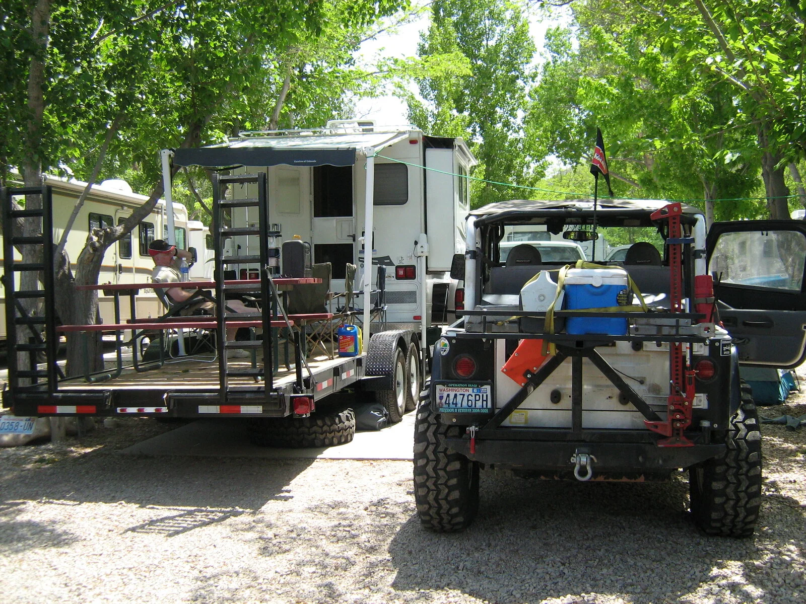

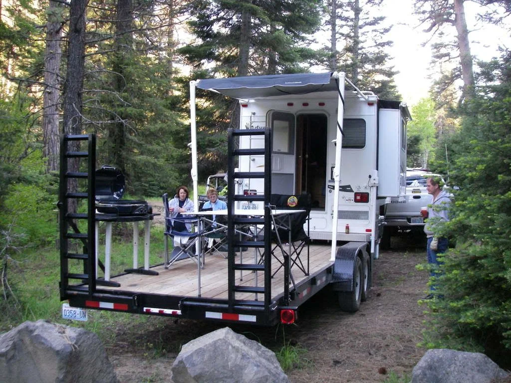

I had a 8'x16' pop up that I could setup over the back of my trailer for working on it. I never got any pictures with that setup. But having 17' of deck out the back door was nice.
Kept you up out of the dirt & dust.
