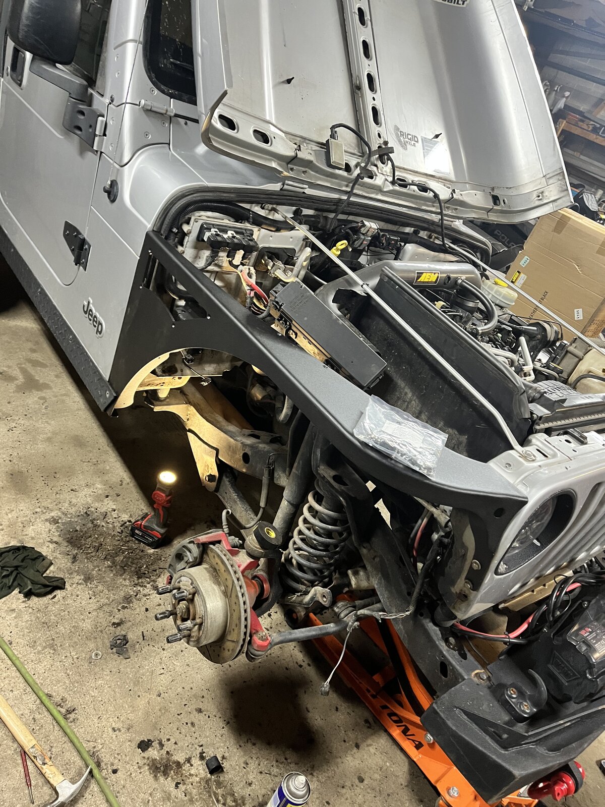

Alright so I got my old fenders removed and mocked up the new fenders. Seem to line up nice. Just not 100% sure of which new bolts/nuts to use where and which original bolt/nuts to reuse. Also what’s everyone doing for a battery hold down with the new tray?
Factory bolts for the lower 2, they have a quickset nut for the top one in the grille. Factory bolts to the body too. Everything else is their little button heads, but I had to get longer bolts for many spots.
I welded a battery box base to their tray and added a tie down strap with all thread and wing nuts and had to cut off the bottom of the fender for mini boat sides.
