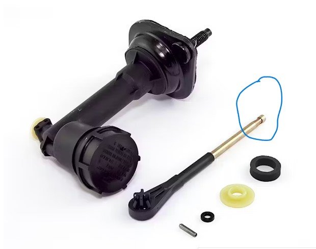

It might be the ball and socket where the clutch rod sits in the piston. It sort of snaps in there. You may be able to squirt something in there with a straw just to see if that's it, and if so you'll have to pull the rod out and put a little grease in there. My old one used to creak but it was failing anyway so I replaced it with a Mopar unit and it's completely quiet now
.View attachment 582862
That's precisely what I was thinking. I have to take it apart to replace the CSS anyway, so I'll give it a shot of white lithium grease.
