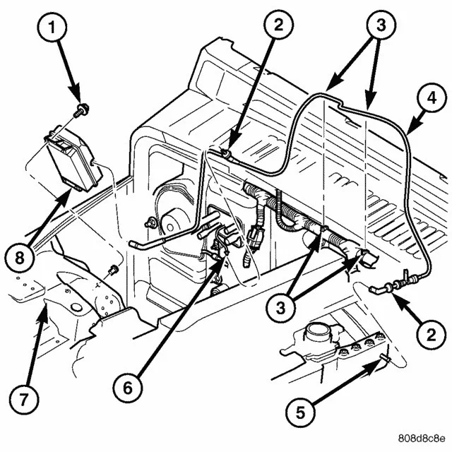

check for vacuum leaks it might be not too bad but just bad enough to cause your cruise to not work
How do I systematically check the vacuum system?
Start with a visual inspection i believe the most common spots are near the 2 and 8 check for cracks in the lines as they are plastic and dont really age well if you dont find anything with a visual inspection id move onto a fogger tomcheck for vacuum leaks id refer to chris with questions about how to do that
Vacuum testers are cheap and would make checking things easier for you. When i did the cruise on my 98 one of the issues I ran into was the used vacuum module I bought from a wrecking yard was no good. It had the same symptoms as you described. Turns out the diaphram had cracked. In addition if the cruise is a addon that a po was putting in and gave up on, the wrong year switches will cause the same issue. They look the same but you do need the correct year.
A smoke test is a great way to check for vacuum leaks you would otherwise not be able to find, as many are invisible to the naked eye.
