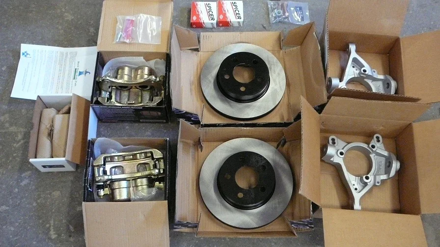

IIRC, there are 2 black magic "kits" 1 is standard centric rotors and new pads for the standard calipers. The second is their big brake kit, which is a knuckle swap, dual piston calipers with appropriate brackets, pads, and rotors.
Four different set-ups from rotors and pads through 15", 16" and 17" BBK's. Nice kit.
Edited to add: My bad. Five kits. Blaine has a Super16" kit as well.

Blaine's BBK is a very well thought out kit. The instructions are spot on, and the kit is worth the coin. His standard pad/rotor upgrade is a definite improvement as well, whatever your budget may be.
